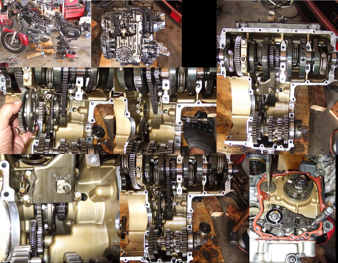

OK, flywheel does have to come off.... Included metric bolts for attachment...
Starter clutch already swapped out... Old one spins both ways by hand... DOH!
Tranny gears, bearings, clutch components, oil pump components etc... all look good.
Cleaning grime off cases/pan while putting her back together... Images to follow etc....

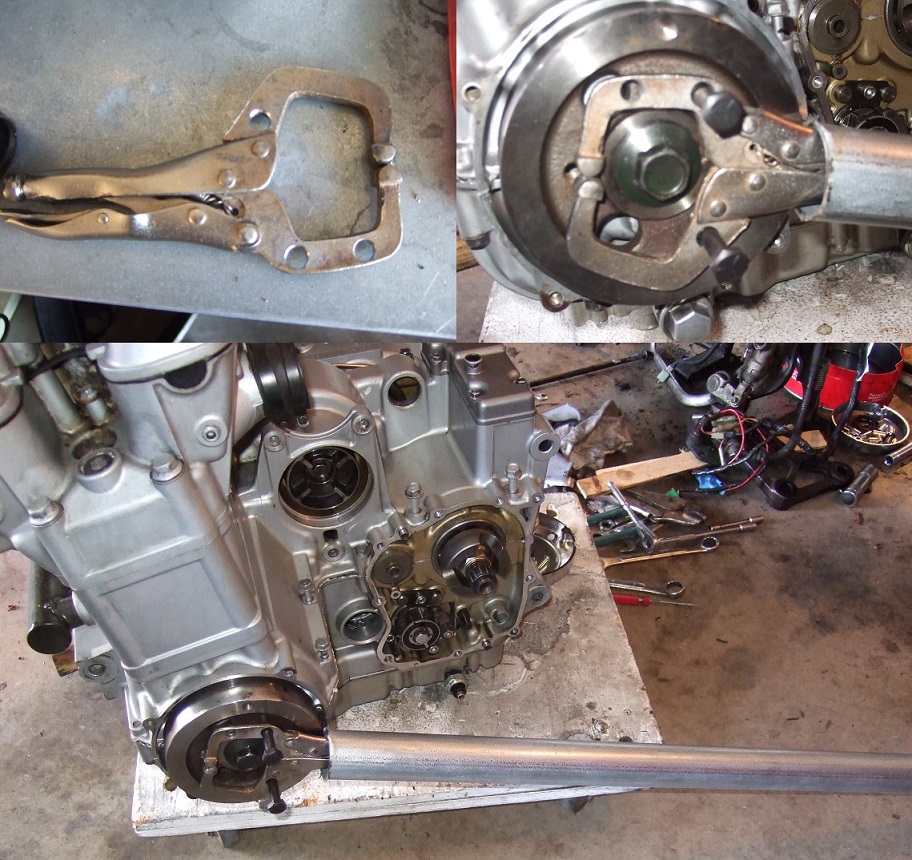

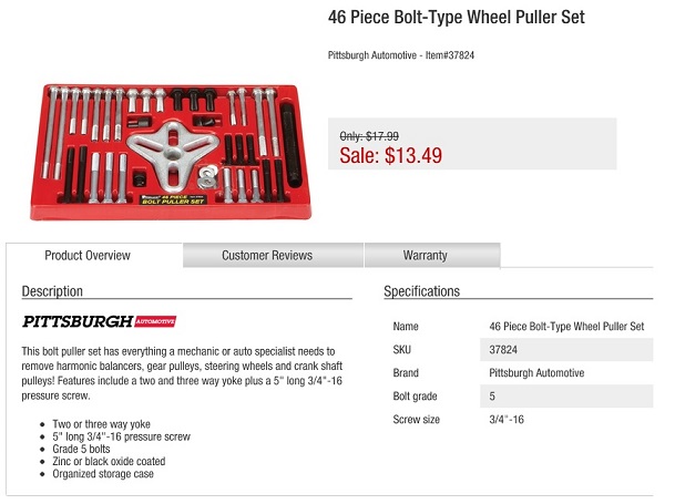

For those that may need.... $14 tool to get the flywheel off, worked like a charm!

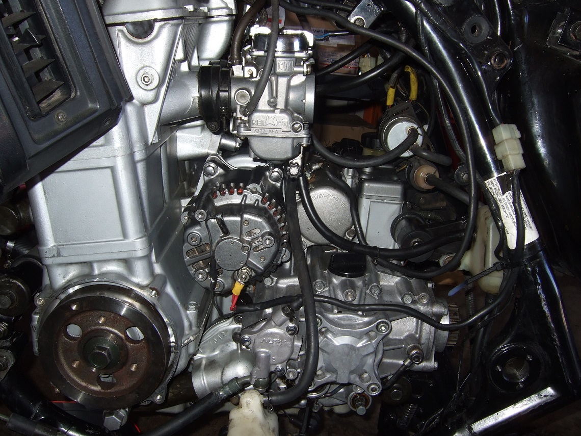

Made some progress, almost there....
Starter Clutch replaced, yup old one is toasted...
Engine Cleaned...
Hate Working on oily/greasy/grimed crap....

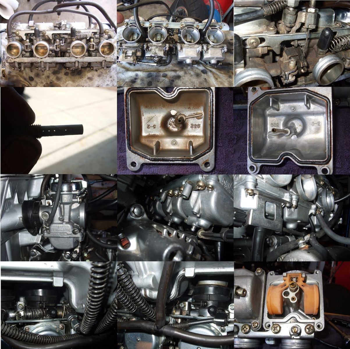

Carbs cleaned inside & out...

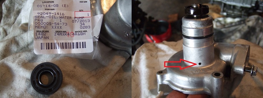

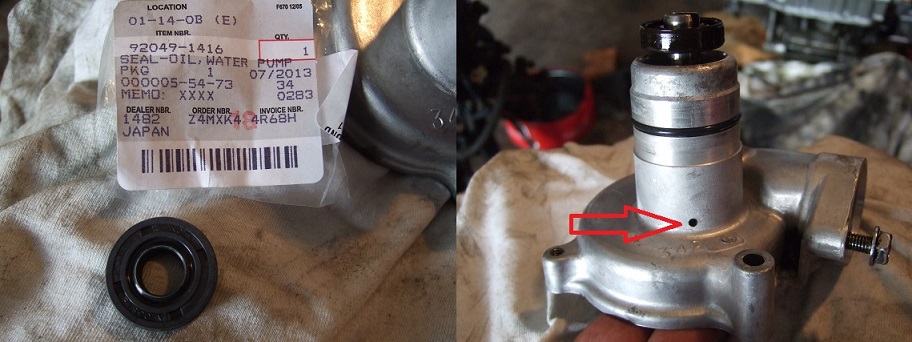

Water Pump Oil Seal.... Seep hole is where she leaked pass seal...
DIY Flywheel holder for 110 ft/lbs torque....
Engine Cleaned...
