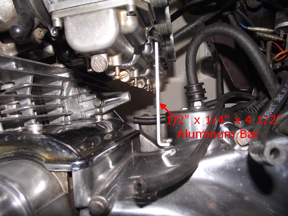

Hi Tom, how's the bike been running with the current jetting (20 pilots and 122.5 mains)? I have the same exact bike, but with a Kerker 4 to 1 and pods. Been running 20 pilots and 118 mains for the last year or so. I had different results with anything larger than 118's. Here is what happened. Three weeks ago after a ride I forgot to turn off the petcock and I noticed one of my carbs was shooting fuel out the overflow. So I decided to take them apart to clean lap the valve seats and valve needles. While I had the rack off, I figured I would readjust the floats. I have always felt I had them set to high and was getting oil/fuel mix below the carbs. Not much but after a ride I would see it. Figured that level was marginally too high while bike is running. But the mistake I made was besides changing the float level and then changing the 118 mains to 120's at the same time. Bad mistake, always make one change at a time as you noted. I did this cause I had some popping on decel since the weather turned hot. I did a very small test and wasn't too happy but had 75 mile ride to Orlando planned and had to leave it that way. The day of the trip I started off knowing it wasn't perfect. Fist time I hit a road with a 60 mph limit the bike would surge back and not cruise consistent. Not too bad but noticeable. Worse part is if I tried cracking the throttle at top gear, there was not response. Top end was gone. Would take for ever to reach 70 or higher. But made the 150 mi round trip without incident other than running badly. So finally got to get at it this last couple days. Took the rack off and reset my floats and went back to 118's. Fount all four plugs fowled. I do believe some of the floats were so low that the fuel wasn't keeping up. Acceleration wasn't horrible (sitting from start the fuel would have time fill the bowls before accelerating). Anyhow, setting the floats and going back to the 118's did the trick. Good acceleration going through the gears and even cracking the throttle in top gear on the highway. Checked one of the plugs after the ride (had replaced the fouled plug with an old set I had laying around) and it is black as usual; black base ring and tanish strap and porcelain look OK. I'm at 1 1/2 on the air mixtures. I am going to throw some new plugs in there and set the mixture at 2 turns out to see if the base ring lightens up shade. But good power. These KZ900 run a little rich. But I may even try going back to 115's on the mains. That is what it had before changing the 4-2 Mac's to the Kerker 4-1's. Interested how yours is doing? I will keep you posted if I make any further changes.
Oh, And I finally got around to fabricating a crude carburetor brace.

Here is some insight of where mine is at right now. After making sure that my float levels were spot on (I used a level to make sure the carburetors were level in both axis. Because I noticed the leaned forward on my home made carb rack which would give me a false reading on my floats). Then I went back to 118's from the 122's on the mains and stayed at 20's on the pilots with 1 1/2 turn on the air mixtures. The bike runs very strong in all ranges. I did WOT with the first couple of gears and the rpm's climbed right up there with good acceleration. From top gear at 60, I can crack the throttle a bit and can get up to 75 or 80 mph or more with no hesitation and it pulls well. So that is all very good. All the problems I had before are gone. Performance is very good. Now for the bad, I get popping sometimes on deceleration. But very infrequent. At idle, I can hear a slight rumbling. I could go a little richer on the air mixture and it may take care of it. But I suspect that if I go up one more size to 22's on the pilots it will take care off the popping and allow me to go leaner with the air mixture screws. But I'm in now rush to try. The bike is a blast to ride the way it is right now. If you are fowling plugs, I would say you are still to rich on the mains. And the fact that you said you are getting some surging at when at a constant highway speed that is an indicator that your mains are too rich. Why not try the 118's?
