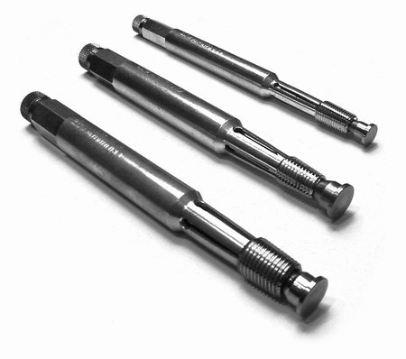

If plug hole threads are imperfect after the extraction, but may contain sufficient material to be re-tapped, it's of course critical to get the tap correctly started.
Sometimes a reverse tap (aka back tap) tool provides a solution by beginning the tap at the deep end of the plug hole where the threads may be in better condition.

I tried heat with a propane torch, but I don't really have anything at the moment to get a good grip with. All good suggestions that I will try. I'm sure this plug hole will need to be cleaned up whether with a front or back tap once I get it out.
I'm just really glad the piston wasn't frozen ... hopefully that means there wasn't a ton of corrosion. I was really scared after having to pound the pistons free in the 750 motor.
