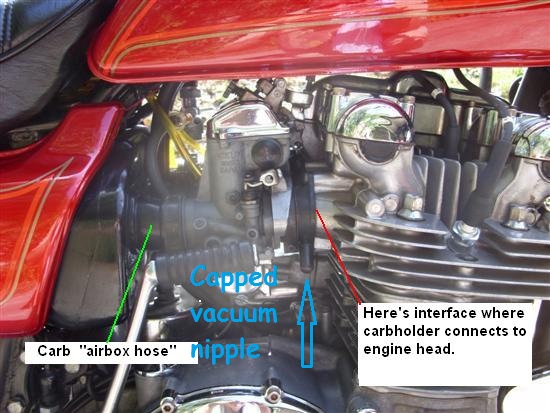

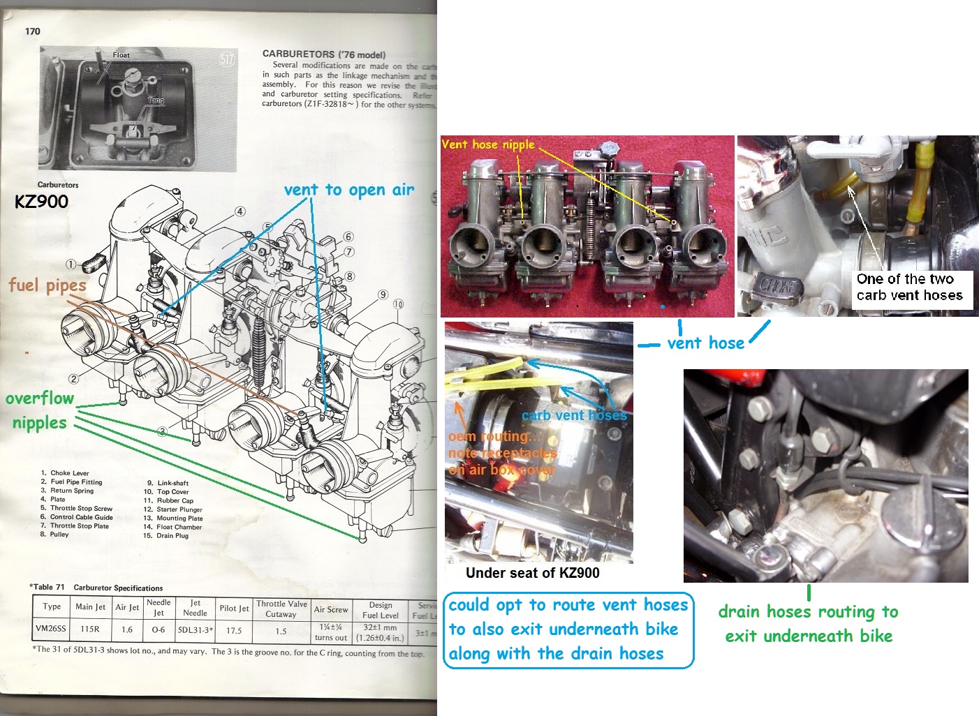

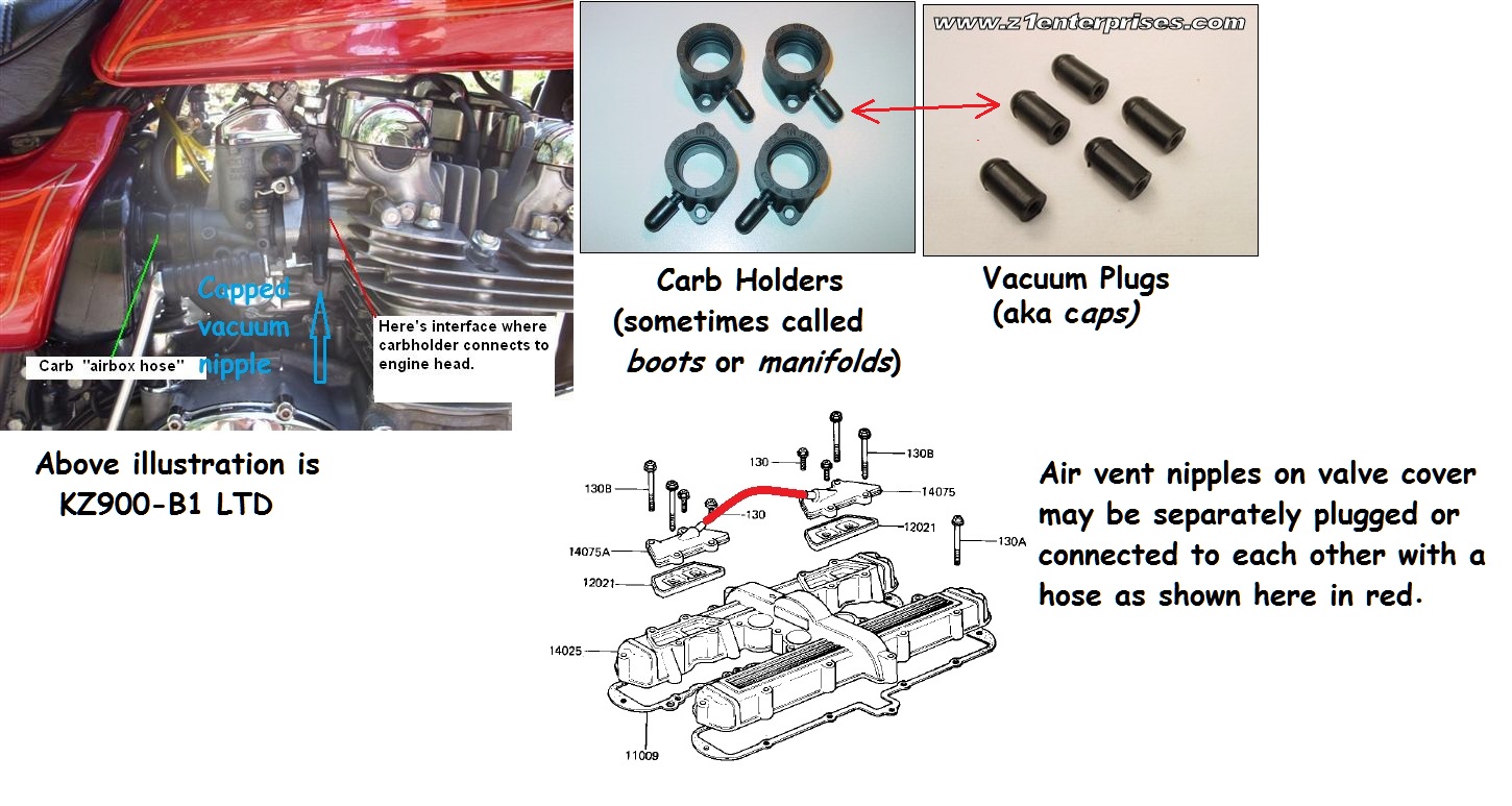

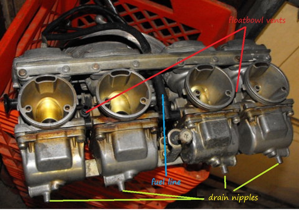

Being uncertain as to which style carb is fitted on the bike at hand, here are some examples on both manual slide carb and CV carb.
Some carbs have an additional vacuum nipple dedicated to a vacuum operated petcock.
Where such additional vacuum nipple unused, it must also be capped/plugged.
