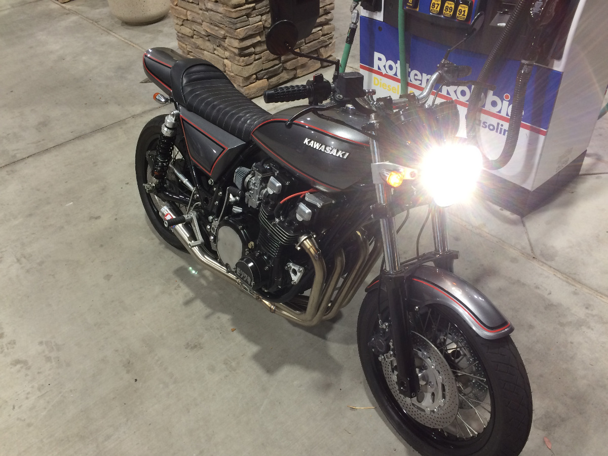

Went for the first ride tonight. First impressions are; HOLY MOTHER OF TORQUE! this thing rips! I did a couple pulls up to 7k and it gets going quick! I haven't even had a chance to mess with the carbs yet. I have to say its running remarkably well for literally doing nothing to the carbs from the factory. last couple things to deal with are; I need to sync the carbs and the cam end plugs are leaking, which hopefully I will have time to address tomorrow. last time I rode it was in December of 2010.

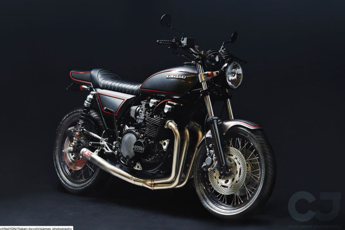

magazine quality build!
you built an awesome one of a kind bike man,and added to your skillset.

Looks fantastic. I really like the colours you went with,very subtle. You'll definately be getting a lot of double takes.Nice job.

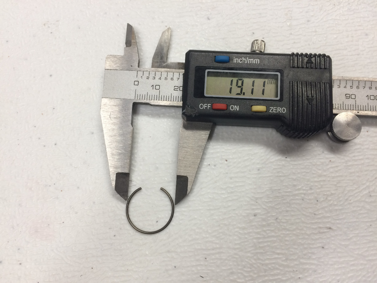

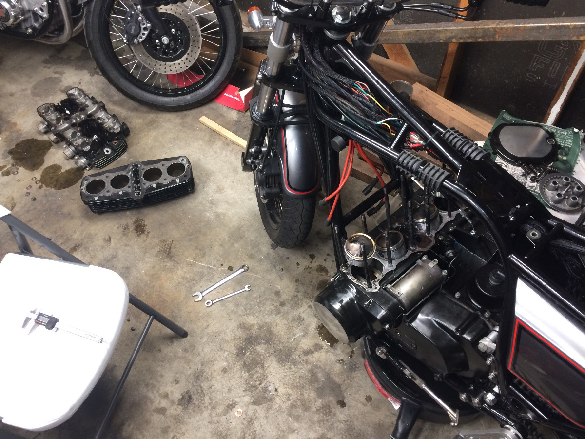

I pulled off the clutch cover to remove some plates and this circlip falls out. Feck. This is my worst nightmare, so much so that after reading a post about the need to orientate the piston pin circlip openings I tore apart the top end of my motor to check. The circlips I couldn't move to the correct position I replaced. Fearing the worst after finding that clip I tore the top end off the motor to find out that I'm an idiot. All the pistons have their circlips installed still. My only thought is I accidentally dropped one of the old circlips in the motor and when I was replacing them out of paranoia and didn't realize it. Now that has come back to bite me in the ass. The good news is there is no damage and the motor looks like its breaking in very nicely. Once i have a new base gasket and head gasket this thing will be back together in a couple of hours, I have gotten real good at tearing this shit down and putting it back together again. 5th times a charm. D'OH!
