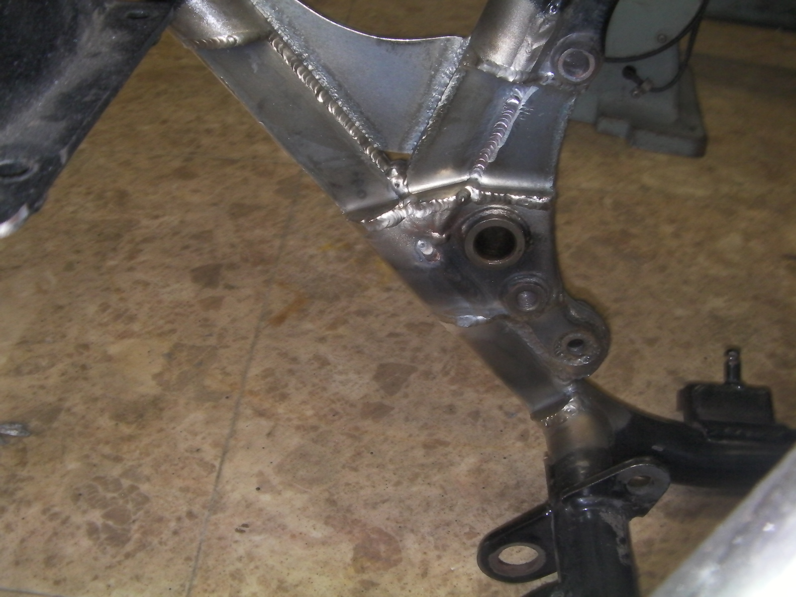

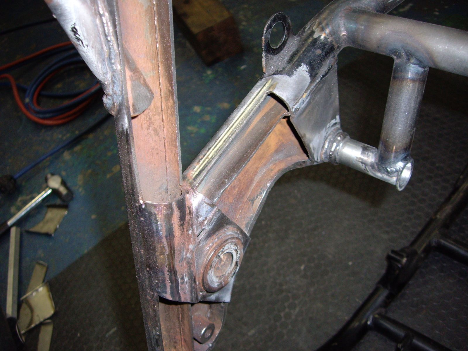

So you wont be needing these then I guess?
Hey I like how you did your mono shock and where able to keep the stock electronics.

the 5/8's offset is going to cause your chain to rub the frame(probably).
so you have a few options of re-gaining some clearance.
either heat it and use c-clamps to squash the inside of the tube or do like the sanctaury guy's do and cut it out and weld notches back into the frame.
