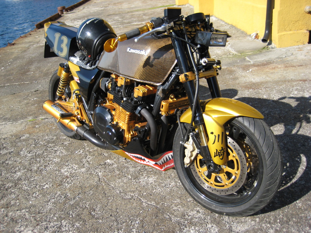

i have done some busa to kz stem swaps to make the front end fit your bike.
here is one that i did for kzr member roynor in norway.
and rslingshot gave us an awesome tutorial about using busa swingarms and extending them as well as under-bracing them.
you may also look at ramtoughs thread to see how i modded a zx636 swingarm to fit his kz.those swingarms go for pretty cheap on ebay and are a nice fit also.
pm me if you need some info/help.

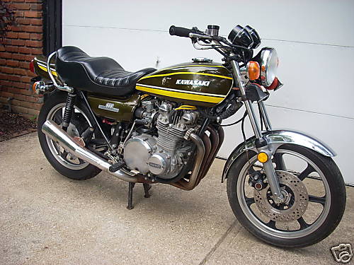

531blackbanshee: Is it a whole lot to do or mostly to lathe a stearing steam to correct dimensions? I might need some pointer to be able to pul that of, i've started a lath/milling/CNC coruse and I might be able to do it in the manual lathe machine, but it depends on the level of work needed, I've just attended for 3 weeks and isn't to far into it yet.
My plan is to use the original front fender, so I'll fabricate some kind of support for that, and i might need something to protect the fork inner tubes after the original fender is gone, was thinking of mine fork boots
I'll see how cheap I can get the parts and take a desicion wether or not to get it after that.

remove the stem from the kz lower triple,install it into the busa lower triple.machine and install a bushing into the busa upper triple and install new kz steering bearings and bolt on.
shoot me a pm if you have any other questions about the swap.
