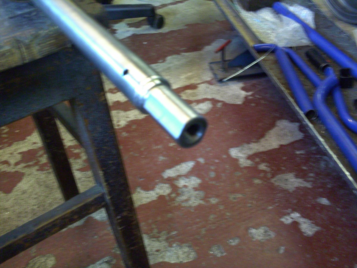

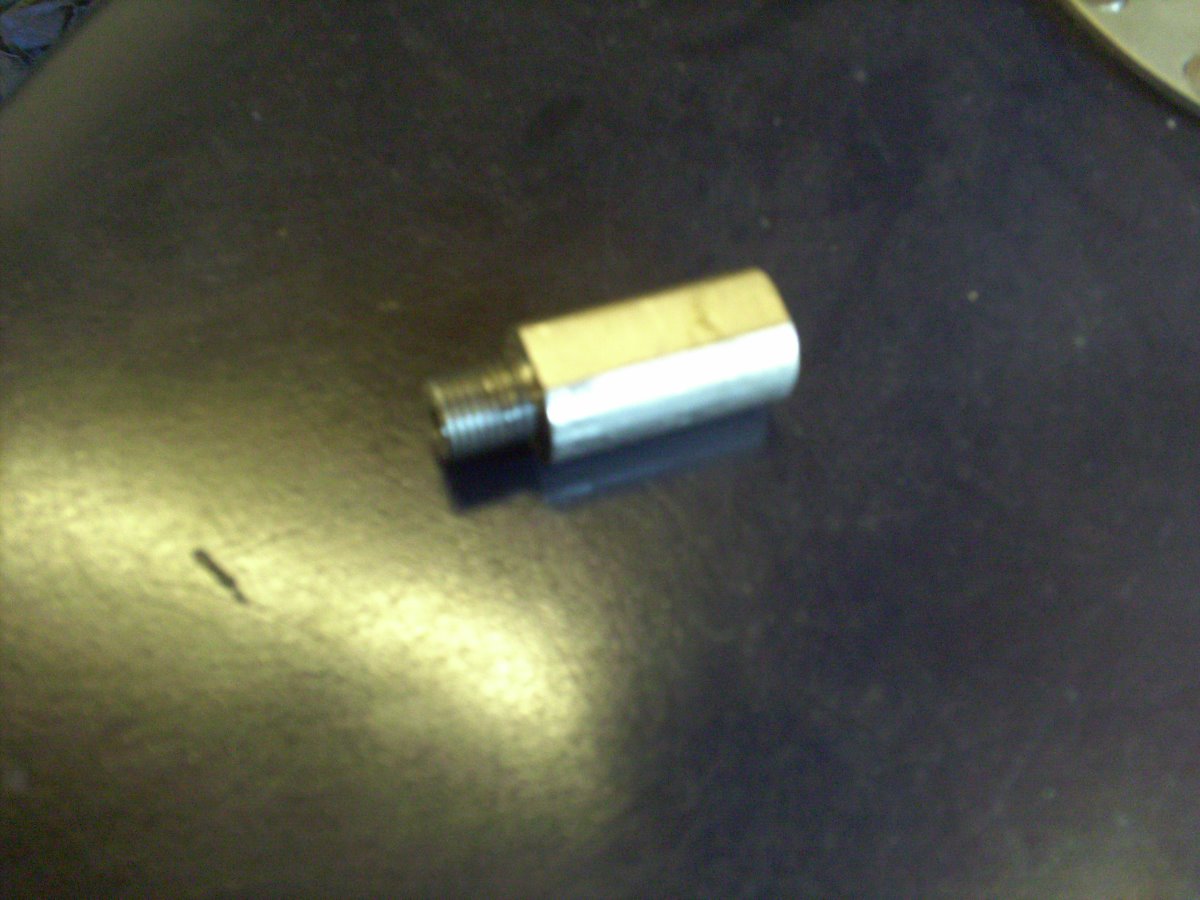

DoctoRot wrote: Hey Zed, I was going back in this thread to see how you extended the zx10 forks, but it looks like you deleted your photo bucket account. I seem to remember you keep threads on other forums, are there photos there? thanks.
Hi. All the Photobucket photos were blocked and they want £400 a year to enable third party hosting..
Essentially it's a ransom.
I recently managed to individually download all 2000 photos from Photobucket on to my PC and replace all the pics on the Z1owners club GB site project threads with permanent attachments.
Not a quick or easy job that took weeks to complete.
There is an free App that allows blocked Photobucket pics to be seen but it only works with Google Chrome or Firefox -
chrome.google.com/webstore/detail/photob...ihbemealioapbifiaedg
How much do you need to extend the forks by ? as it only possible to get 30mm to 35mm by extending the damper assembly depending on how much unused stanction there is above the bush..
The easiest way is an extension with a female thread at one end and male thread at the other that simply screws on the bottom of the damper rod and then refit the allen bolt in the bottom of the fork leg..
Like this .....

thanks for posting the pic and the refresher.
