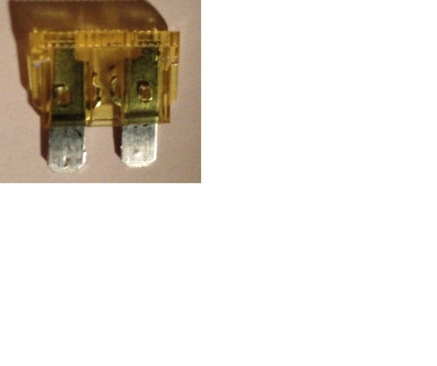

i have seen what i feel must have been a loose connection(the female fuse holder around the fuse leg), burn the leg off the fuse.

03 Jun 2014 06:39tk11b40 wrote: Mark !!
Thank you thank you. The 20 amp ting will make me sleep better. the fuse blew after the first hard pull on the throttle, so if it supposed to be twenty amps, there may have just been a little too much juice for the 15 amp.
I was just dam happy to ride it after all this time. So I put it away. The odd thing is the fuse took some time to burn, the bike sputtered twice then quit. Like a real slow burn through.
i would imagine the element was just melting and slowly burnt, kind of like a light bulb that flickers before burning out??
I am sooo glad you are still around. You have a wealth of knowledge.

I have one hot lead that may have been contacting bare metal on acceleration. The headlight is on its way, then the taillight, a horn and signals. At that time I will be trying to locate the short, unless of course connecting all the hot leads removes the problem.

The short was due to the ignition switch bouncing around. I mounted the switch and got to hit it pretty hard a few times today..
