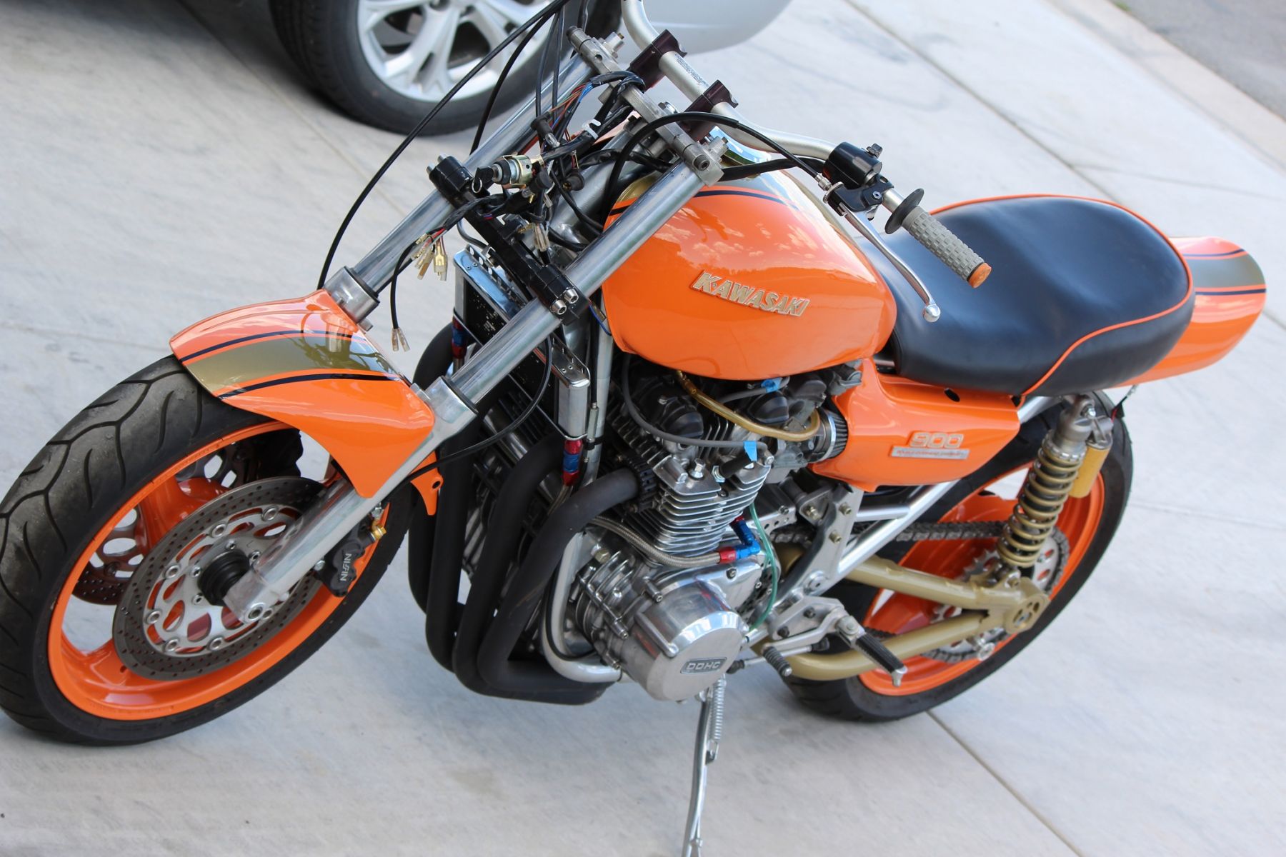

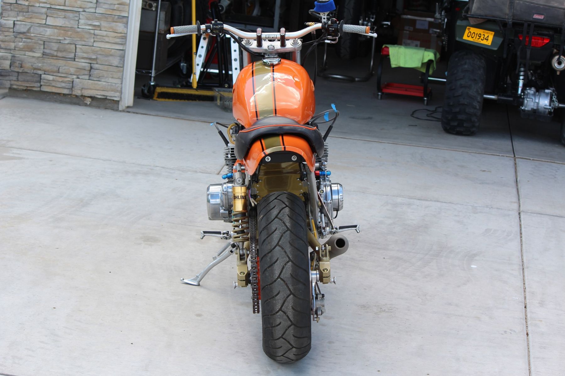

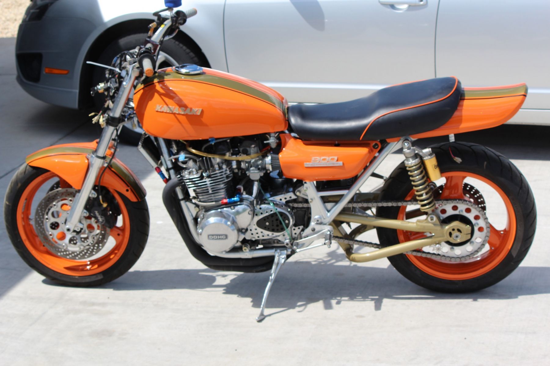

Long time since last report. First the bike is still alive, I have not drug it down the street behind my pick-up truck. This is good.
I got it back from the shop in Reno (protective custody foster home for a year), and started it. Number 4 cylinder is not firing. I took the carbs off, and cleaned them. The needle and seat was stuck closed in #4. Put it back together, still no luck; but when the mains kick in it roars. I think the float level is too low on that carb, so the pilot is not getting fuel. more tinkering.

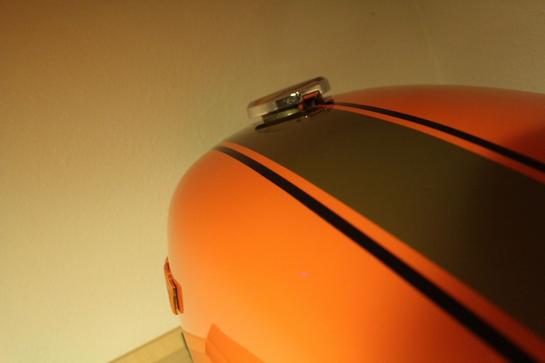

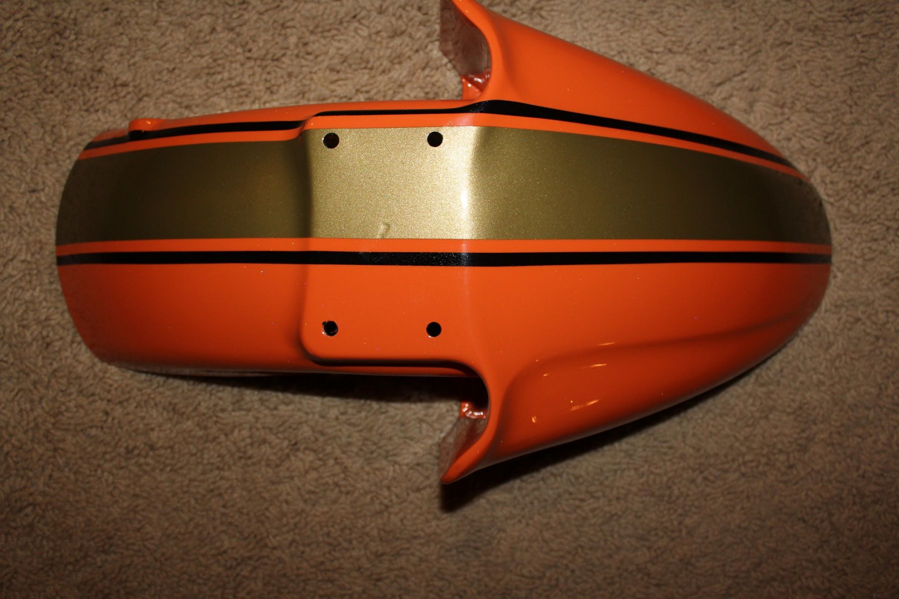

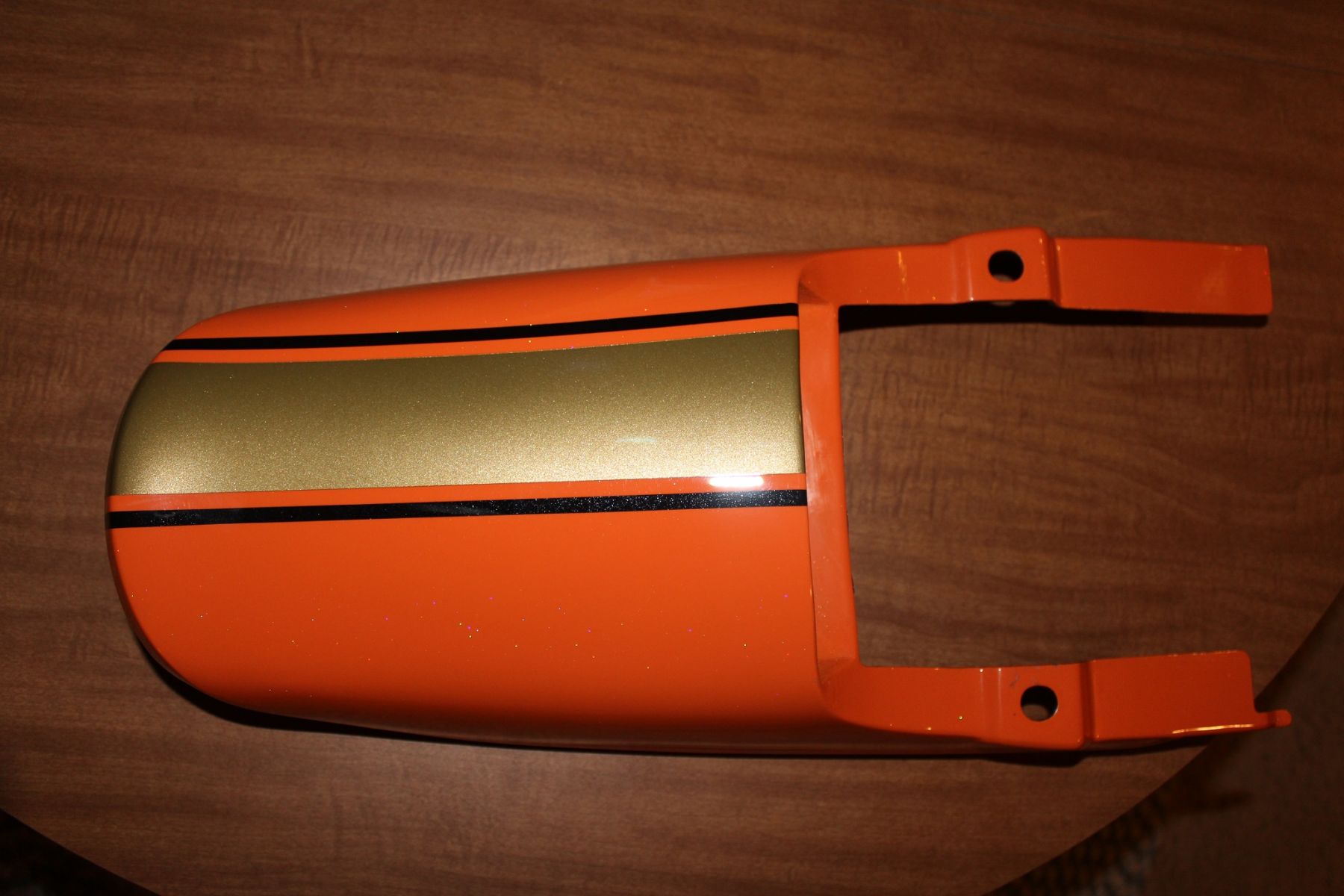

Meanwhile the Neighbor who owns the Gixxer I am restoring insisted on having the KZ paint "tuned'. The bike was solid orange, and graphically challenged.
"Gary" put some stripes on for me, and re-clear coated it. WOW !! The bike now has show quality paint. We got the title straightend out, so it is ready for the road.
I think I will end up with a new set of flatslides eventually but it is now riding season, which normally eats up the cash (track days and travel). Any way when it hits the mains at about half throttle it really sings, so this is a good sign.
I now owe Neighbor a ton of time, the paint is soooo nice it must have been expensive..but nobody is talking. The painter will not tell me, nor will neighbor. Gotta get more work done on the gixxer.
Here are a couple photo's of the paint.
