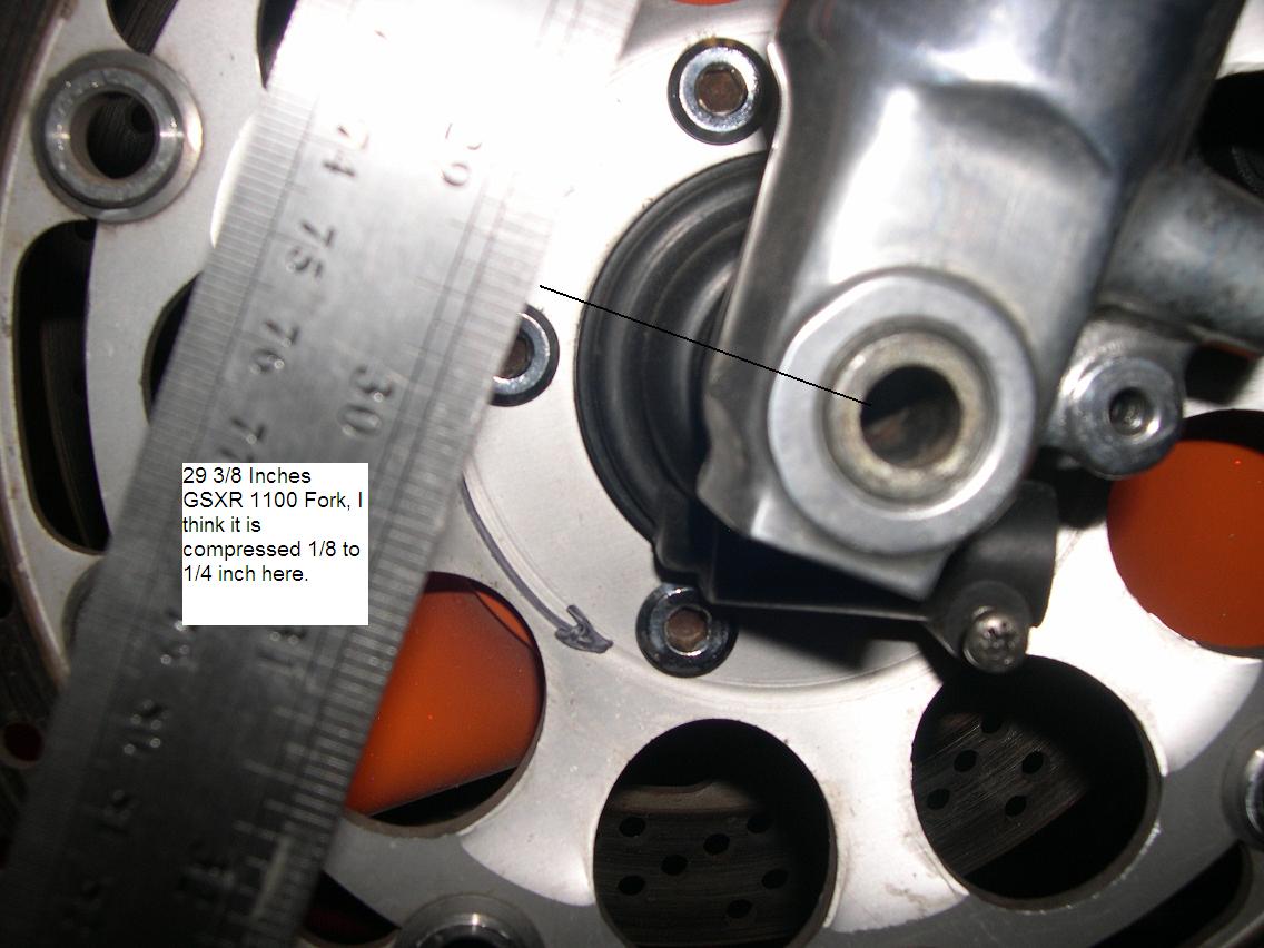

This fork, GSXR 1100
Gives me about
4 and one half inches ground clearance at the lowest part of the header.
Gives me about

THANKS ........I measured my original KZ fork and measeures 29" from centre axle to top of triple clamp so this is the dimension I will be looking for. I haven't got the GSXR parts bike home yet to measure the forks.
