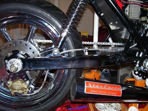

05 Oct 2014 19:534TheKZ1000 wrote: Nice job mounting chain guard. You do a fantastic job on your bikes and the detail you put in is phatt.
First off........I'm not an engineer nor do I play one on T.V.
BUT.......... drilling holes as you have most likely weakened the swing arm greatly.
If you had ran a weld bead around the top outer ring of plug, I would feel better about the insert.
I would watch for any stress cracks coming from holes. Just an observation?
Yeah, I thought long and hard about it before I did it. It's pretty thick steel and is fully boxed....plus I don't ride to crazy these days. It's been good for a few years now but I'll keep an eye on it. I'm sure it weakened it some, but hopefully not enough to make a difference in the real world.

Re: 1075 kit with cams...
06 Oct 2014 06:40
the strength of the arm is primarily in the vertical walls of the tube.
you didn't weaken the arm enough by drilling those two holes to ever make a difference.
they'll never crack out either,we use those rivnuts in industrial applications holding much more than that swingarm with no failures.
06 Oct 2014 12:35531blackbanshee wrote: the strength of the arm is primarily in the vertical walls of the tube.
That's great to hear Leon, thanks.

Re: Re:1075 kit with cams...
26 Aug 2015 06:40
...the strength of the arm is primarily in the vertical walls of the tube.
Actually the opposite, most of the strength is in the top and bottom of the box section, the sides just hold the top and bottom together. Look at the design of a steel beam, either for a point load or bending moment,
The strength is a function of the distance of the top and bottom from the axis centreline. Note the h variable is cubed. Better to increase the depth of the box section then using thicker walls.
So yes you have weakened it, in my opinion. But I wouldn't worry, in reality box section arms aren't to prevent breakage , it is to make them more rigid with less flex, so they are quite a bit stronger in yield strength than they need to be. A better plan would be to have attached at the inside on the centreline.
Nice build by the way,
Attachment srrt.jpg not found
Attachment iuihu.jpg not found

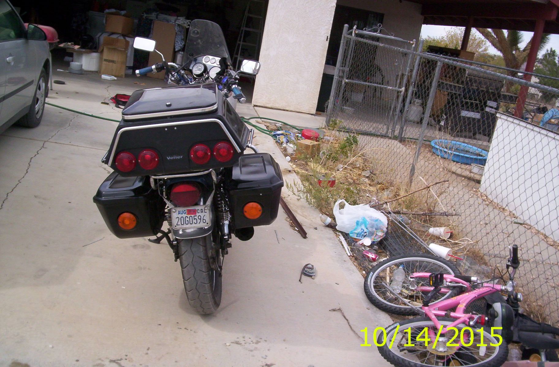

14 Oct 2015 19:57
I have a thought of what I will use as far as mounting the brake line but I am not too sure if it would be a functional idea. I measured the front lines so that is all good, just have to order them. As far as the back line goes I came up with 34" more or less. I'm not sure exactly where to lay that line out yet. I have a two inch over swingarm with the hanger on the bottom instead of on top. Does that sound about right or am I way off? I would like to see some pics of how that played out on you guys' stretched arms.
15 Oct 2015 08:15
Here's how mine ended up...it's strapped near the master cylinder and behind the rear shock. I can't remember if I added any other straps to the swingarm but I always wanted to do something there. I can't remember the length of the line though! :S
The Kaw List:
15 Oct 2015 10:50
The only issue I could see is if something were to hit it. Out here we have rocks and things, plus I like to go off the road from time to time. Everything on my bike is well off the ground.
