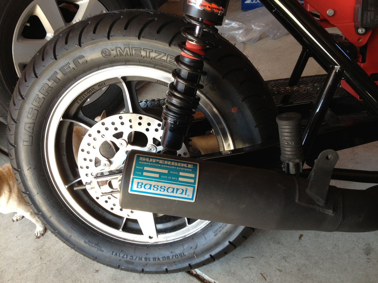

Ok, blow by blow of assembly...quit yer damn whining.
New tires, new pods.
Next, gauge cluster, new chrome and everything else except brakes and exhaust. I need to reweld exhaust or make a bracket to work with it. I think rewelding but...

19 Jun 2013 10:03i would hate to have to cut the bracket off this pipe and re-weld another on.
a custom bracket that clamped to the (basically)vertical tube would be cool.
hard to describe tho :pinch: .

You know? That IS the direction I'm leaning in and I was thinking billet aluminum clamping to frame too. I could always cut it later if it doesn't work for the esthetics.

19 Jun 2013 11:44A great old Bassani Superbike pipe!!!! Most of the Bassani Superbike pipes sold were plasma coated before they were painted. Thats why you never had much rust on a Bassani pipe. I would not cut the bracket off the pipe. You will lose the coating around where you weld the new bracket on.
Your idea with the bracket to the vertical tube would be the way to go. Plus if you wanted to get real fancy, use the rear exhaust rubber dampners from like the KZ900 made into your bracket, and then your pipe would be rubber mounted too!!!

Well, the two ideas were to cut the bracket and actually weld a spot on back of pipe so it's a very clean look utilizing the actual exhaust mount. The other was to make a bracket which I think would be the best idea and the third was/is to eaventually just find a 76 frame and weld up the frame really nice, powdercoat and swap parts. Probably a good idea.
