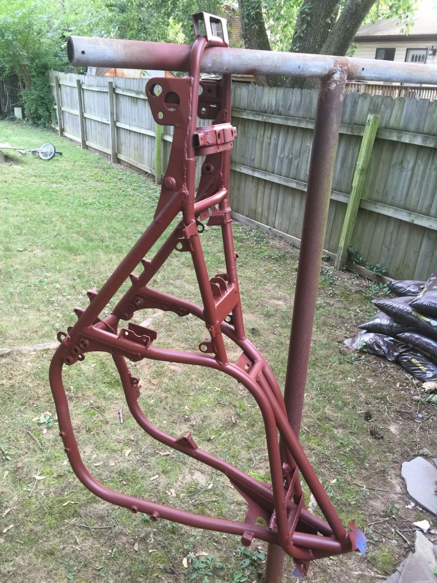

So, here is a link to my engine build after bending 2 valves:
www.kzrider.com/forum/2-engine/599876-kz...nengine-build#692932

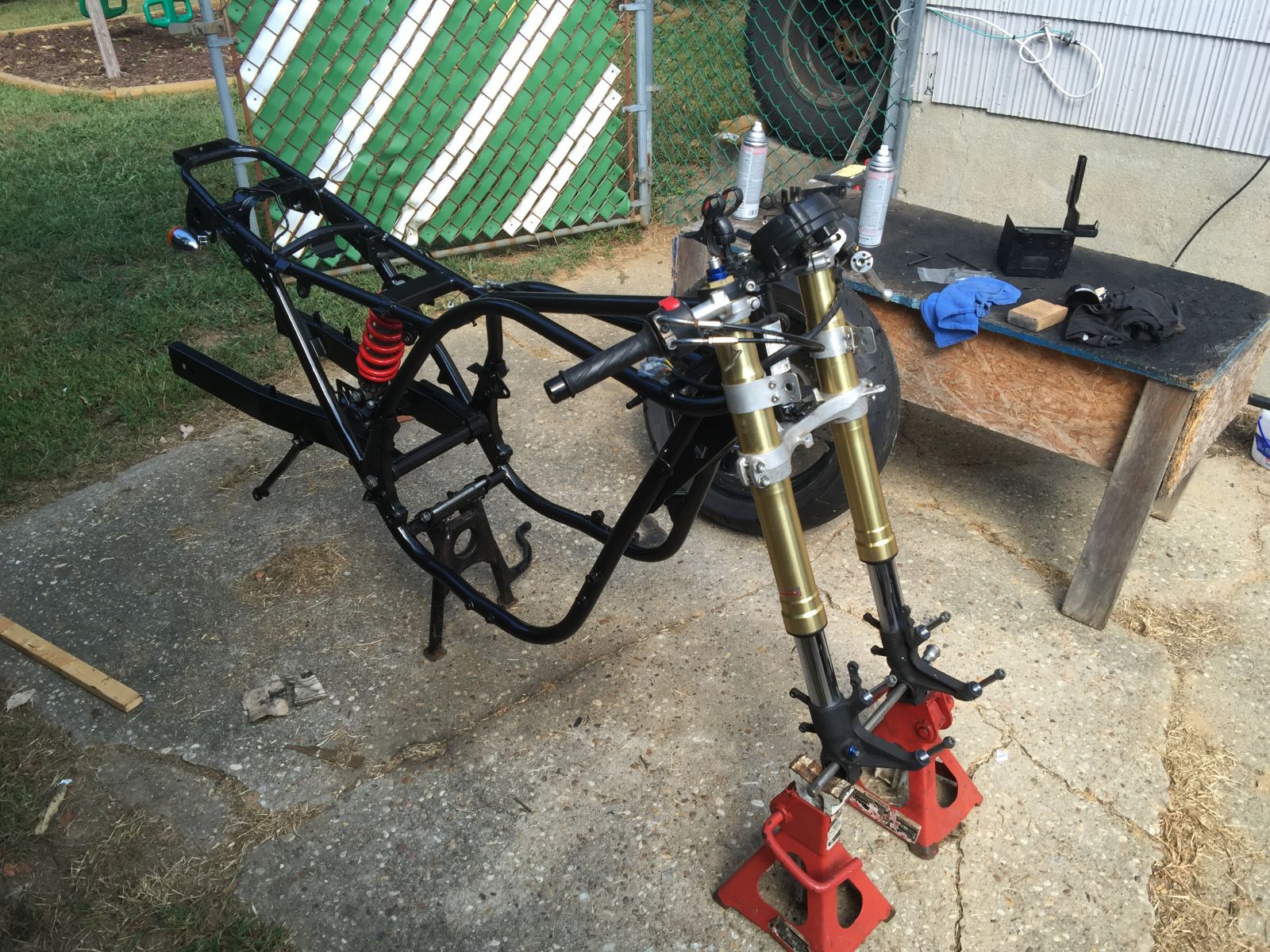

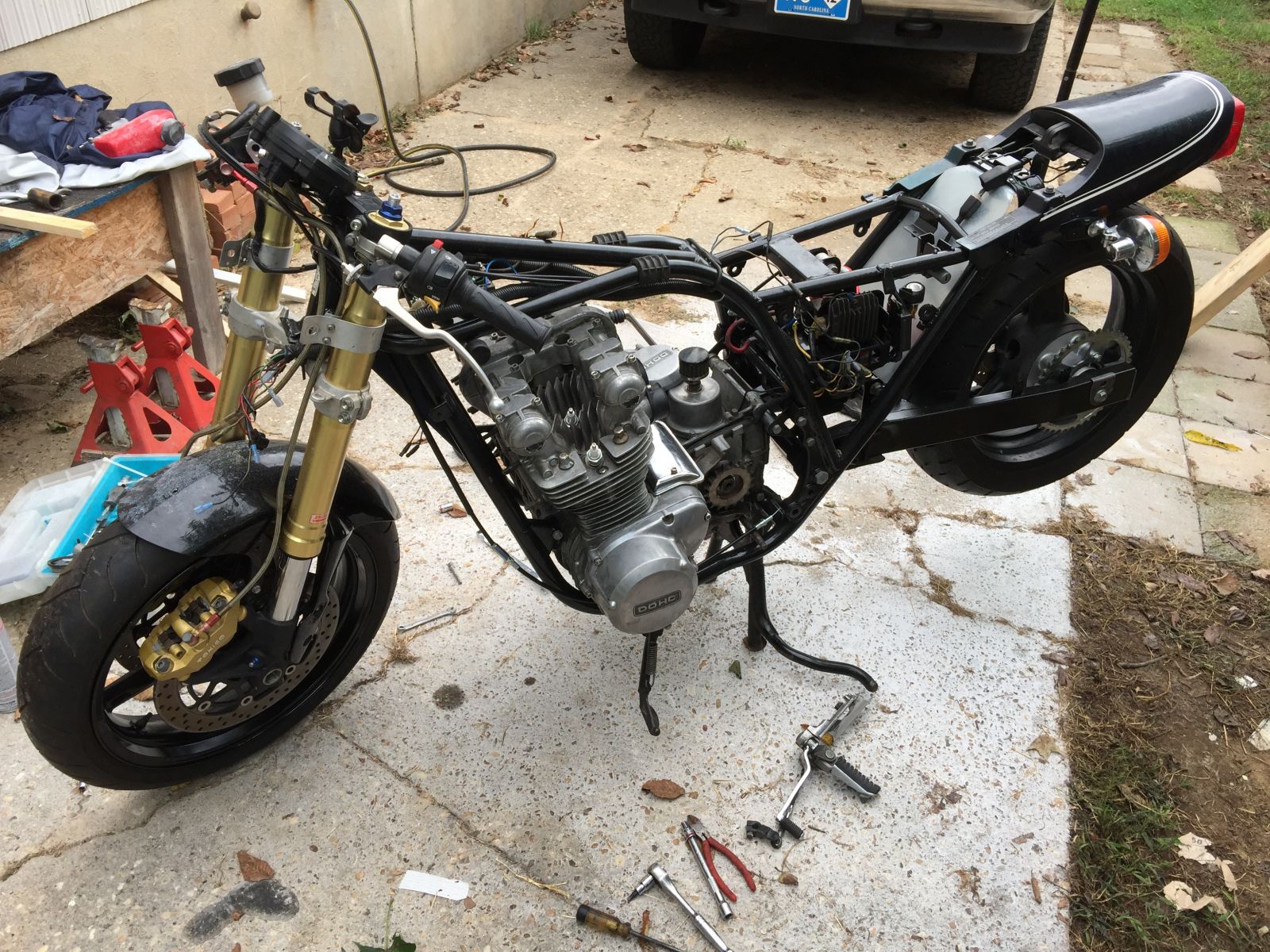

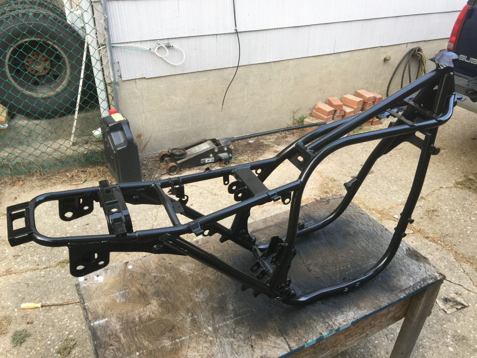

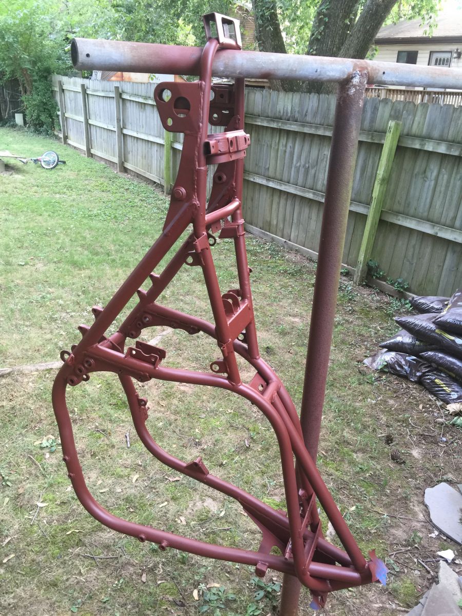

Since I decided to pull the engine completely, I tore it down to the frame and did some clean up.
I cut off the kickstand and had my buddy reweld it further forward, since it was hitting my toe with the rear sets.
The we cleaned up some welds we couldn't get to from the suspension swap, added a steering stop.
After that I painted her back up and cleaned everything as I reassembled it.

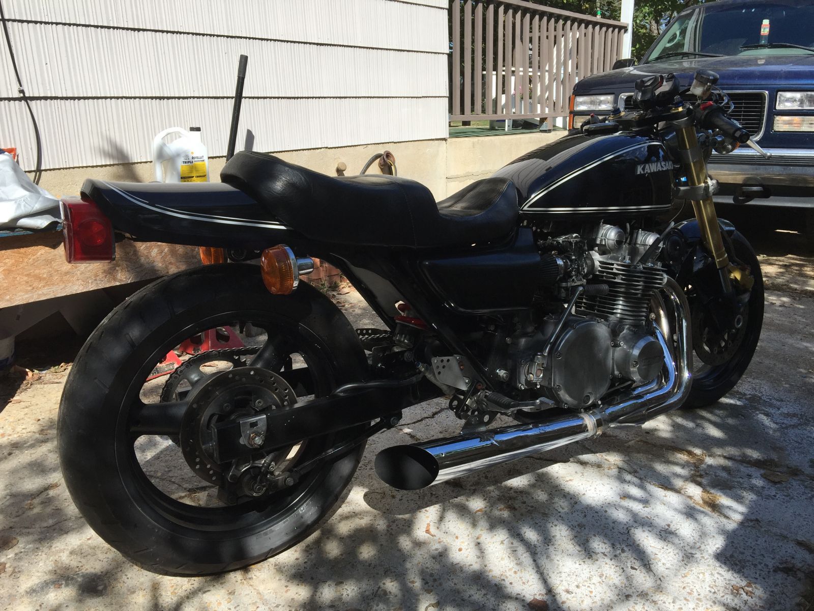

Reassembly!
Engine in
Ready for inspection

Primer
Paint
Reassembly!
Engine in

Man that steering stop took so long to do, it was such a pain in the ass lol.
No pics of us getting the motor out of the basement and into the bike?
- tachrev
- Rubber Side Goes Down
- Posts: 338
- Thanks: 11
Re: 1977 KZ1000 Street/Strip Project
02 Oct 2015 04:1869ranchero351c wrote: Man that steering stop took so long to do, it was such a pain in the ass lol.
I wish. That was fun.
FYI everyone else reading...we rachet strapped it to a 2x6 and each grabbed an end.
A fully assembled KZ1000 engine weighs a lot. I carried it downstairs without the cylinders & head, starter, or stator cover on it.
Once you add all that....oye.

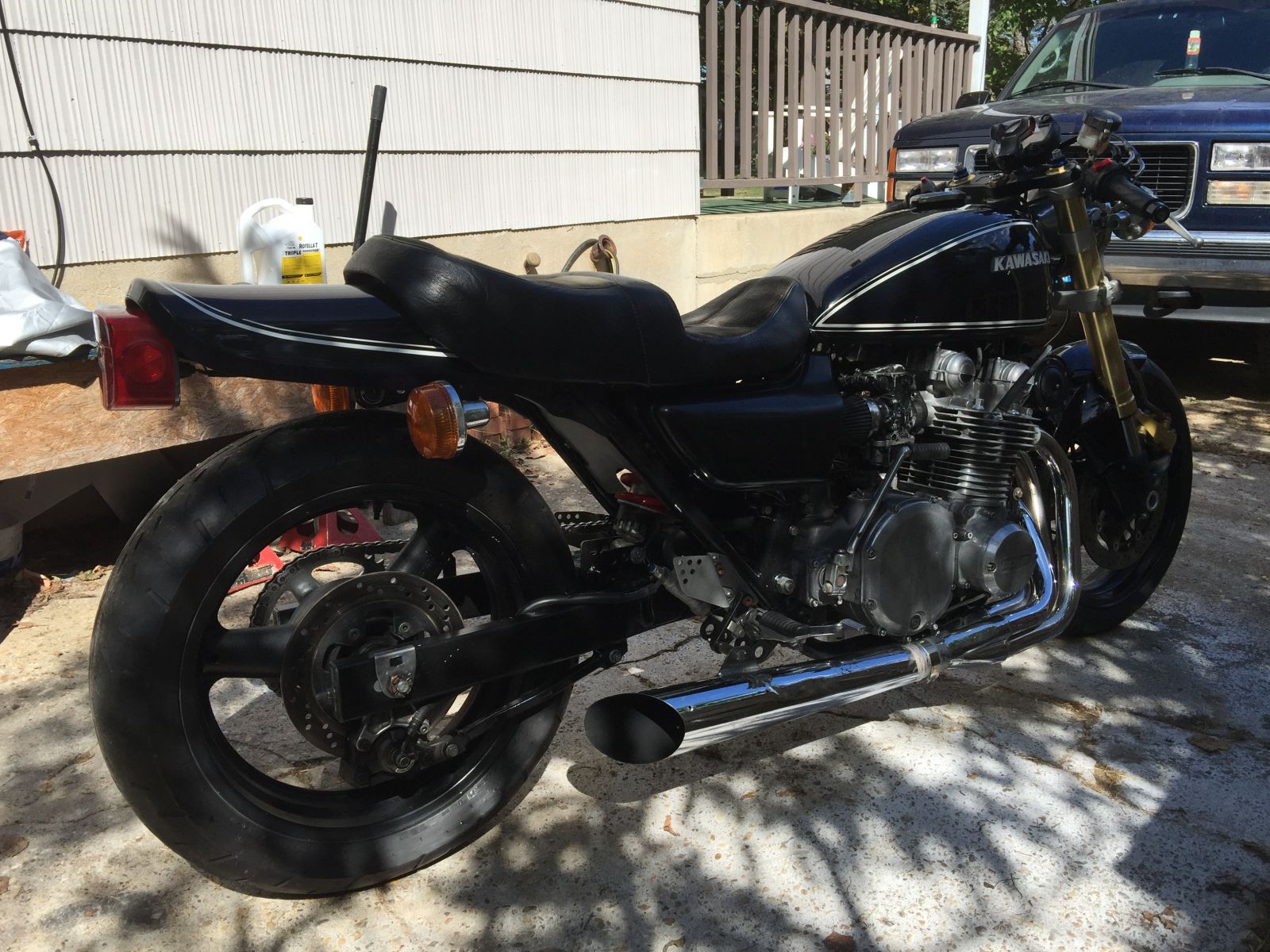

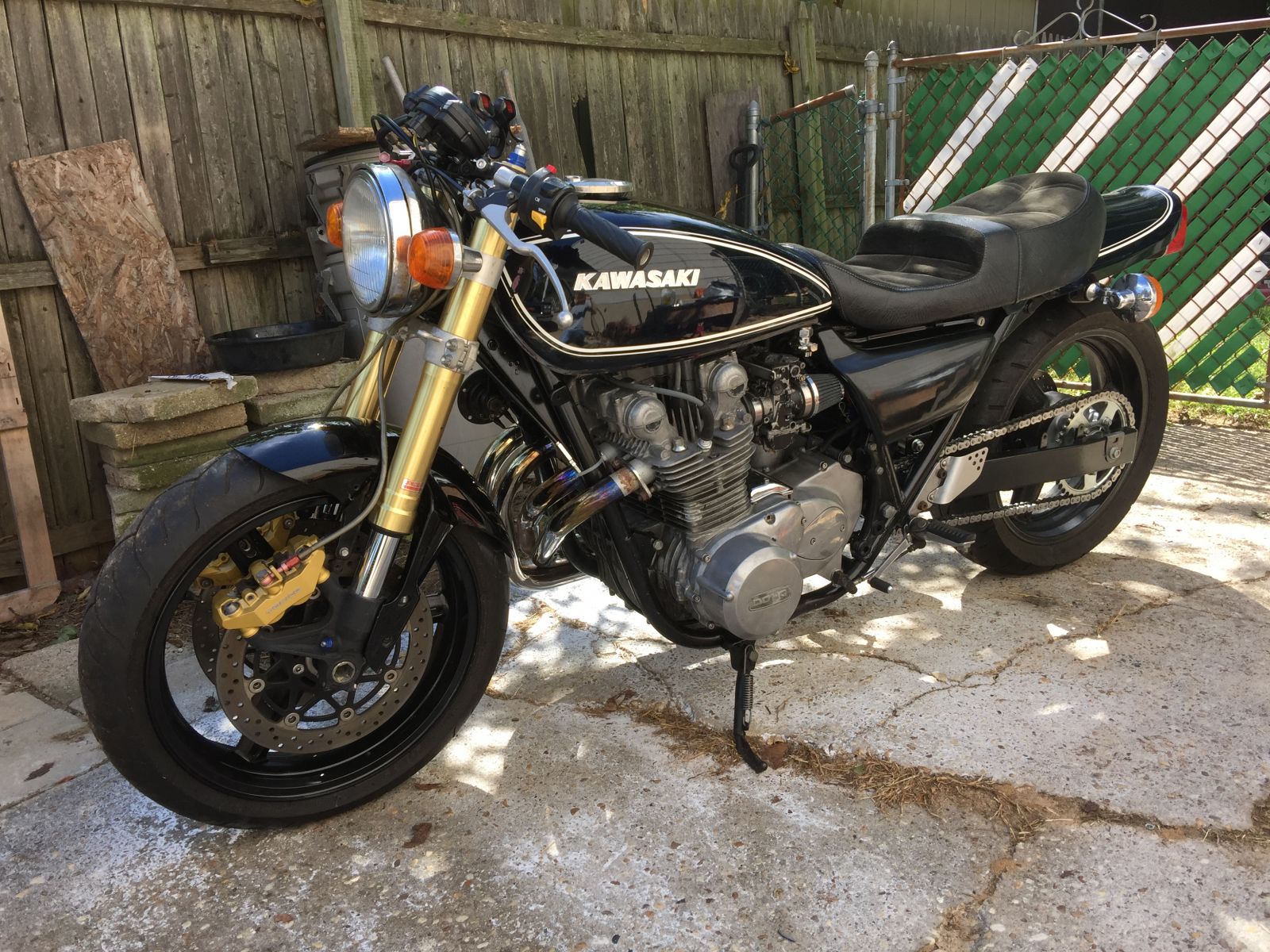

congrats on the rebuild. :evil:
your front end being backwards tripped me out for a minute there.
any particular reason it's reversed?
- tachrev
- Posts: 338
- Thanks: 11
05 Oct 2015 05:19531blackbanshee wrote: congrats on the rebuild. :evil:
Welllll....they do it on grudge bikes to get as much wieght as far forward as possible, to help keep the front end down.
I doubt I make enough power for that to matter, so I mostly just did it for something different.
Actually, 69ranchero, who commented earlier, originally did it. I liked it and it's been that way ever since.
