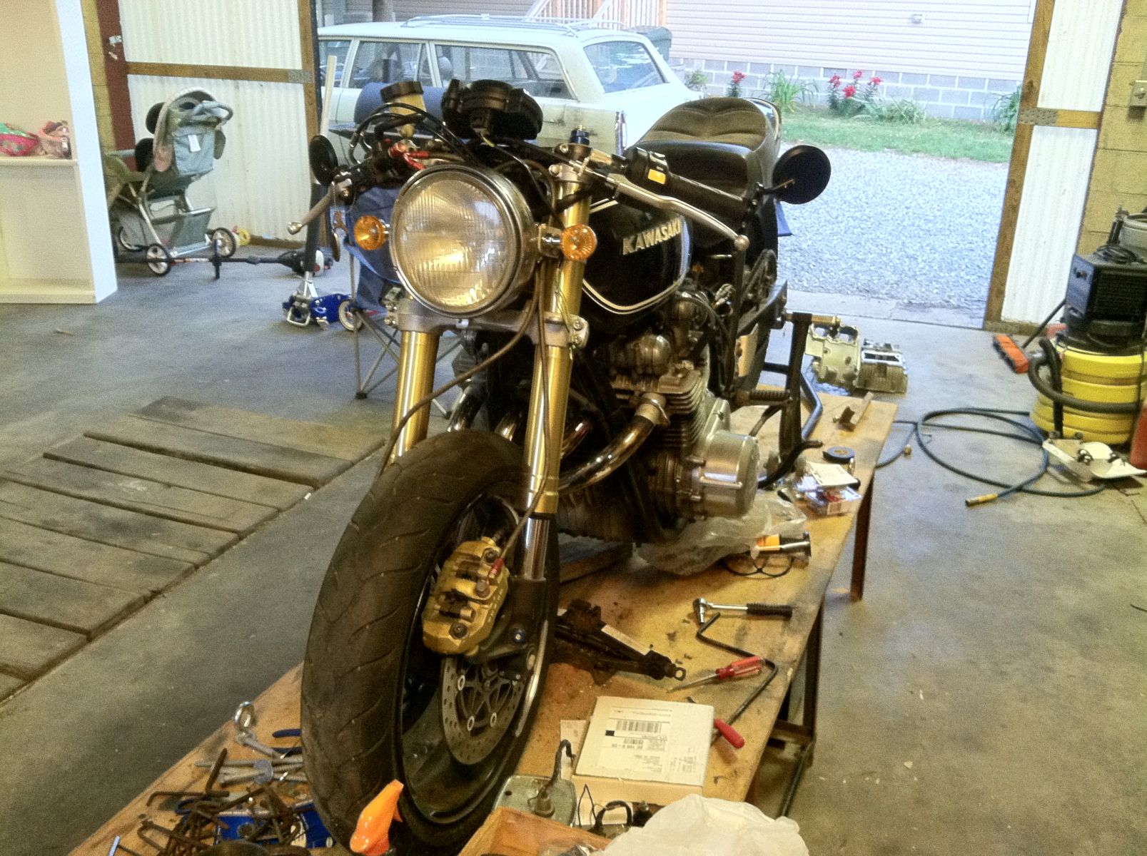

Here are some of the bigger changes:
1.) Header/Tire clearance
We where unhappy with the clearance between the wheel and the header once we bounced around on it a bit.
A few options where considered...higher rate springs, fork extensions, raking the frame, lower profile tire.
Nothing really seems to be the right solution.
Sooooo...a section was cut out of the header between the flange and the first bend, then my friend welded her back up.
We also pie-cute the megaphone and angled it up and in a bit.
If you look, it is pretty obvious now where it was sectioned. If I ever get the money to replate or refinish the exhaust though, I think it will look factory.
I'm really happy with the way the exhaust fits the bike now...way better than it came from V&H!

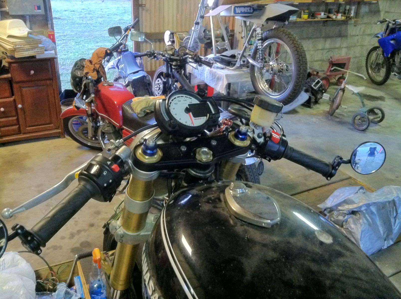

2.)Gauge
We changed the tach to a Koso rx-WhatEverNumber. A local shop gave it to my friend...they replaced it because it has a wobbly needle. It works well and looks much cleaner that anything else I would have come up with.
We've also added rs34's from M357 on this site, moved the ignition switch to the frame, and rotated the calipers to the front to be different and stick with the "drag bike" theme.
I bought a ballistic battery to replace my factory battery.
So now the battery box if almost completely factory, and I was able to mostly re-use the stock electronics mounting brackets.
Koso tach:
Outside at last...after the first ride!

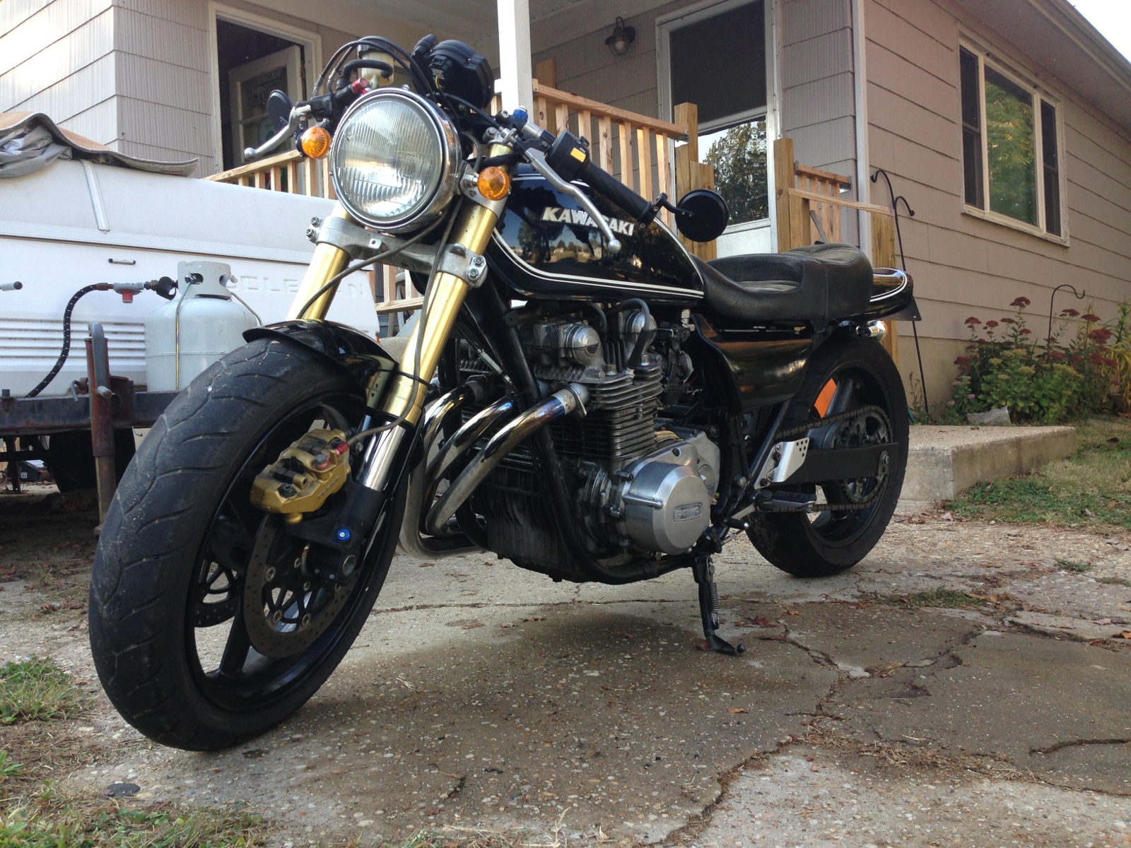

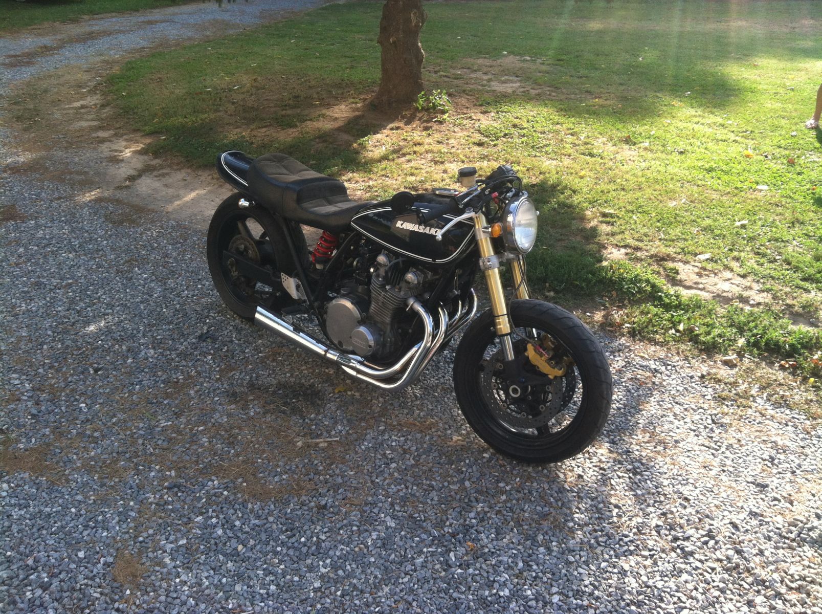

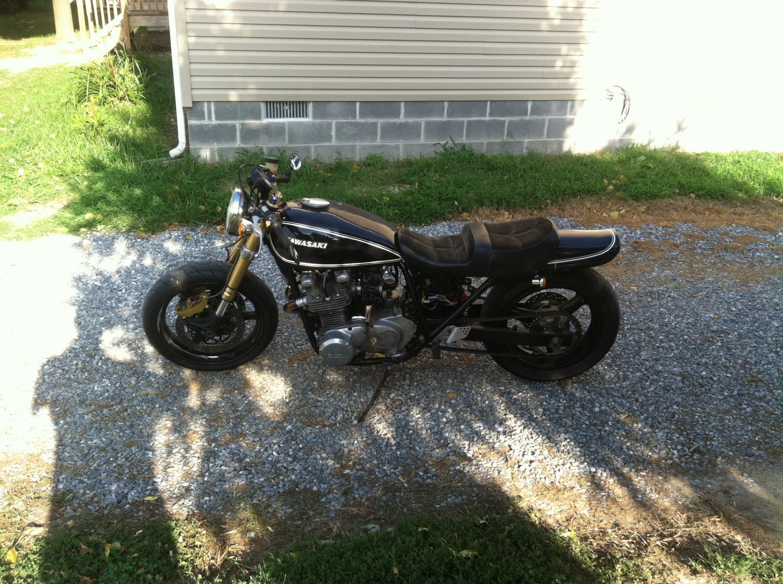

Just a quick update...I see it's been a year since my test ride.
I got it tagged, insured and rode it a few times this summer.
I thought about pulling it apart to update the wiring with better connectors and repaint the frame over the winter...but I was afraid it would take another 3 years. :laugh:
So I am going to fix little things and keep it ready to ride for next season.
Here it is as it stands now:
