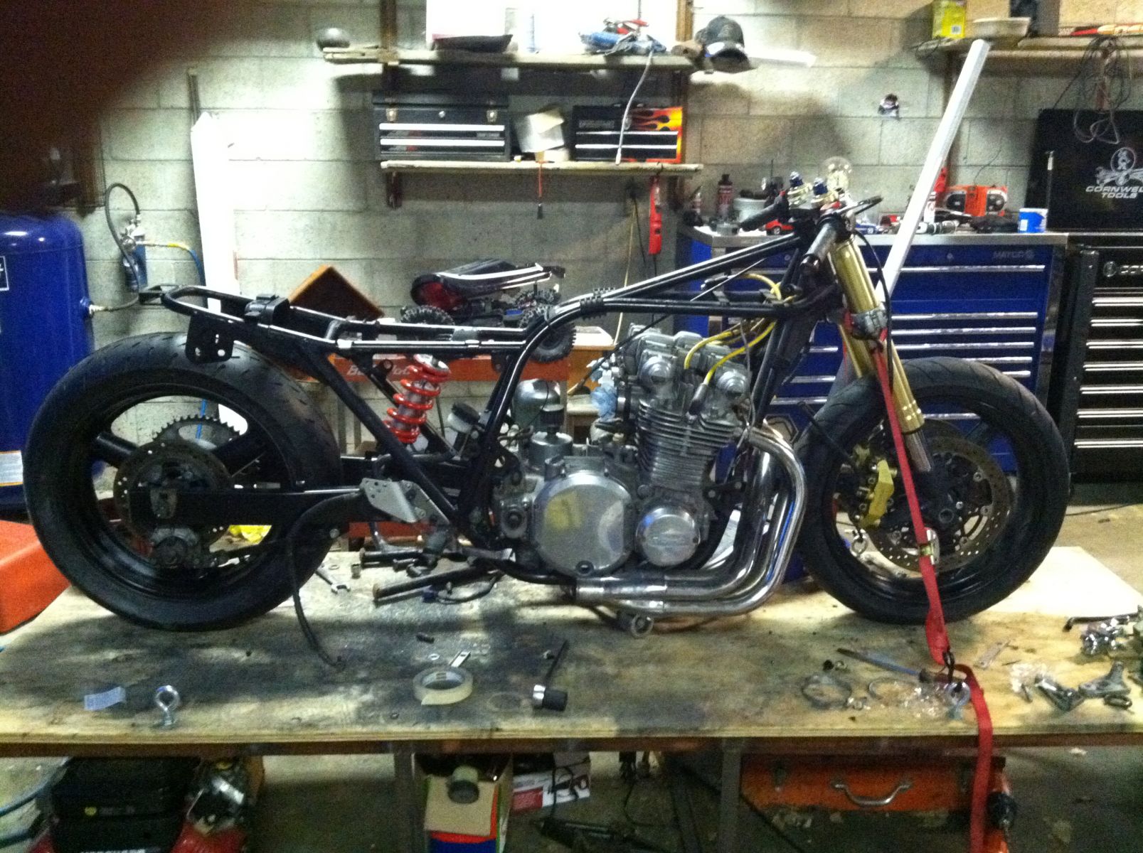

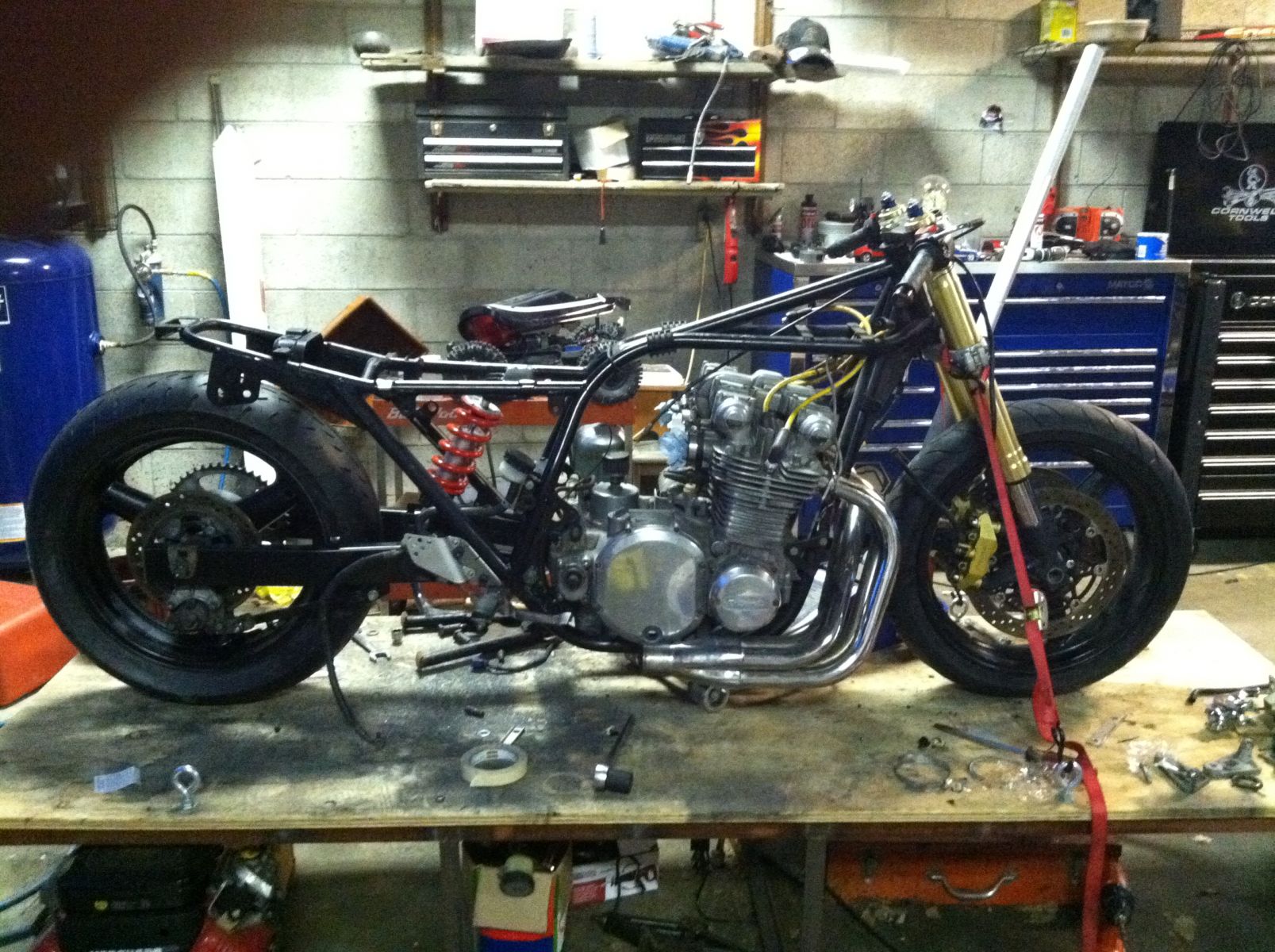

01 Jun 2011 09:53531blackbanshee wrote: lookin at your bike i just thought about your front tire contacting your header on hard front braking. where it dives enough to really compress the front end.
you may have already checked,but that is something to make sure you can clear.unexpeted front brake usually ends up with a face plant.
just sayin' :pinch: .
it looks kicka$$.
i have a 900 i want to do basically the same thing to.
I was worried about that too. We pulled it way down with the straps and tried the wheel in all directions.
It clears with no problems.
It actually has plenty of room when it's straight do to the design of the header.
The wheel is the closest when it is turned left. If I have it turned that far and slam the brakes that hard, I'm going over anyway. :lol:
Once it's on the ground I'll really bounce it around and see what happens.

cool man,i figured you had.
but if you had dropped it on the ground,and rode down the road and grabbed some front brakes and got slammed i would have felt like a douche for not saying nothing.

Be very careful until you know for sure. The bike I have USD forks on looked like it had plenty of clearance also. Even jumped on the front end to compress them to see the clearance I had. All looked good. Then I was moving slowly and hit the brakes hard while the front wheel was turned a little. The front end dived like it was supposed too and I lost the clearance I thought I had. The center two header tubes ended up on either side of the tire and suddenly straightened out the front wheel to the point I couldn't turn it at all. Once the front end bounced back, all was good again. Got my attention very quickly, so test it first before riding just to be sure.

01 Jun 2011 21:35even if it is a hardtail still cant get much lower and turning right is not fun at all while the header is scaping and tryin to throw the bike back strait (up and down).
