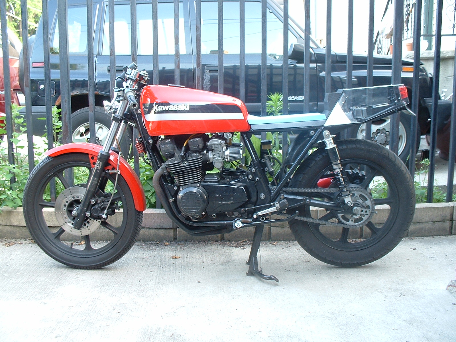

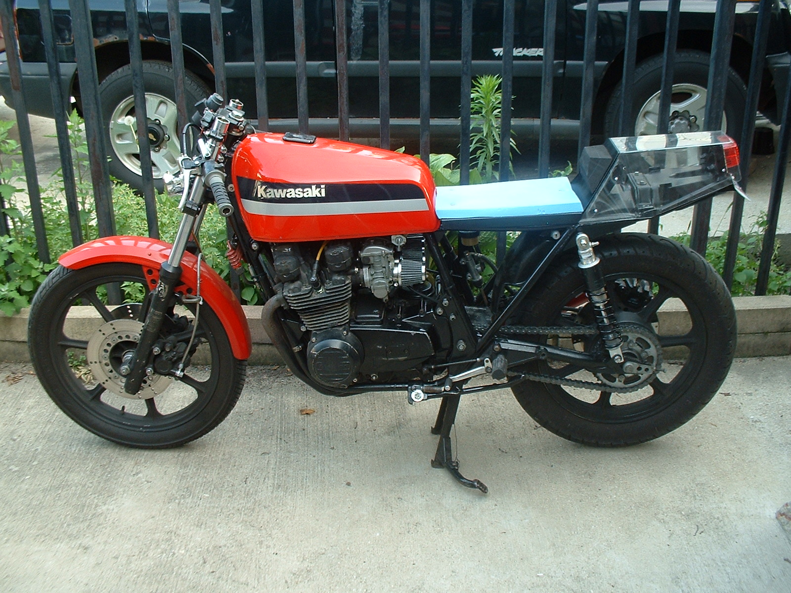

Thanks everybody. I still have to finish a few things, seat etc, but it's such a blast I've been riding it instead of working on it. It squeals the back tire like crazy just taking off fast. My buddy Stan calls it the question mark bike since it leaves big question mark shaped skids when i take off. It gets a little sideways sometimes on launch.
The progress will probably have to wait til next year, but I'll probably keep the photos coming and maybe a vid or two on youtube. (The Kerker is quiet but has great tone!)
531blackbanshee wrote:
Yes. Waiting for paint, but it's been so much fun with it clear, i haven't had the heart to sand it and paint it. I had a fluorescent light painted red inside it before the maggot. Saw the maggot at Menards and couldn't resist.
that thing is crazy!i would love to see that thing outside at night doing it's thing:laugh: .so the tail looks like it is just waiting on some paint,is that true?
good job keep the pics coming.

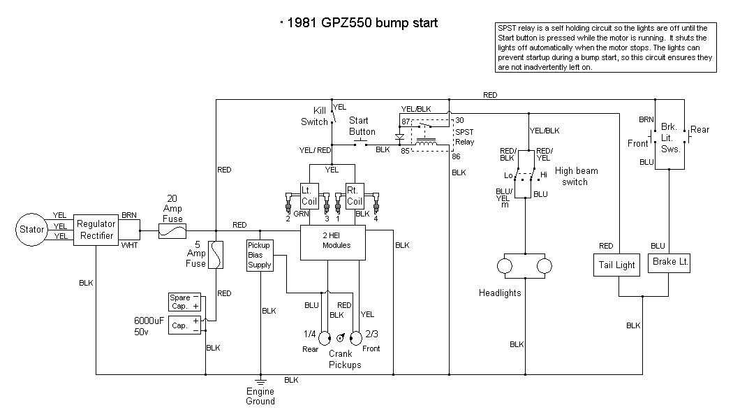

I thought I posted this somewhere, but couldn't find it. It's the current wiring for the batteryless system. I'm posting it for becker to use as a reference.
