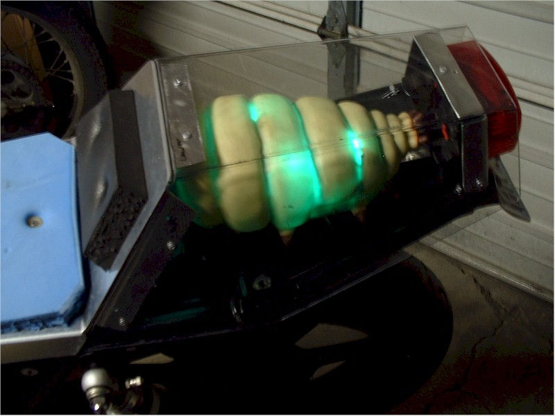

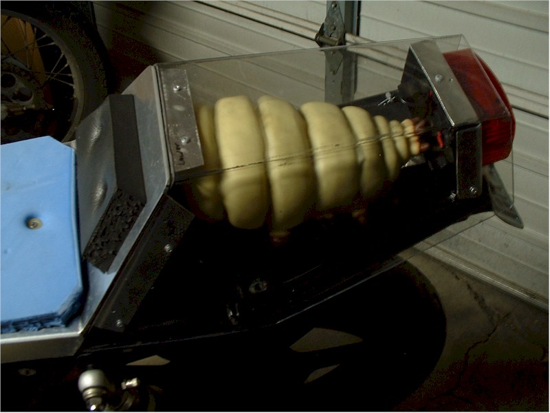

It still looks pretty much the same, except for this: I installed a singing maggot for Haloween. While I ride it sings, walks around, and lights up inside the cage.

I never thought I would say, I dig your maggot but that is really coolB) :woohoo:

That is hilarious! I love the glow worm! insult to injury when you run the bend on a newer bike....

that thing is crazy!i would love to see that thing outside at night doing it's thing:laugh: .so the tail looks like it is just waiting on some paint,is that true?
good job keep the pics coming.
