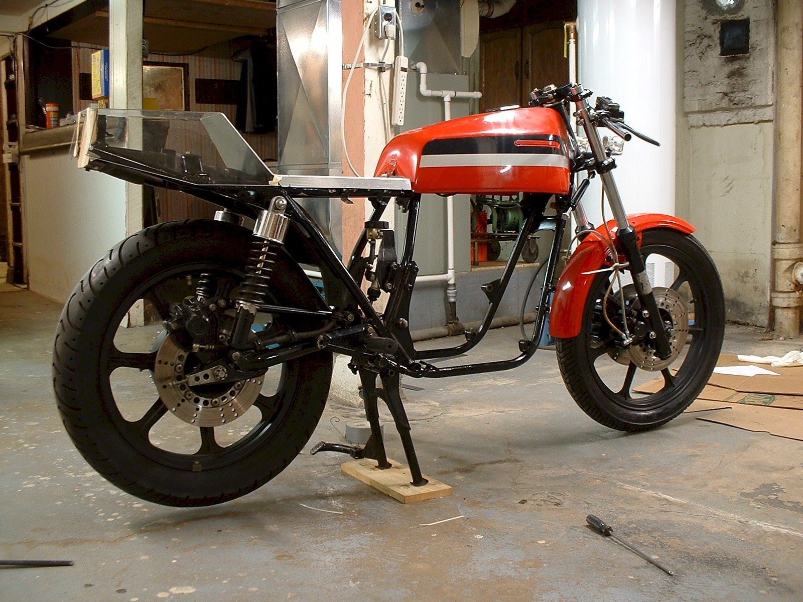

Your rear tire look larger than stock, are you running oversize, if so what size?

Saki Jockey wrote:
I'll give you the front Metzler, heck I'll give you two of them, but they are old, worn, and starting to get tiny cracks. I am going to get a new Dunlop GT501 front before I do any serious riding.
I think the rear is close to stock but it looks bigger for some reason in the photos. It's probably the camera angle plus the wheels are painted black which creates an illusion.
I think it's supposed to take a 120-90-18". But I have other gpz550's with 130-80-18". The wider 130 slips less on acceleration, but is less stable than the narrow 120 in turns. I haven't decided which I like better, but the 130 does look cooler.
Ps. If you've got any more of those front Metzlers hanging around...

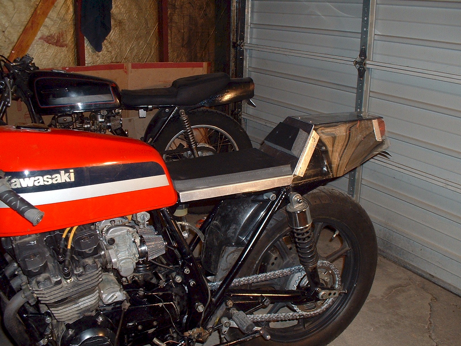

Here's a shot with the tail and seat assembled, but not painted yet.
(Kz400 in the background. Will post a thread on that later.)

Those indoor shots suck. I'll reshoot them outside when I get a chance. Plus my buddies KZ400 in the background needs some major cleaning.
