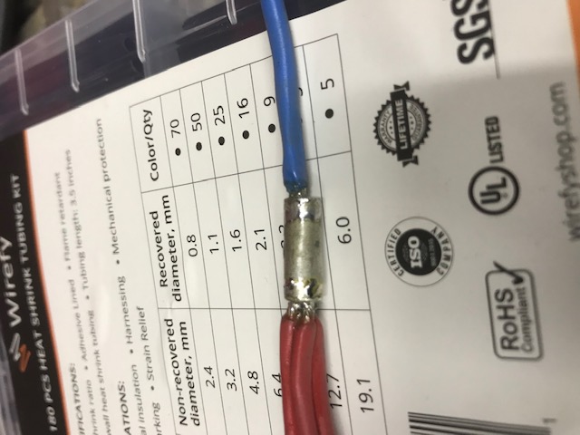

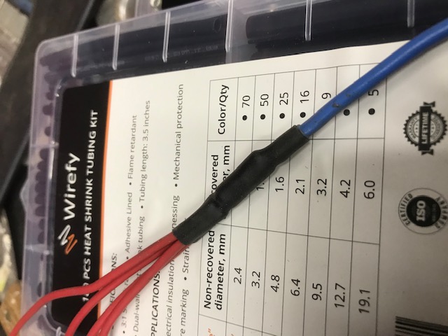

Every vehicle has dozens of these "node" connections in the loom and all suffer with corrosion when the damp has gotten into it regardless of mileage. The below is my solder in solution

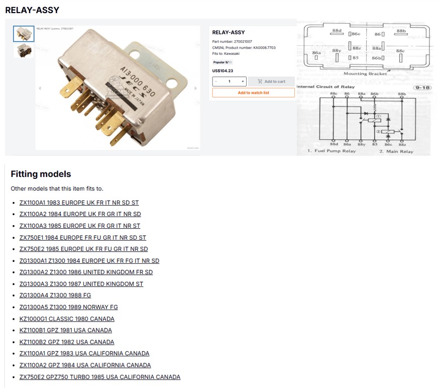

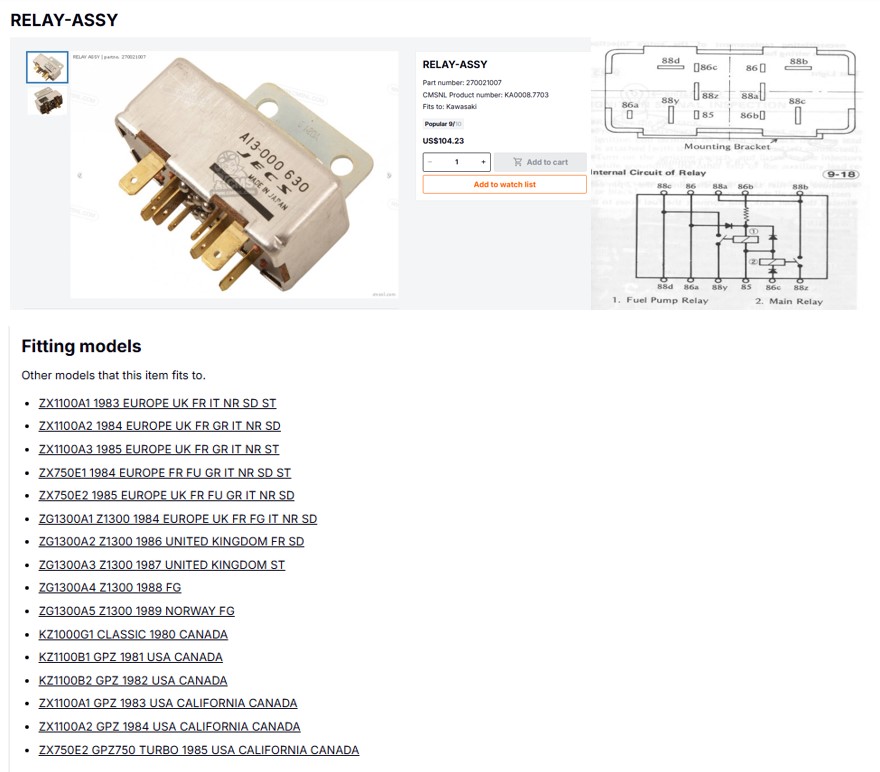

14 Aug 2025 04:29Well that sucks !! - they do seem to be "unobtainium" although they are common to most of the injected Kawas of that era (so you may find a used one) Personally I would carefully open it up and check the circuit board (being intermittent may simply be a soldered joint that has cracked and can be re-soldered) As a last resort if you can't fix it or find a replacement I can put together some instruction for you to build an alternative with 2 four-pin relays, three diodes and a resistorThanks guys for your input, this is all very helpful. I will check these joints at sometime, however I may have found the problem, and why I never checked this by now, well let's just say, lets put it down to experience. The duel relay has a fault. I did the test sequence on this relay, and found that it has an intermitent fault on one of the coils. I did a test and showed no continuity. Went and checked other things on the bike, went back and tested again, guess what, it had continuity. Fettled with a few other things, then retested, no continuity. This time no matter what i tried, tapping, kicking, bouncing it of the walks, it still failed. This is probably why it starts then stops and is a bugger to get started.

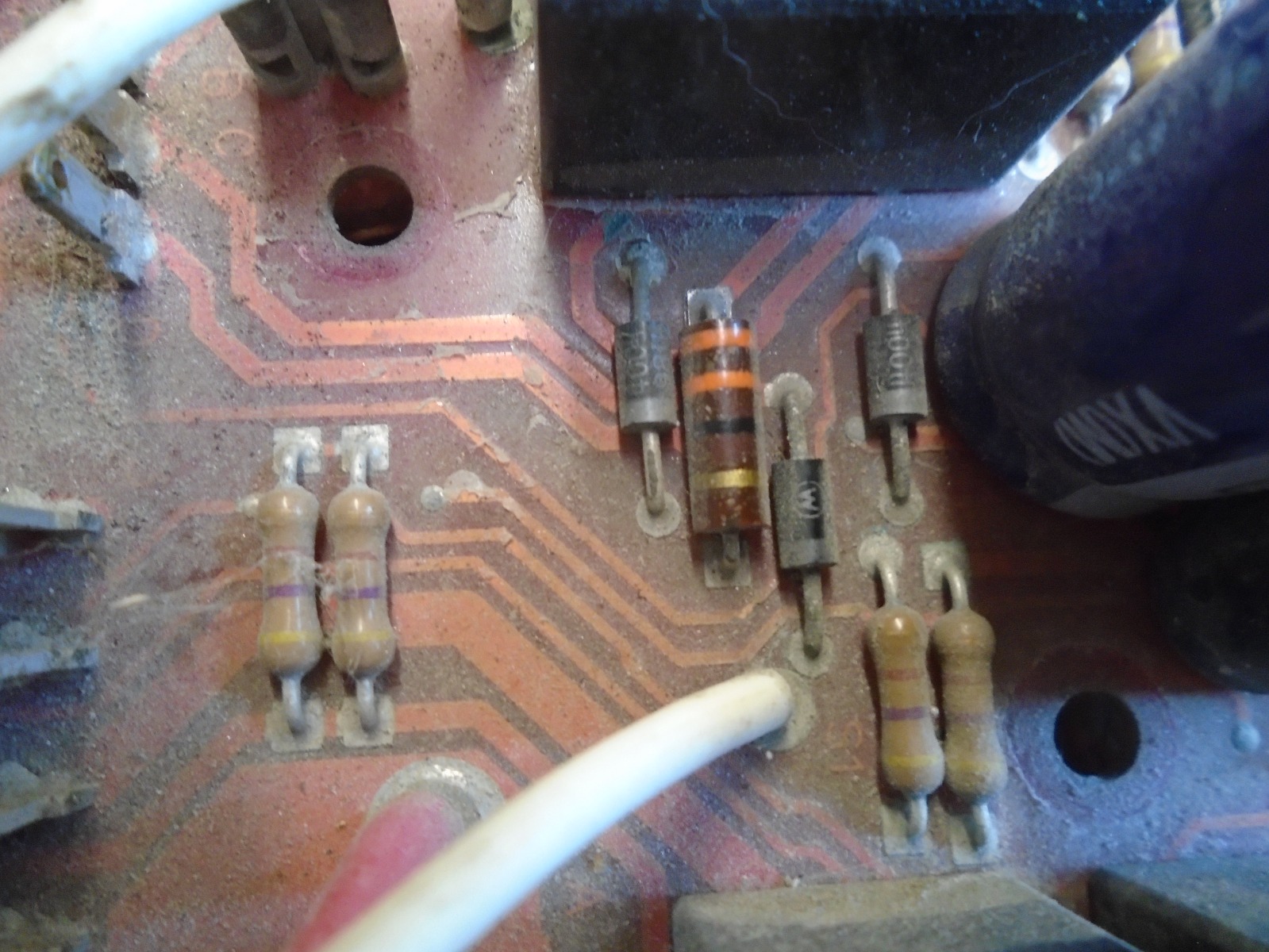

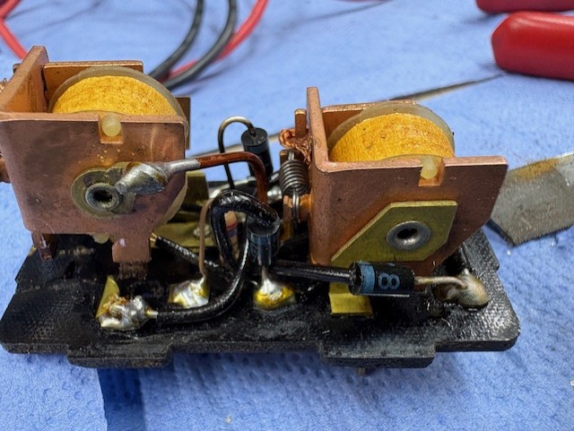

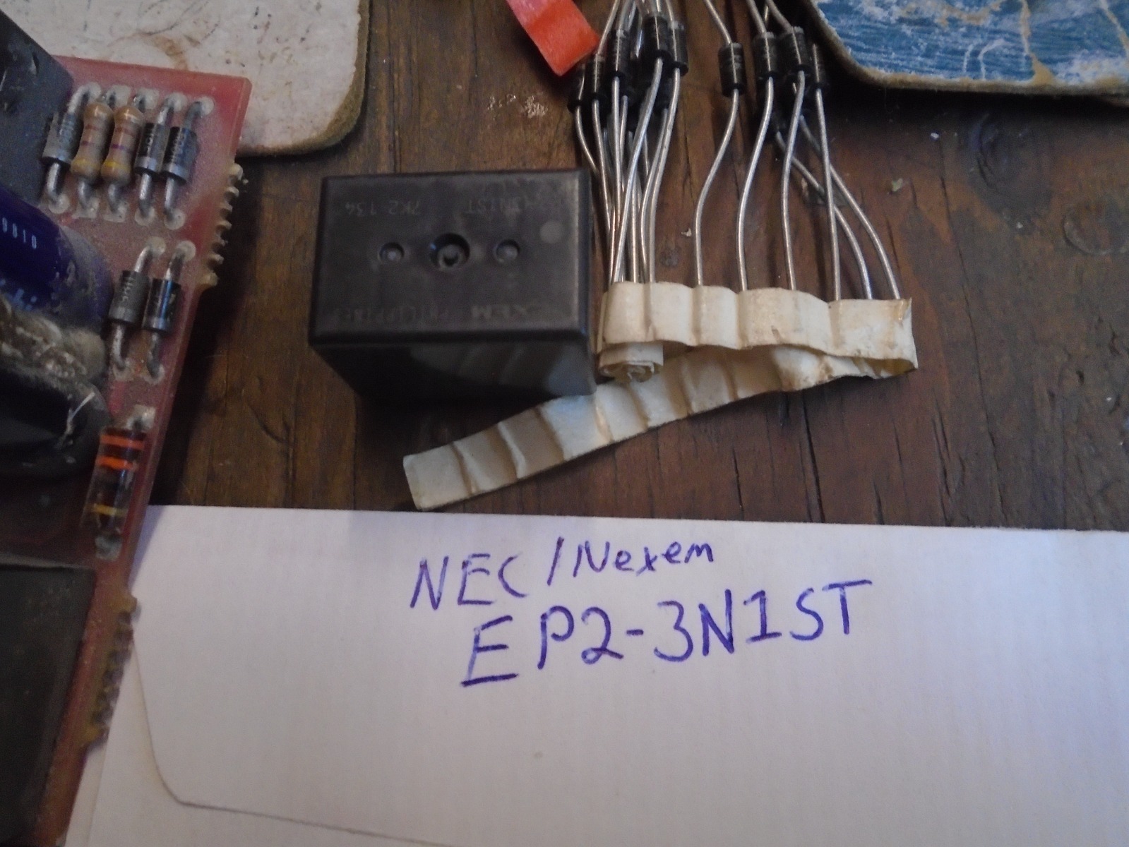

Like Wookie mentioned, easy to duplicate that array of parts. Just need the latching voltage of each relay, hopefully the same. Might be the 5V versions compared to line Main 12V if fed off the ECM? Those diodes i'll bet are the General Purpose 1N4001's but using a 1N4007 would be just fine too. Just peel back the "can" tabs and read the colors on what appears singular resistor making note of the last band (tolerance) color. Hopefully it's not potted in jelly!! I use Digikey here in the states, don't know what's available in your area. Regardless, for 1/10th the price of a "mystery" box in a Kawasaki bag, Kawasaki never made these BTW, You'll be set!!

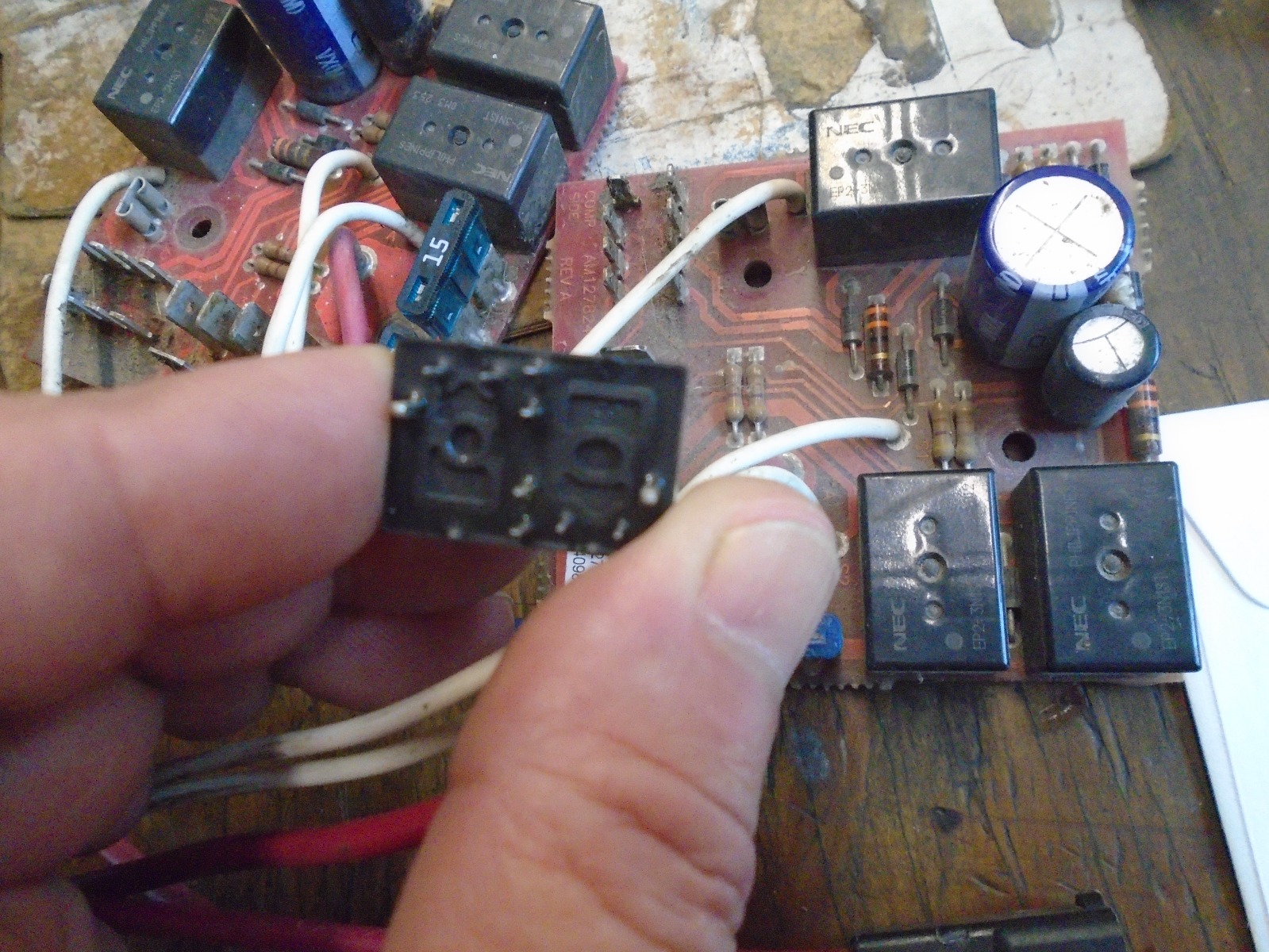

And some photos if they help! I rebuild these John Deere breadboards all the time and..they have the identical dual 12V relays built into each package as the schematic Wookie displayed. They are NEC or NEXEM EP2-3N1ST. About 5bucks a piece. Only difference is You'll have to solder on the diodes and singular resistor once you know it's value. Note the 1/4watt resister with the tolerance band of Gold, that's a 5% one, yours will be similar. Probably if you're clever, reuse the old can and solder accordingly. No One would even know, ha.

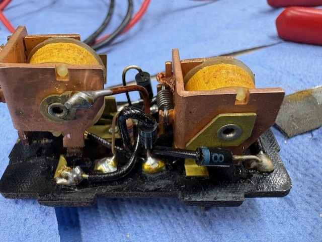

Hi guys, i had a look inside the relay, and i can't see any dry joints. As for rebuilding it myself, well let's just say this is a job better left to the experts. However, I have found a alternative to the original. It's a bosch with all the relevant connections in the correct place. But I am also finding this to be unavailable in most cases, except from the US. Has anyone else used this relay on this model with success. Also does anyone know where I could get this repaired in the UK.

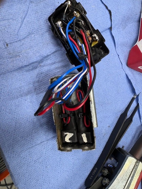

22 Aug 2025 10:33

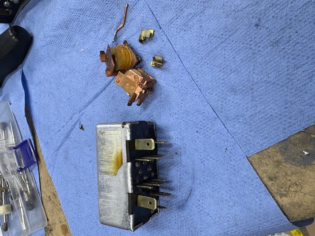

OK Paul, all done and will go in the post tomorrow. If anybody else wants to replicate what I have done I used 2 "micro" relays from Amazon rated at 10amps continuous. It's a bit fiddly but doable
(Clay I looked at your suggested relay but they cost way more here and I think for this application these were a better option)
