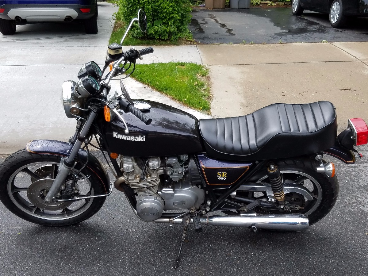

Hey all, I just picked up a 79 KZ650SR from eBay.
My dad had a red 78, and this one is a midnight blue 79, but close enough, right? Gonna relive my childhood!
While I'm here, I've got a quick question. I backed it off the trailer and fired 'er up - started right up. I let her warm up for a couple of minutes, and then when I went to take off, it didn't really want to... how long do you all let your bikes warm up before riding? It was 55 degrees, rainy, and I'm used to the low-end torque of my Vaquero and Vulcan 800, so I may be missing something here. Also, she started without the choke (about 1.5 hours prior the previous owner had started her up on the trailer, so I thought that was OK), and will stay running so long as I didn't let the RPMs fall too low.
I guess a better question is how many RPMs do you all tach your bikes up to before starting to let the clutch out? Like I said, I'm used to riding V-twins, and even had issues with a new Ducati X Diavel I rode on a demo day recently, since you had to give that one the nuts (3-4k RPMs) before letting out the clutch. Bike has just shy of 15,000 miles on 'er.
The bike starts and runs well, and once I got moving, I got all the way to 2nd gear before slowing and pulling a U-turn. I hope to go riding tomorrow (supposed to hit the 60s here on the East Coast). Just want to make sure that (A) there's nothing too wrong with the bike and (
I'm not doing something to break it.
Here's my new-to-me bike!
Thanks!

Thanks all ... I believe SWest is right. I didn't have time to look further into it last night, but to better answer y'alls questions, here goes:
1. At 55 degrees, it took about 3 minutes, by my estimation, to warm up to "ride-able" status.
2. The idle before riding is right on the money - around 1k RPMs. It's only after riding that it gets higher, and easing the clutch out at a stoplight reigns it back in, to a point. This is why I think SWest is right about the spark advance sticking.
Further, it looks like someone in the past 38 years put a regular KZ650 tank and seat on this bike, as they do not match my dad's 78 (my mom found a picture).
It does have painted fenders, upgrades brakes, and the VIN has a "D" in it, so I do believe it's an actual SR. Are there any other ways to tell, or differences between the regular 650 and the SR?
-John
