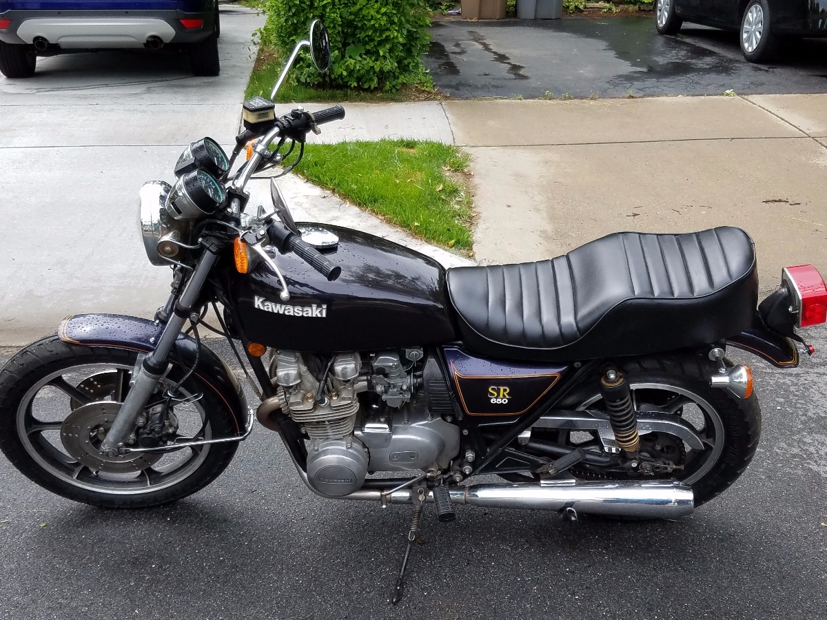

Hey all, I just picked up a 79 KZ650SR from eBay.
My dad had a red 78, and this one is a midnight blue 79, but close enough, right? Gonna relive my childhood!
While I'm here, I've got a quick question. I backed it off the trailer and fired 'er up - started right up. I let her warm up for a couple of minutes, and then when I went to take off, it didn't really want to... how long do you all let your bikes warm up before riding? It was 55 degrees, rainy, and I'm used to the low-end torque of my Vaquero and Vulcan 800, so I may be missing something here. Also, she started without the choke (about 1.5 hours prior the previous owner had started her up on the trailer, so I thought that was OK), and will stay running so long as I didn't let the RPMs fall too low.
I guess a better question is how many RPMs do you all tach your bikes up to before starting to let the clutch out? Like I said, I'm used to riding V-twins, and even had issues with a new Ducati X Diavel I rode on a demo day recently, since you had to give that one the nuts (3-4k RPMs) before letting out the clutch. Bike has just shy of 15,000 miles on 'er.
The bike starts and runs well, and once I got moving, I got all the way to 2nd gear before slowing and pulling a U-turn. I hope to go riding tomorrow (supposed to hit the 60s here on the East Coast). Just want to make sure that (A) there's nothing too wrong with the bike and (
I'm not doing something to break it.
Here's my new-to-me bike!
Thanks!

OK, I just got back from my maiden voyage - 10 whole miles, including a stop for fuel.
Here's what I know now:
1. The bike takes a while to warm up
2. Once warmed up, it revs freely and runs like a scalded dog
3. Shifts fine, brakes fine, steers fine, all the cables and stuff work great
4. Tank is clean. There are a couple of spots in the center that look like a gas pump filler tapped it, but that's it
5. What a fun ride!
6. Carbs seem just fine, bike pulls strong and has plenty of pep
7. Idle varies between 2k and 3.5k RPMs
8. Clutch is great. Got her into 5th gear, snapped the throttle a little bit, go no slipping
Is #7 above normal, once warmed up, and after riding? I noticed it at stop lights and once I pulled into my driveway. What should I check for on that one?
Also, I plan to have my regular motorcycle mechanic look her over (hopefully this coming weekend) and let me know if anything I haven't noticed is amiss.
Thanks for the quick replies, but this one looks solid, folks
It dang near brought a tear to my eye to be back on a 650SR, after over 20 years without one (like I said, my dad had one when I was growing up, and I have fond memories of sitting on it, pretending to ride, as well as riding as a passenger).
Now, to just keep her running smoothly.
-John

Thanks all ... I believe SWest is right. I didn't have time to look further into it last night, but to better answer y'alls questions, here goes:
1. At 55 degrees, it took about 3 minutes, by my estimation, to warm up to "ride-able" status.
2. The idle before riding is right on the money - around 1k RPMs. It's only after riding that it gets higher, and easing the clutch out at a stoplight reigns it back in, to a point. This is why I think SWest is right about the spark advance sticking.
Further, it looks like someone in the past 38 years put a regular KZ650 tank and seat on this bike, as they do not match my dad's 78 (my mom found a picture).
It does have painted fenders, upgrades brakes, and the VIN has a "D" in it, so I do believe it's an actual SR. Are there any other ways to tell, or differences between the regular 650 and the SR?
-John
