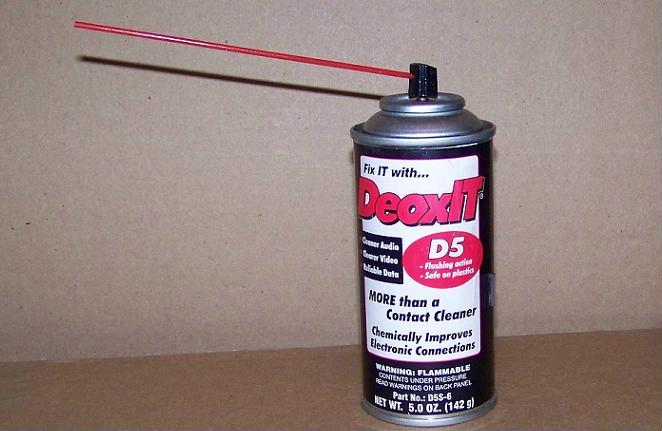

I'd be inclined to use Scotchbrite before I used sandpaper so as to avoid gouging the contact surfaces. There is also an excellent product that is a spray on called Deoxit that is a huge help for those hard to reach connector contacts.
www.amazon.com/Hosa-D5S-6-DeoxIT-Contact...=8-1&keywords=deoxit

Use Deoxit D5 NOT sandpaper on connectors. If you sand them you will remove the plating that retards or prevents corrosion. Deoxit will clean them and leave them ready for use. You can buy it at Radio Shack, Amazon, etc., etc. Ed

Thanks for that! I have a scotchbrite pad at home I will use for this, I think.
In the mean time, I will order DeOxit. I see it's a contact cleaner? Can I use anything NAPA sells? I'm headed there tomorrow for something else anyway.
