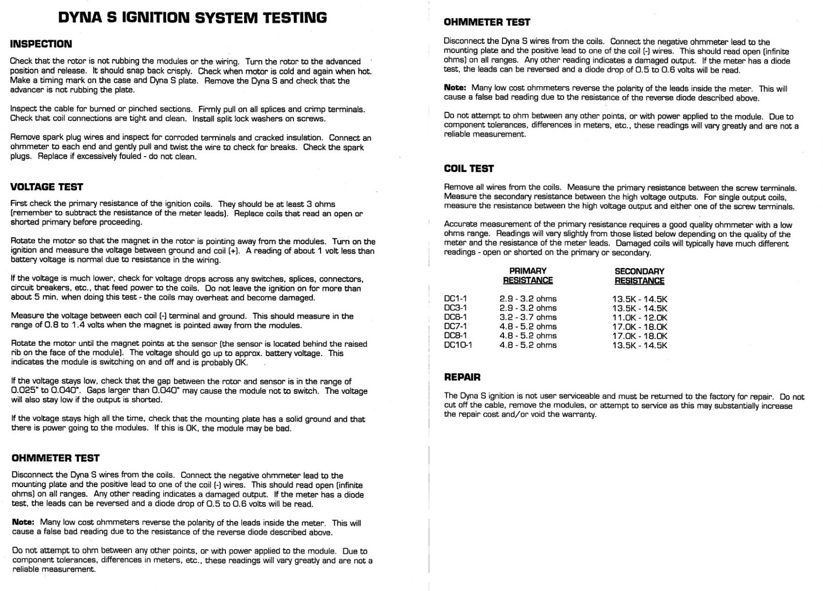

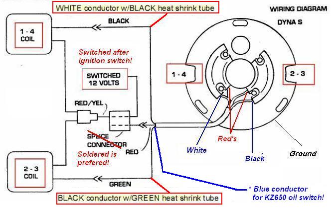

Here you go Jeremy, as discussed....
EDIT: Check your e-mail for the pdf's for they're not attaching here....
* Confirm the Dyna-S wiring
* Ensure you have desired Battery +Vdc (Should be 12Vdc + on a good charged Battery) to each coil terminals.
If Battery @ 12Vdc plus and coil voltage is less ~ 10-11 Vdc, then bypass coil voltage through switch or relay for testing.
* Ensure you have desired Battery ground to engine case continuity
* Static Align each ignition plate pick up as described in the Dyna documentation,
* Dis-connect the handle bar kill switch from the harness
See you on Friday...
OMR
Procedure for static alignment....
Troubleshooting & testing...
OMR
