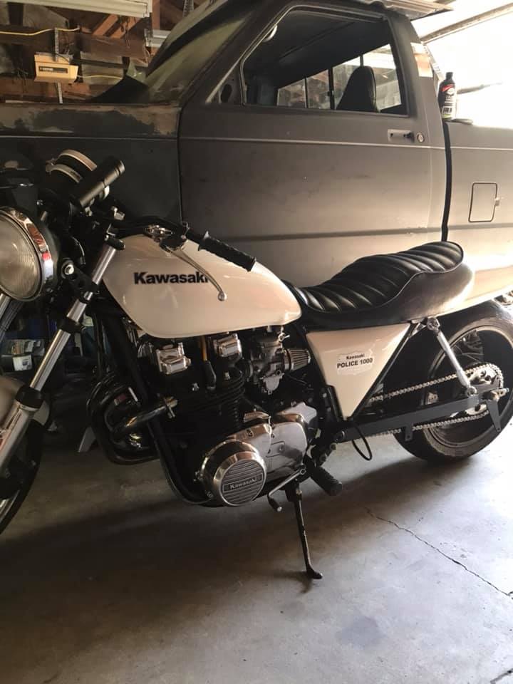

Looking for a swing arm to fit a custom KZ 650B frame (noobie) was created by TokyoElbow
07 Feb 2019 23:28
Hi there,
Just to start of I'm a complete novice at this so forgive me If I sound thick.
(I bought this bike as you see it, the only thing I've done is change the handlebars and put a new exhaust on it)
I'm starting a project and I would like to get some feedback on what kind of swingarm I could use on my KZ650B frame.
I already have a GSXR SRAD 750 front end with wheel and I would like to get a matching rear wheel so wondering if it would be ideal to swap the swingarm for something more modern. Then the plan is to tidy up the rear end perhaps put a tail on it.
Are there any charts that you can tell me which swingarms fit my bike?
Any help would be truly grateful.
Elbow
