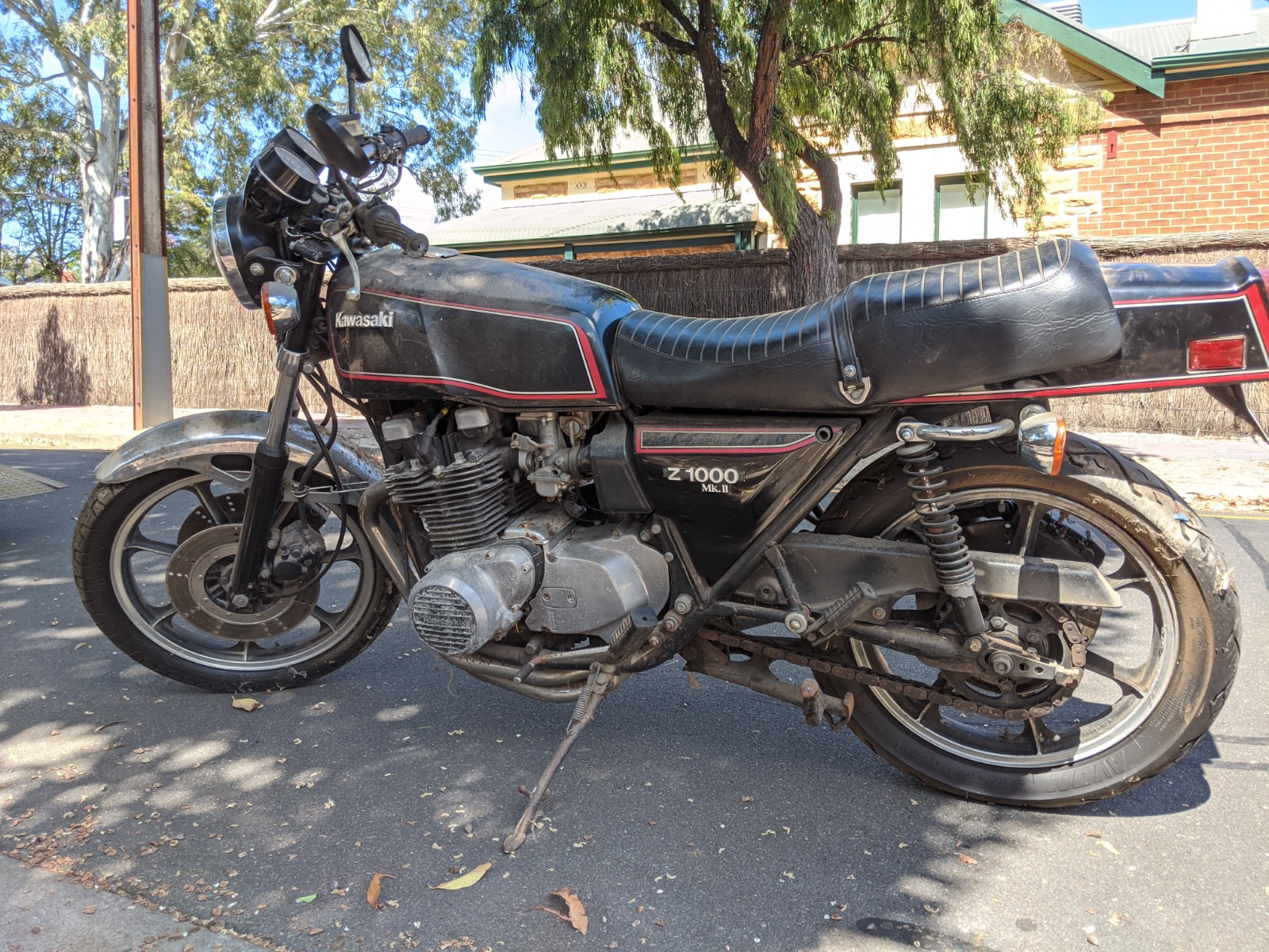

'79 KZ1000 MKII - Restomod after 32 years of shed time was created by Fishball King
17 Oct 2020 00:34
Got this bike from a friend. It belonged to his uncle who moved overseas in '88, it then sat in the shed for the next 32 years. Its got 68,000km on the clock but I have records that it was rebuilt at ~60k.
No huge plans at the moment as I have to do a bit more research on what it possible with minimal frabication as here in Australia getting fab work done is extremely expensive. The look I'm going for it kind of brat look: black frame, black engine, bright (orange?) tank (considering wrapping as the original paint is still good), brown flat seat with a small lift in the back, LED lights all round.
Engine has been rebuilt, so I'm not in a hurry to touch it. Just change the oil, oil filter and spark plugs. I do plan to pull it out and give it a proper exterior clean and paint. along with that chasis will need to get blasted and powder coated. It has a 4 to 1 exhaust, the baffle is rusted beyond repair but the rest of it just looks like surface rust so hopefully I can just polish it give it a coat of high temp paint and wrap it up. I plan to run pods, just cos I love the look of it.
Suspension wise I would like to swap to USD forks, monoshock is not that big of a deal for me but I think going this route would make the cost go through the roof. I'll likely just end up rebuilding the front forks, paint and buy new rear shocks. Front and rear brakes will be rebuilt as well.
So I have some questions:
1. Should I be tearing the engine down and replacing all the seals, gaskets and o-rings since it has been sitting for 32years, even though it was rebuilt?
2. I've read some ZX-9R fronts go onto the frame without too much fab work and rears of ZX-6R goes on without too much fab work either, is that true? What other options of USD + swingarm options do I have?
Cheers

I do not see any questions, and it looks like you have all the answers already. Without more information or some actual questions, members here will not be able to offer much more than generalities.
If the front sprocket has the proper offset for the new rear wheel and sprocket, and if the rear tire is the proper size for the donor bike, then the chain will not hit the tire. The chain may, however, hit the frame or the sprocket cover.
You say that you know the swingarm will fit. How do you know this? Does that include knowing how the shock linkage and mounts are going to be modified? Pivot bolt diameter? Will the new rear wheel still be centered with the frame? Is the new swingarm significantly shorter or longer that the Kawasaki one? Will the new rear suspension be able to fully compress without hitting the frame?
Will the new rear brake work with the 550 rear master cylinder, or will a custom mount be needed to install the new master and foot pedal?
There are many things to consider, but your post does not indicate whether or not they all have been.

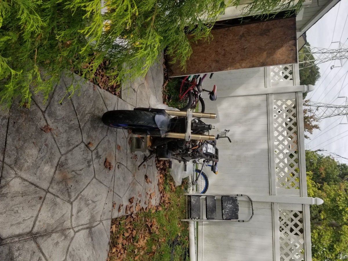

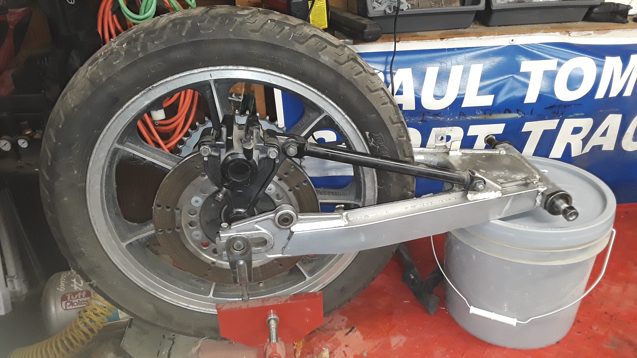

14 Oct 2020 20:43Replied by slayer61 on topic Mrs. slayer's GPz1100 refresh & upgrade
12 Oct 2020 11:11
So, a (very) little progress on Sunday morning before the business of life took over.
Got the forks and front end removed (maybe just disassembled... dammit it's hard getting old). Old forks, removed caps & fork springs. Found them to be progressive & will be tossed or re-purposed into wrench holders in the tool box.
Also managed to get the hideous gauges removed from it. Good riddance to you.

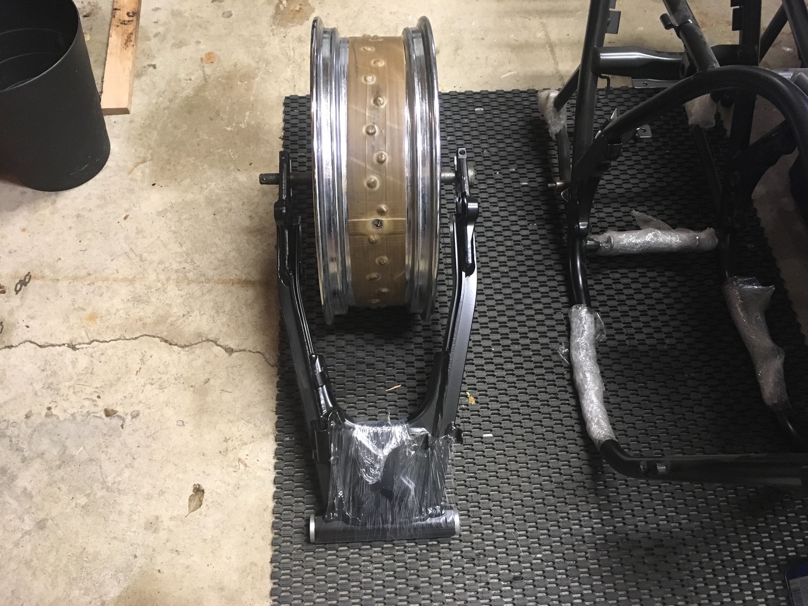

Removed the rear wheel for first mock up with new swing arm
Turns out I'm gonna need the Suzuki axle for this as well as suitable spacers made up.
I was also reminded that I have this left-over Kerker from something..... I wonder.....
