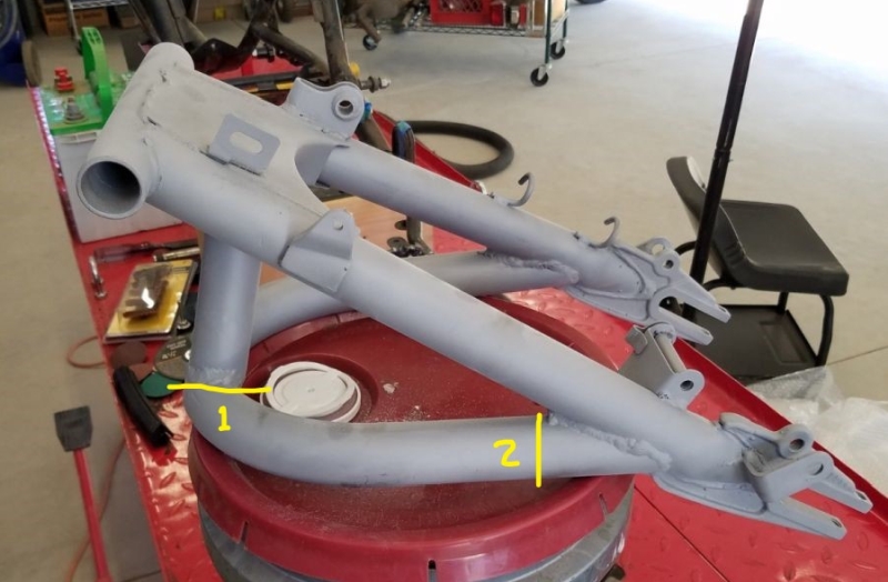

After a lot of thought, here is my plan to modify my mistake on my swing arm. In the picture, cut #1 will go all the way through the tube. Cut #2 will only be part way through, starting on the outside, but leaving the inside edge intact. #2 will be a pie shaped cut. I will bend the tube outward, and insert a short tube section in the gap at cut #1. I am thinking it will be 3/4" to 1" wide. This will move the brace outward, giving the chain the clearance it needs. After welding, it will get ground smooth. Then it will get stripped and re-powder coated. Unfortunately this will cost me four new pivot bearings, as they will not live through the process. I will need to remove the bearings before hand, which will likely ruin them. The goal is to keep the shape of the tube as intact as possible so it doesn't look butchered. It will end up non-symmetrical on the left, but chain clearance is by far more important.
Do not sandblast the inner sleeve. It is a bearing surface and is precision ground from the factory. If you cannot find a replacement polish it with sandpaper as best you can. you do not want roughness here it will prematurely wear the needle bearings.

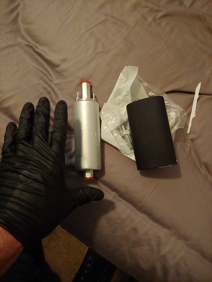

Ordered some new fuel system components as the intank style pump was a pain. I bought a Walbro GSL393 (which is what the 750turbo guys use as a replacement) as well as some other fittings and filters to finalize the mounting of it all: fuel pump, pre (30 micron) and post filter (10micron), flex fuel sensor. The hardest thing to find are some 90deg fittings. ebay had some nice swivel m10x1 to 5/16 barb 90deg fittings, so i hope those hold up as

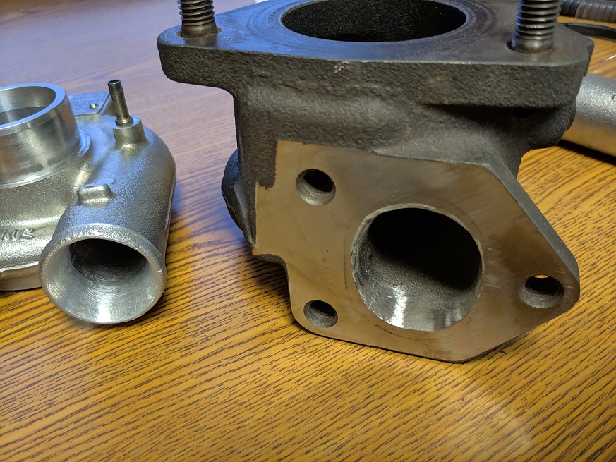

the exhaust tubing (stainless 304 sch10 1" nom pipe) and a few bends has arrived for the turbo header. still working on the turbo flanges and head adapters (Kawasakik1e is helping with these

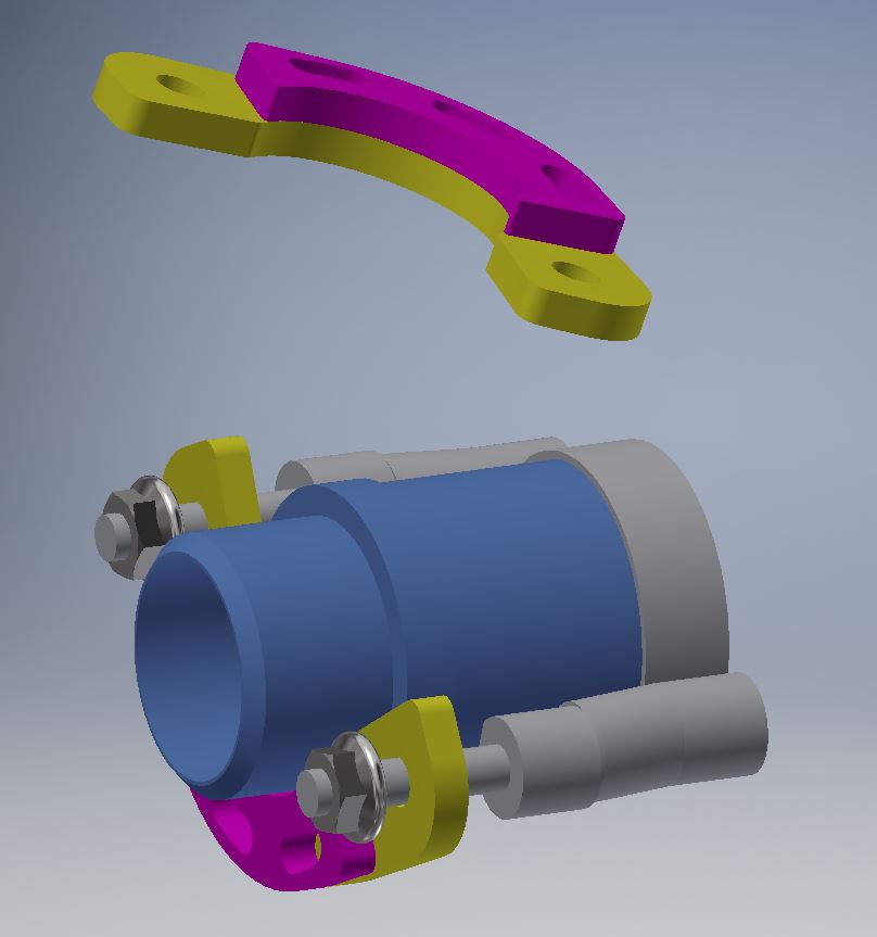

I saw these neato half clamps that a 750turbo guy made....grey part is the kaw cylinder head, blue is a machined piece that mates to the head and is clamped on by two of the yel/purp assemblies.
