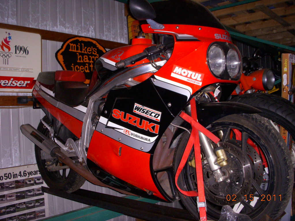

Replied by tk11b40 on topic 1975 KZ 900 , ZRX Swingarm, 89 GSXR front end
11 Nov 2012 14:16
The Project has been on hold for long enough.
Jetting... well there is a dynajet kit to take care of that.
Paperwork for title has been taken care of. I am ready to dig in and take it the last mile. In the last couple of months I have been restoring an 86 GSXR 750 for my neighbor, that project is almost done. Soon as I deliver the GIXXER to California... the KZ will be up and on the bench again.
