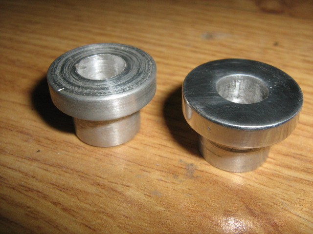

Replied by Arnold on topic Retro Fighter 2.0 (KZ 1100 -82 goes Z1 clone)
27 Oct 2013 11:52 - 27 Oct 2013 11:56
Crap...just lost a logn post !
Anyway...thanx for all the nice words.
Here´s some pic´s of the last days progress.
Old swing arm attaching brackets.
Made some new bushings to center the new bolt.
Drilled two new holse to make the rear end 1 inch higher.
New oilfilter installed
Yellow paint marking that bolt is tightend propery.
