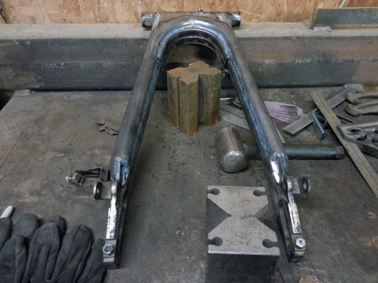

alright well we have generated some forum activity.
!Seymore ,
while i don't have the actual ground clearance measurement.
it was measured off of my own swingarm which uses the same rear tire size and has shown to be fine in use.
FaultedGeologist,
i stated my reason for posting pictures here of some of my work in the first post.
to bring some more fabrication and generate some forum activity.
as,
i would also invite you to post pictures of your work and projects and especially anything that makes you believe you have any kind of a base to offer advice.
i did not post them here for your or anyone else's approval.
as for the upper shock mounting crossbar it is strong enough as it is to withstand normal road use.
but that's neither here nor there as bracing has always been a part of the plan,and it wont be used like this so neither your nor i will have the opportunity to be proven right/wrong.
i have fabbed a few underbraced arms before and have a good grasp of what it takes to pull them off.
here is one i did for doug,
here is one for tyler,
here is krazyriders,
here is craigs stealth overbrace,

Replied by FaultedGeologist on topic kz750 custom swingarm fab
27 Oct 2014 04:23!Seymore wrote: What's your ground clearance, under load, at the brace in the swingarm? Looks really low...
I also think it may be close when under load, plus the top mount for the springs needs a brace. Hit the gas and the forces will flex it even more... Hit a bump and bottom out or break that brace.
Apparently, Leon was only here for some back patting. No constructive critique allowed from the community. We gave input because it was requested. Moving on...
