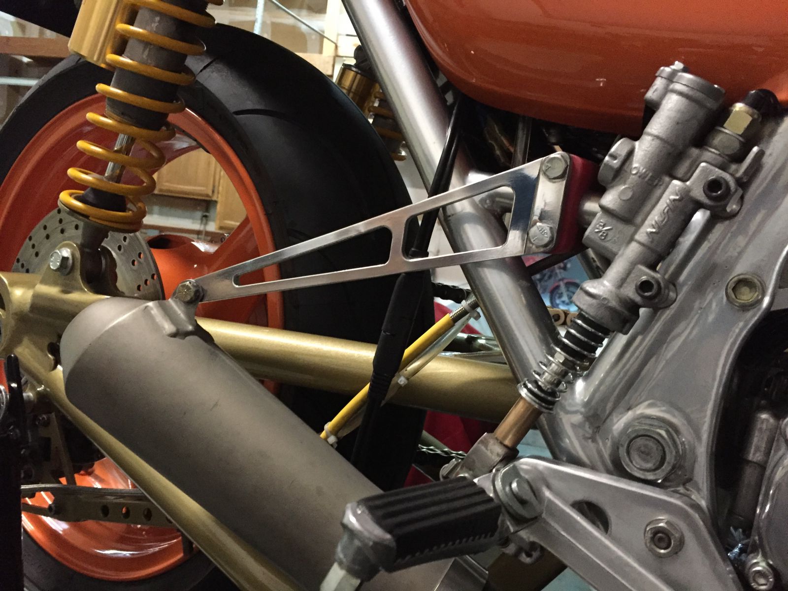

Replied by tk11b40 on topic 1975 KZ 900 , ZRX Swingarm, 89 GSXR front end
09 Feb 2016 16:59
OK when you are ready !! We'll get a damper on it. That hanger is beautiful.
