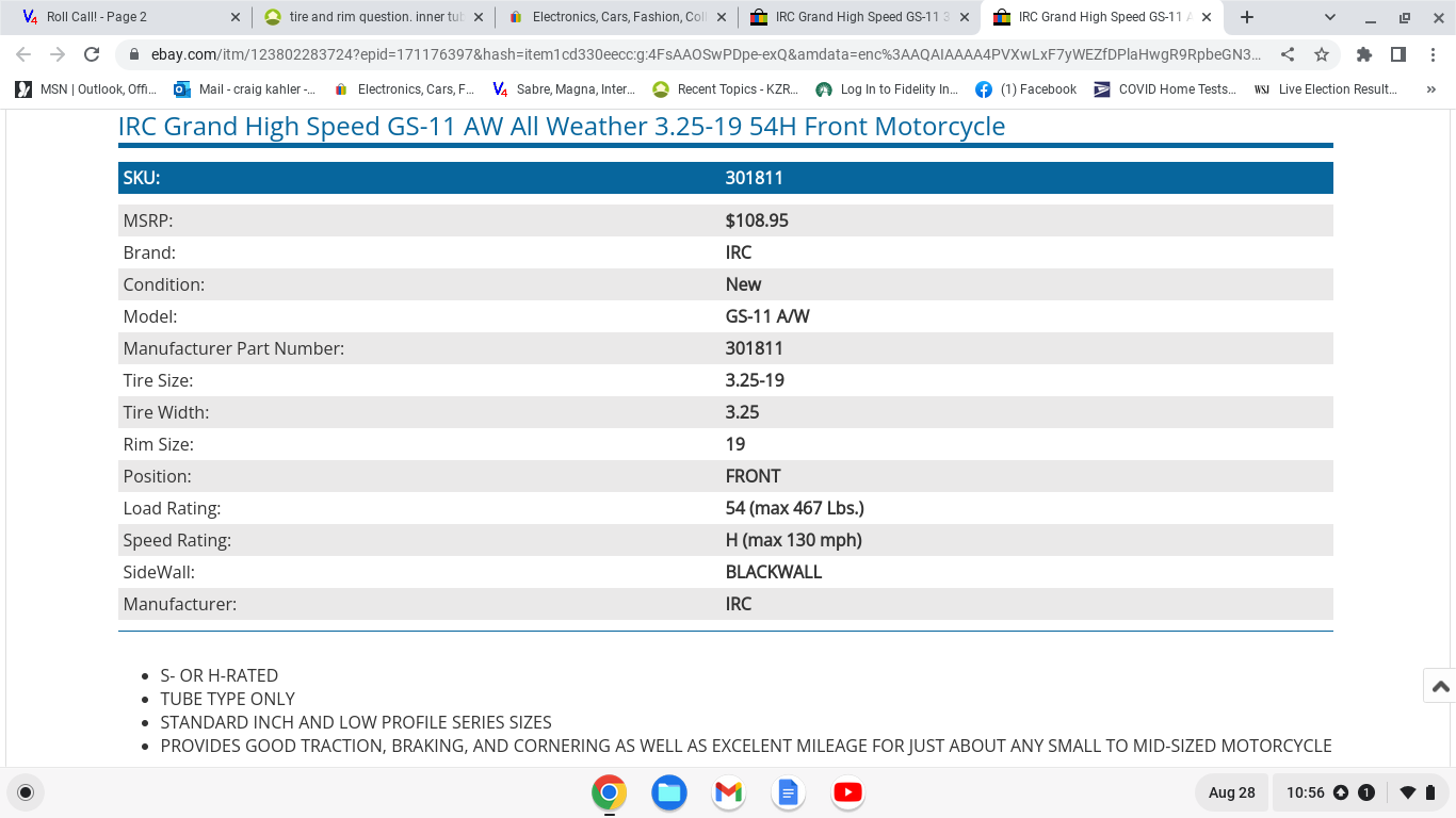

So is it controversial to run a tube type only tire without a tube? This is what is on the bike now with no tubes.

Thanks for all the replys/opinions. Since the bike came new with tubes, I will get some tubes and and reuse the existing tires.
