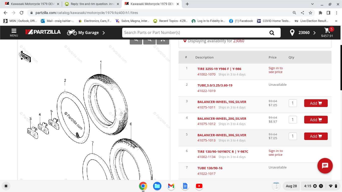

My recently acquired 1979 KZ400h LTD has tube type tires mounted on cast wheels, with no inner tubes. I have been having to add air every few days, and have found the cause has been air leaking around the rims. I have always thought cast wheels took tubeless tires and do not require tubes. However, Partzilla is showing inner tubes with these wheels.
So what are the rules.
Can I mount tubeless tires without tubes on theses wheels? Or tubeless tires with tubes? Or tube tires with tubes?

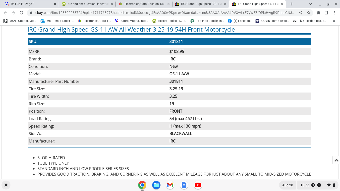

So is it controversial to run a tube type only tire without a tube? This is what is on the bike now with no tubes.

Thanks for all the replys/opinions. Since the bike came new with tubes, I will get some tubes and and reuse the existing tires.
