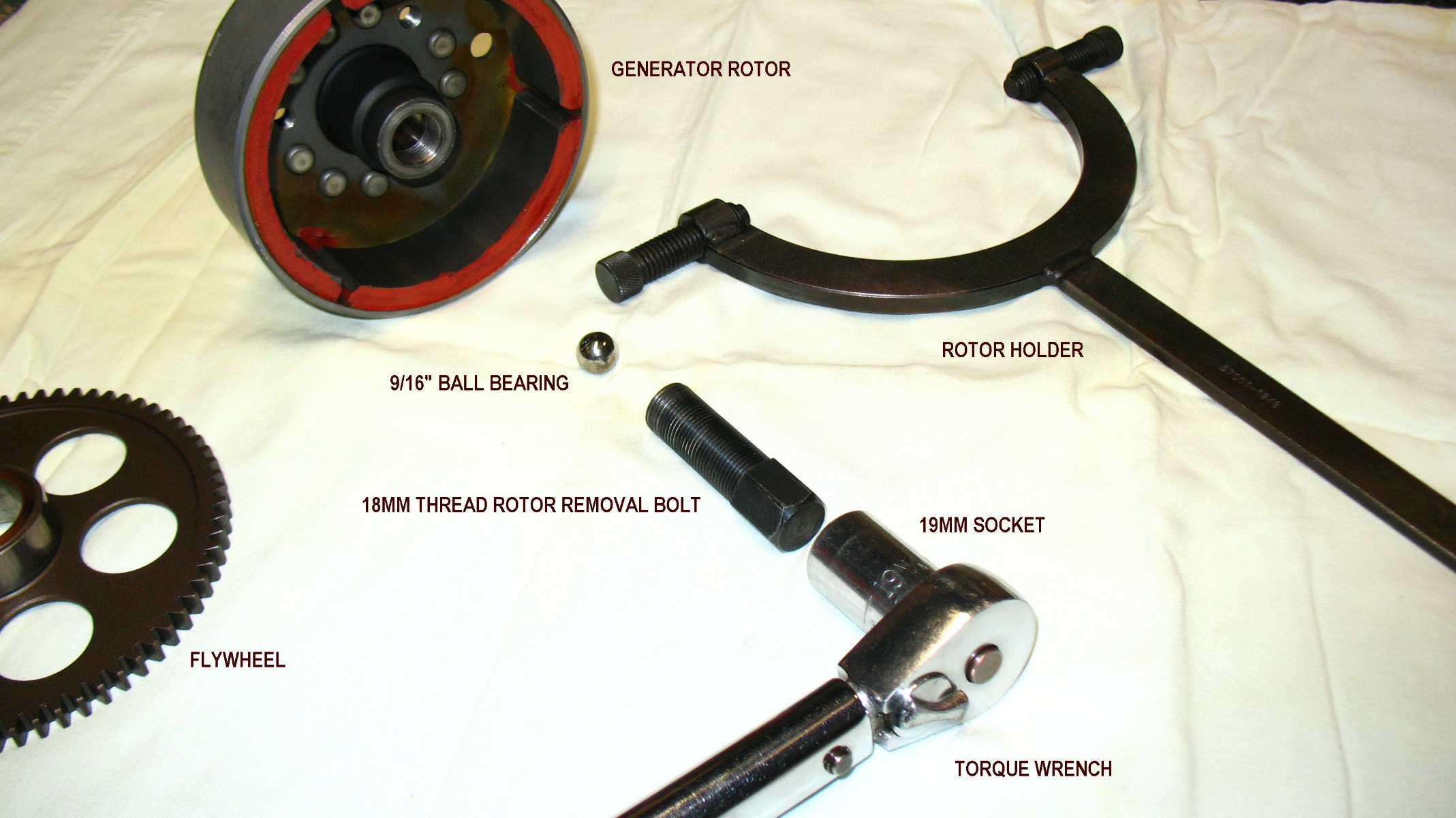

If the starter motor is your problem, then you will be happy to know it is a pretty easy component to remove and work on.
...but if the problem involves the starter clutch-flywheel assembly being too-tight against the engine (rubber spacer too thick), that will be a completely different situation.

06 Nov 2021 21:19 - 06 Nov 2021 22:35IMO, study the Kawasaki Factory Service Manual on this subject before proceeding. Use tools made for the job, and do not waste a penny on alternative methods.This sounds like what he's talking about. He mentioned today (he towed the bike over to me today) that to fix it I'll have to get the puller tool for the flywheel, which suggests to me that it's the starter clutch not the starter motor.If the starter motor is your problem, then you will be happy to know it is a pretty easy component to remove and work on.
Correct tools make this job simple by comparison, and the potential for damage is minimal.
Tools I find useful:

Just looked up the rotor holder tool on ebay... the only one I can find is NOS, for like $200 plus shipping! There are cheaper "universal" ones that claim to fit the bike, but they look entirely different like this www.z1enterprises.com/yamaha-xs650-clutc...et-holding-tool.html Would that be an acceptable substitute? I don't see how it would work anything like the one you showed, but I've only ever even been in this part of the police version of the J model engine once to replace the stator (bigger stator than the standard J stator, and I know this cuz I bought a J stator and it was smaller than what was in there, so I had to buy a second, police version). I just don't think I can get the money for the OEM tool saved up before it disappears from ebay.
The removal tool isn't too badly priced. Is the Motion Pro one ok? www.amazon.com/Motion-Pro-08-0116-Flywhe...ternal/dp/B009J7O7J0

Yeah, I have neither the skill nor the equipment to fabricate one...
