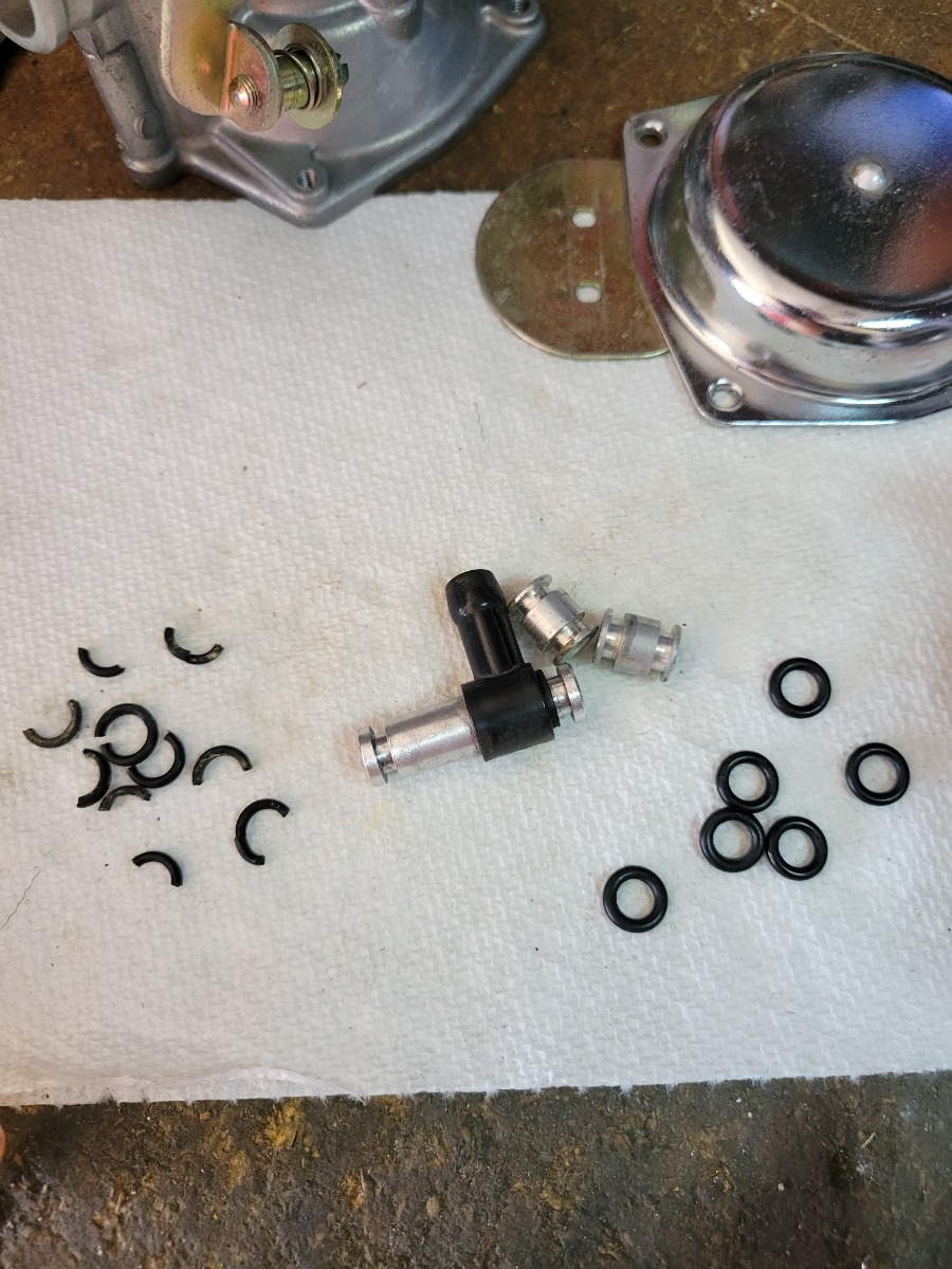

Keihin CV34's from a 750E.  The interconnect tube O-rings just crumbled when trying to remove them.  Hard as a rock too.
Soft fresh O-rings to the right, waiting their turn...
