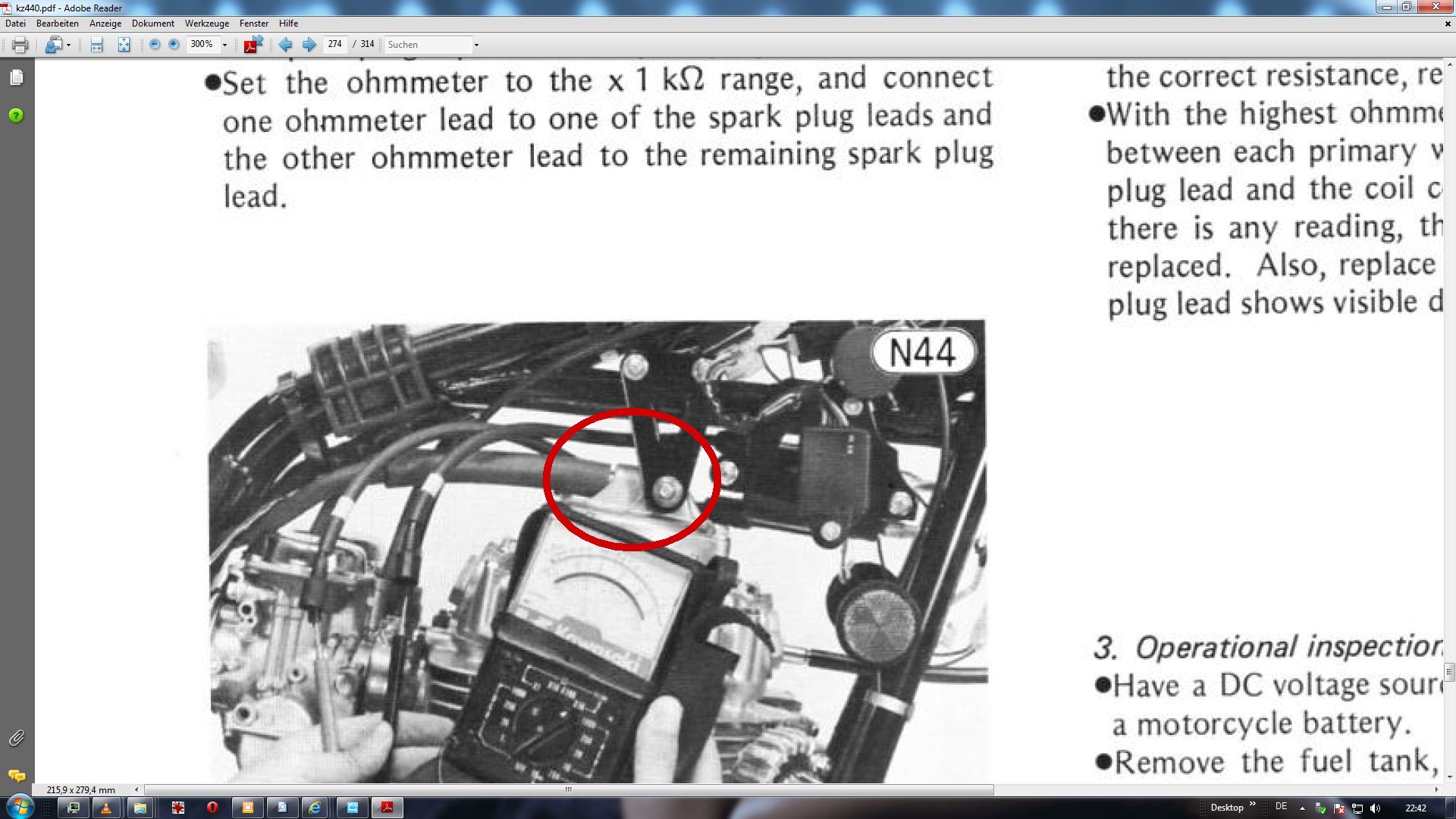

Does anyone know if the rubber boots were the inlet duct 1,4 part # 11015-063 or inlet duct 2,3 part # 11015-057? Also when installing these into the box, how well do they fit? It seems like they could move in and out, or is there a securing mechanism I didn't see?
At least from what I saw, you just cut a hole and fit the smaller end of the boot in and that's all (?)
Also, what is the tube at the top??

The tube is for the engine vent and is connectet to the valve cover.
