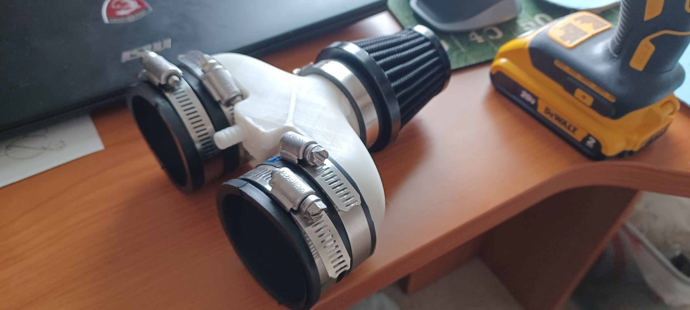

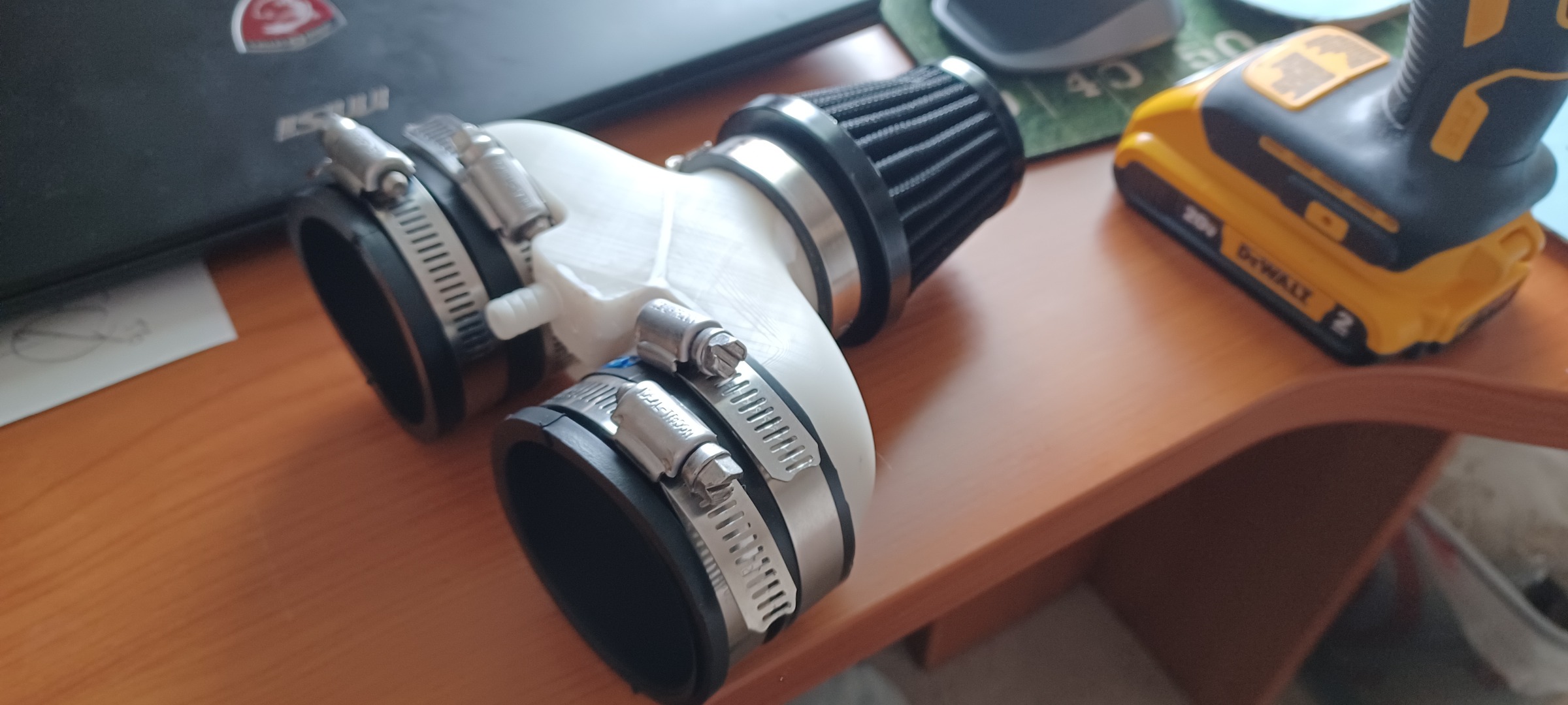

I took inspiration from this thread and designed a 3d printed an airbox. If anyone wants to make one, the file is here:
cad.onshape.com/documents/90529535924d74...1e1da65dfb476e2aa3d9
i used a 2" fernco ($6 at the hardware store), cut in half as the boots. You can either rough up the fernco (flexible PVC) and use superglue, or just use a second gear clamp- i tried both and they both work well.
$20 of plastic sure beats buying an airbox that's older than me of ebay for $100s...
this thread took my un-useable new (to me) bike and made it run perfectly (as best i can tell, its my first bike). I did increase the pilot jets to #38's before replacing the pods with this intake, and have them still fattened up. I put an O2 sensor on the bike, so i have an OK idea I'm running well thru the ranges despite my complete lack of experience with motorcycles or carbs in general.
Thanks for everyones input in this forum, you've collectively saved my tons of time and money.
-Michael.
-Michael.
Last edit: 08 Nov 2023 16:20 by Street Fighter LTD.
The following user(s) said Thank You: JR, TexasKZ, Wookie58
