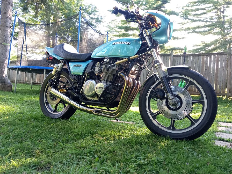

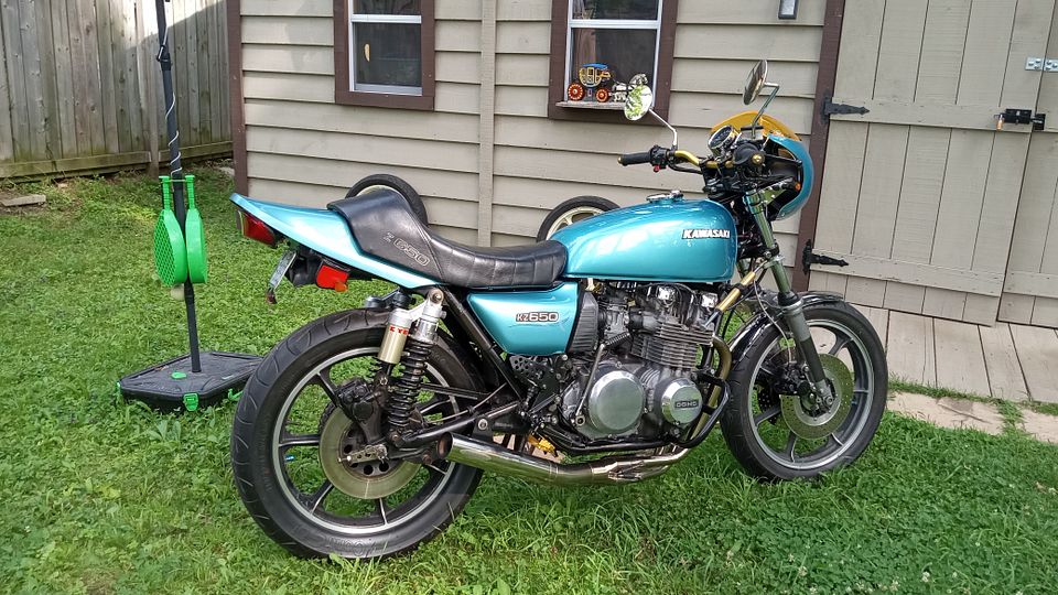

I have ZRX1100 shocks on my KZ650.
They are almost 2 inches longer than the Koni shocks I had on before.
I had the front end lowered for years, forks slid up in the triple clamps, so moved them back to stock height.
Also have an 18" front wheel, so that must lower the axle 1/2".
First few rides I could feel a little difference; the bike sits higher and corning was different, but now after many rides she feels normal.
My ZRX got Ohlins rear shocks.
Noticable improvement in ride over the stock shocks.
The front end needed some help, and adjusting them with the help of Steve who sold me the Ohlins helped.
Both the KZ and ZRX will get some front end attention this Winter, RaceTech Emulators and rebuilds are in the plan.
