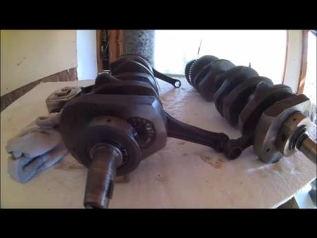

Pics of the rods? Mine were a little discolored on both cranks but the pins were nice and snug. My 903 crank was $50 plus shipping after I took a close look at it and the others. 4 years later it's still going strong even after wasting #1 piston. The wrist pins seem to take most of the wear.

Steve, I’ll try to get some closeups of the rods. What you mentioned worries me, snug. I have wrist pins that are within spec and when test fitting them to the rods I have wiggle. I only find spec and out of spec sizes in the FSM. I have a digital caliper and can size the pins. But I don’t have a bore gauge to size the rod. The FSM doesn’t give me a wiggle tolerance and not experienced enough to judge wiggle. I think I’m forced to find a reliable shop that can size the rods and tell me the results. Unfortunately in the current crazy Kz boom (price gauging) $50 crankshafts are a distant memory.

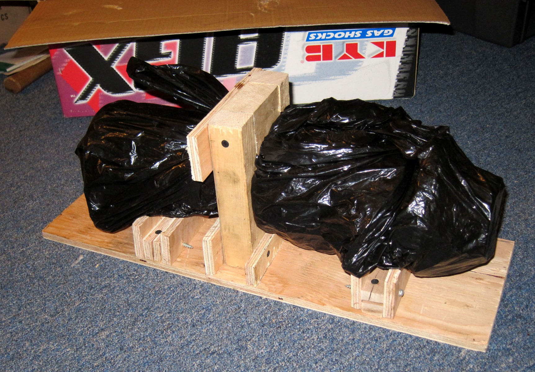

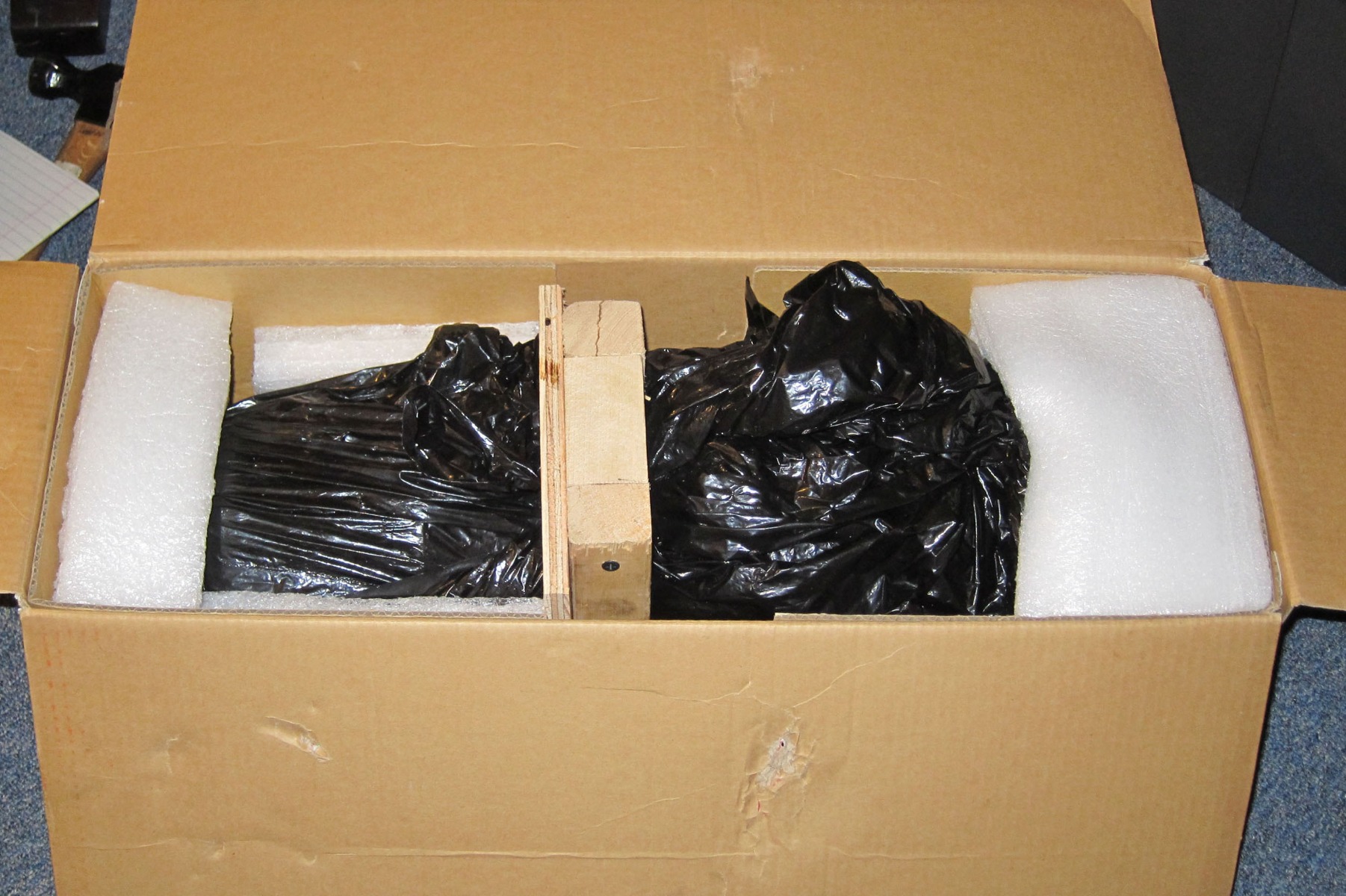

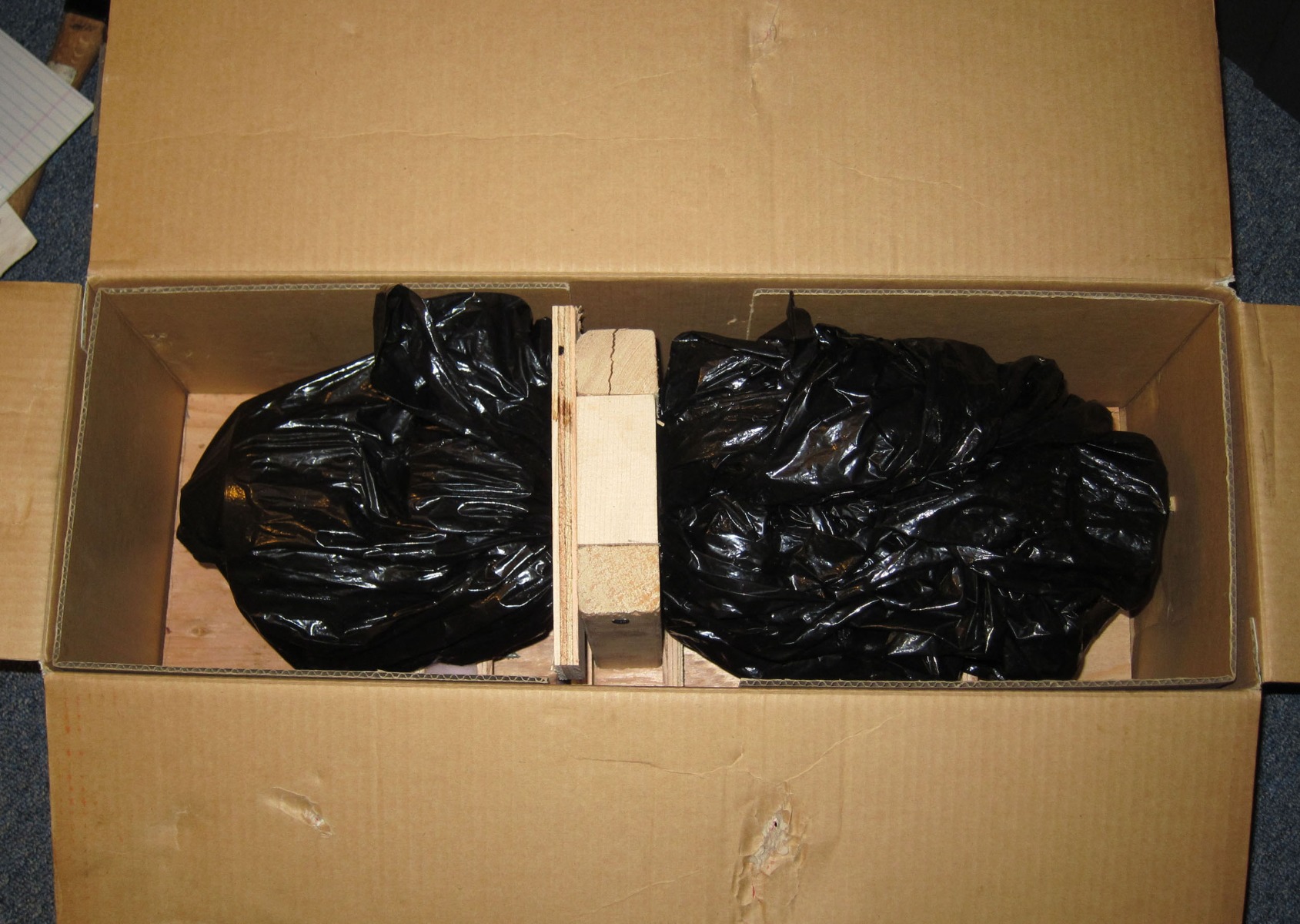

09 Jul 2021 11:17 - 09 Jul 2021 11:46It's a 4+ hour drive from me, but still much closer than Maine. I sold a crank on Ebay about 10 years ago. Packing it up for shipping was a ton of work. Also, the crank and rods/bearings weigh over 50 lbs. If feels like it's bolted down to the table when you try to pick it up.This is the best bet and not to far for a road trip
I had a very sturdy double walled box from some car shocks. I made a plywood base that just fit inside the box, and then built up pads to support the crank at the bearings, and screwed blocks over the top in the center so it couldn't roll around. Then I packed the box with foam. It's probably one of the best packing jobs I've done. It was so heavy, I was really worried that if I didn't bolt it down in some way it was just going to explode out of the side of the box like the Kool-Aid man.
