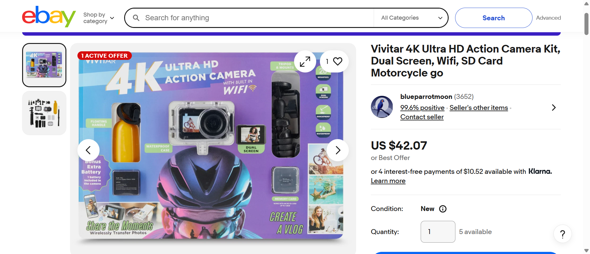

Any suggestions / recommendations, maybe on the ebay plattform?...it´s just an idea, when i sit here in the off-season and thinkin´about my future rides i will do this year

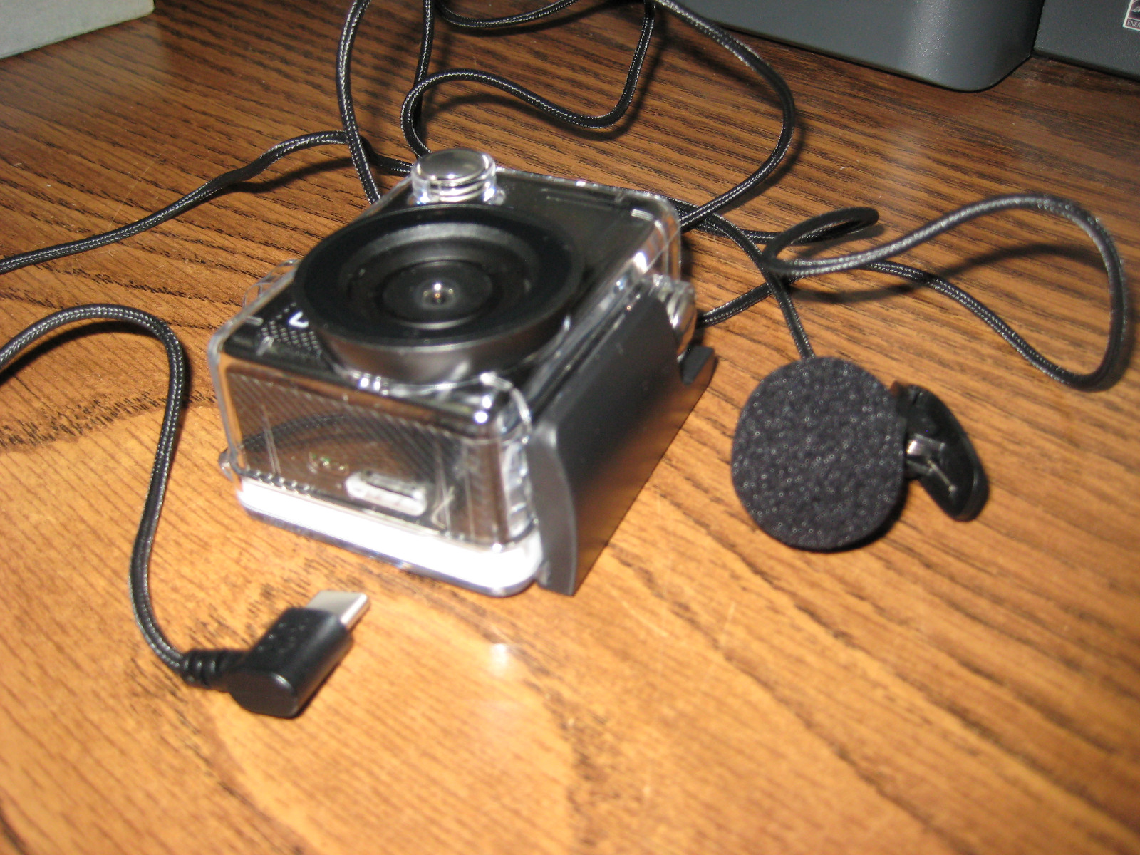

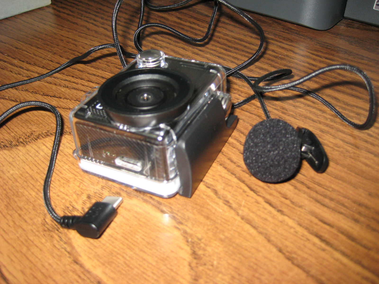

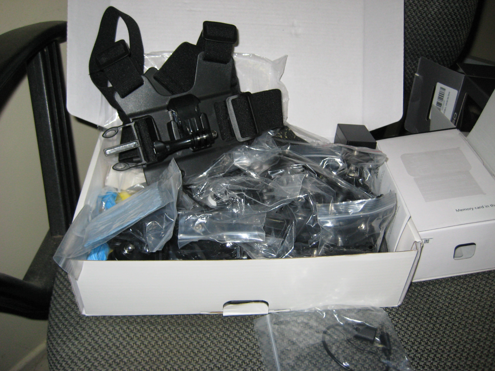

I recently bought one of these GoPro clone cameras to video my AFR gauge when I am riding to try and tune my jetting.

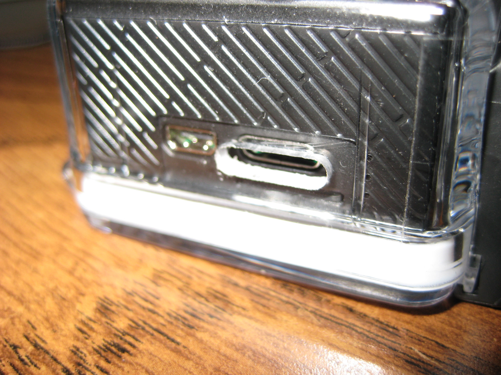

I plan to mark off my throttle and call out the throttle setting thru a microphone under my helmet. The base camera did not come with the external mic so I had to buy that separate. The waterproof case did not have a slot to run the mic plug into it so I cut one on my milling machine with a 1/8" end mill.
I bench tested the mic with my helmet on and it works as it should. The real test will be on the bike.
I am not sure if I am going to use a tank bag mount or a chest mount harness. I have both options with the accessories kit.

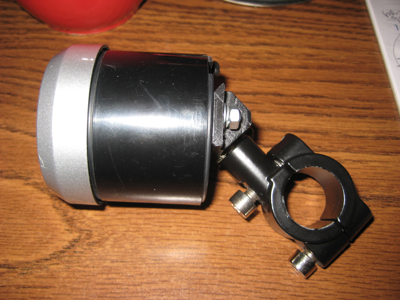

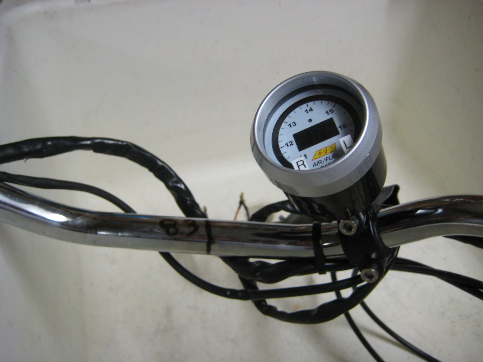

The AFR gauge is meant for car use so I built a housing and handlebar mount. I want to be able to zoom into and film that aguge face while calling out my throttle settings.

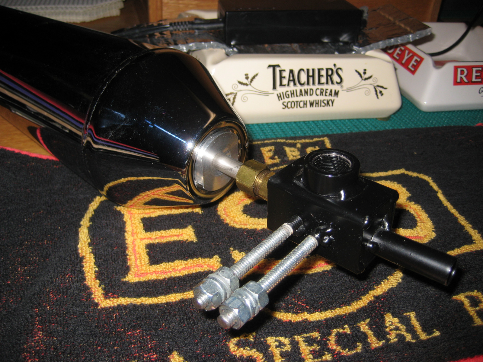

The O2 sensor I am using is going to be run on the back on one of my muffler tips (dual exhaust) I built a housing for it to screw into and a bracket that mounts to the frame.
I know this is not a perfect solution to tuning it but its a compromise and will get me in the ball park as far as jetting a unusual combination (VM33 Smoothbores with a air box)

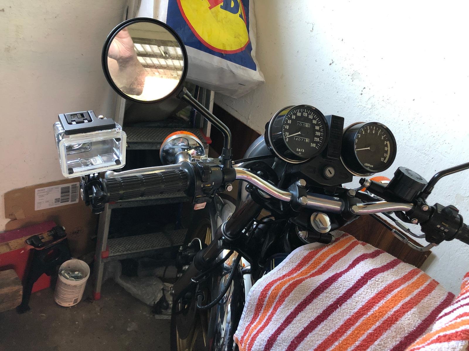

I recently bought one of those "cheap" cameras in a transparent plastic case for next to nothing. I attached it to the left side of my handlebars... surprisingly, it does everything it's supposed to, takes pretty good video recordings... it's fun, and I can view and save the footage directly on my PC via a card reader using the small chip card. It even has sound. The only problem is sending it by email; the recipients can't open and view it. ;-(
