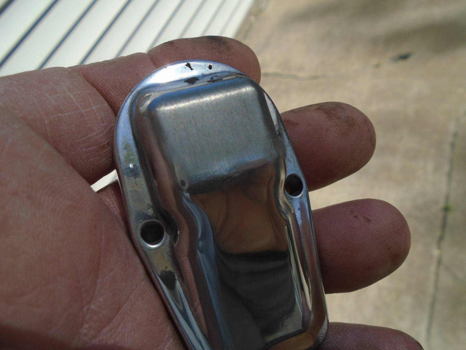

I'm a big fan of black cutting compound and a sisal wheel. That brings the brightness up to OEM level.
If the part is heavily corroded, you have to remove the pitting first, though. A DA sander with 220 grit paper works well for larger parts like side covers. Or, a 3M deburring wheel on a grinder/polisher will work even better. In fact, I often stop there, and the part looks sort of brushed finished.

Repeating myself, sorry, but these side covers were sanded with a DA and 220 grit sandpaper. Then, a sisal wheel on a car polishing motor, with black cutting compound. Some heavy pressure is needed to get the results shown, but no big deal. The polisher was loaded up, but didn't really complain much. Shine is NOT chromelike. Like OEM level of shine.

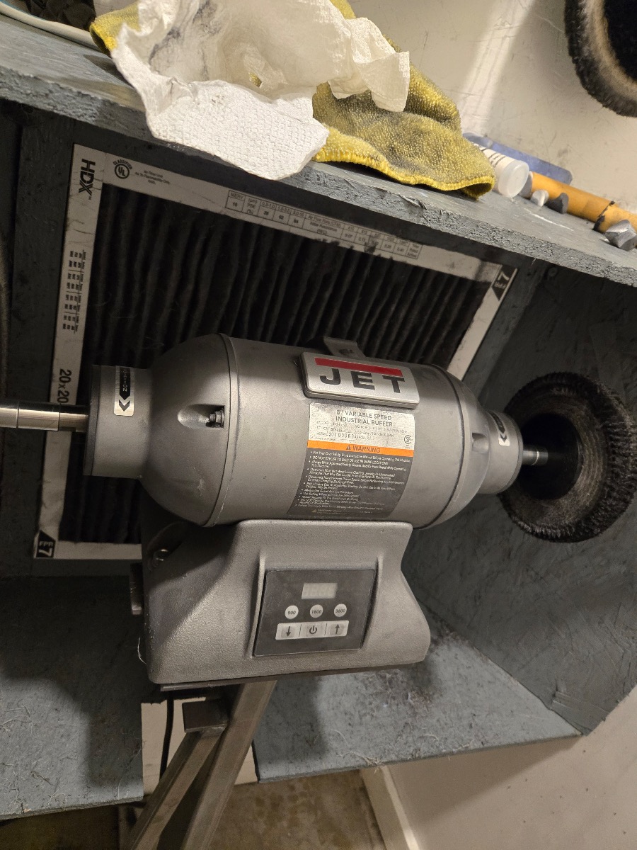

When my old buffer failed I bought this Jet variable speed buffer for my dedicated buffing room. Best investment I have made. Has a slow enough speed to polish plastic if needed.
