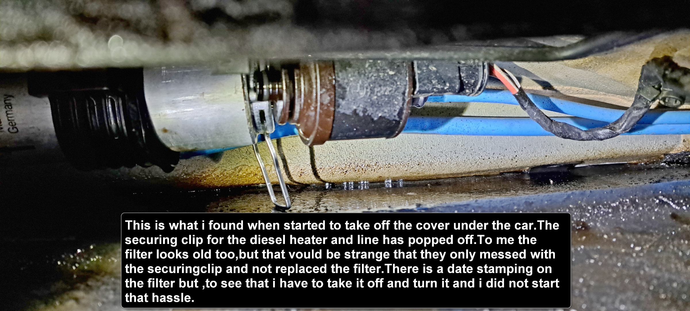

A few days later they still did not show up and i started to take a closer look and took off the coverplates for the diesel filter .Very funny job in -15 degree celsius lying flat in the gravel and no workspace.I found the diesel filter had came lose from the preheater because a sloppy job replacing the locking spring.
At that moment i just did not try to fit it because im sick and it is very cold.Then i called the dealer again and told them that if they send a mechanic and he connects the dieselfilter there is no need to tow the car.They agree and they should send a man. The days goes and i got real frustrated and did the job myself.That almost gave me a heart attack again.I had 3 heart attacks before

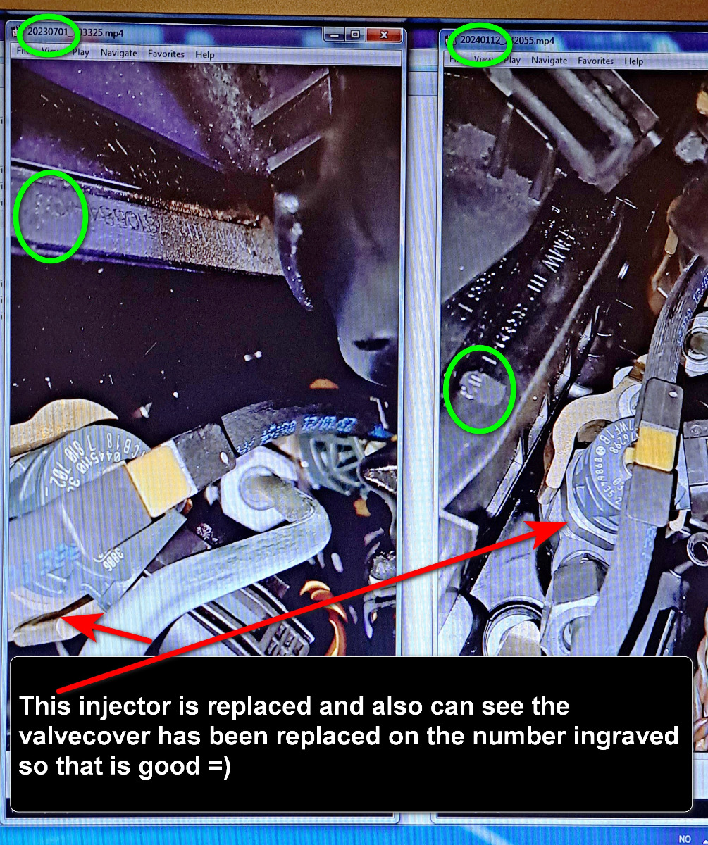

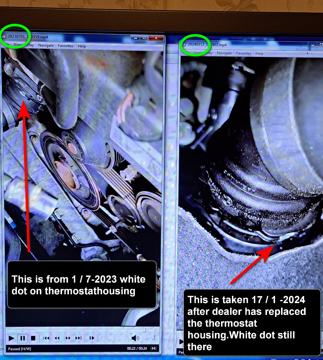

Now im really pissed off because i also discovered that they had not replaced the thermostat housing as they made me pay for.I know that because in july i did a big service on the car and took some videos down in the engine compartment.On the video there is a white paint spot on the thermostat housing and that is still there so they have not changed that.I then started to check more and took off more parts on the engine to se if they have replaced the injector.All looks new in there, but i can see that they actually have changed one injector ,but i am 100% sure it was not neded.
