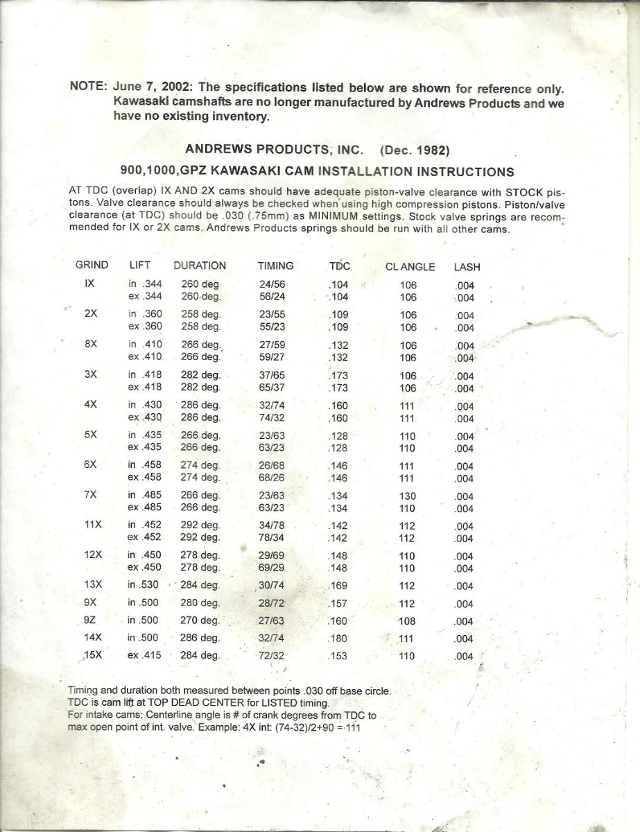

I just picked up a parts lot. It included 2 camshafts. 1.) Web 110 intake .395” lift
2.) Andrews 2X exhaust .360” lift.
My question is. Would these have been used together? Could these be used together? Or am I stuck with them till I can find each a match?

08 Dec 2022 20:46 - 08 Dec 2022 20:56Duration is basically the same. I'd run the pair.Question for the engine builders.
www.webcamshafts.com/pdf/catalog.pdf
