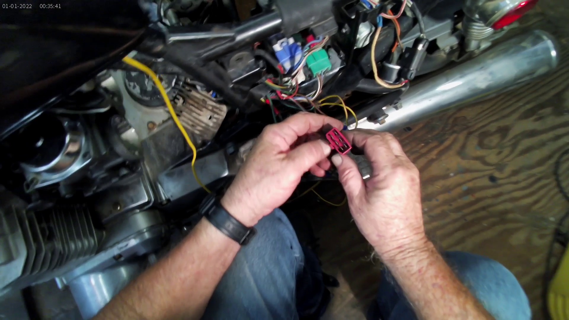

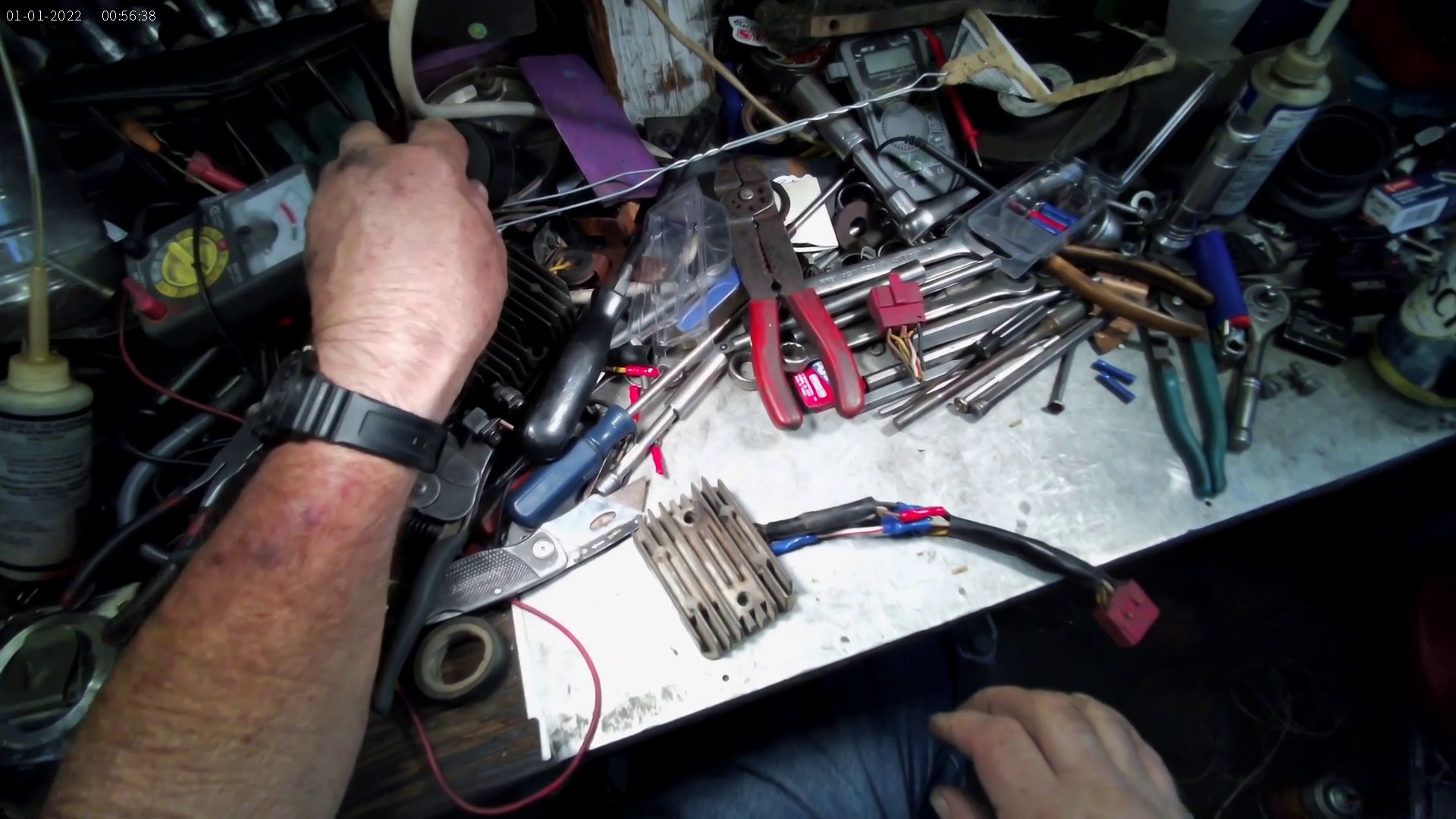

Good thing I bought butt connectors just to have on hand.
rumble.com/v5335b6-wiring-the-new-rr.html

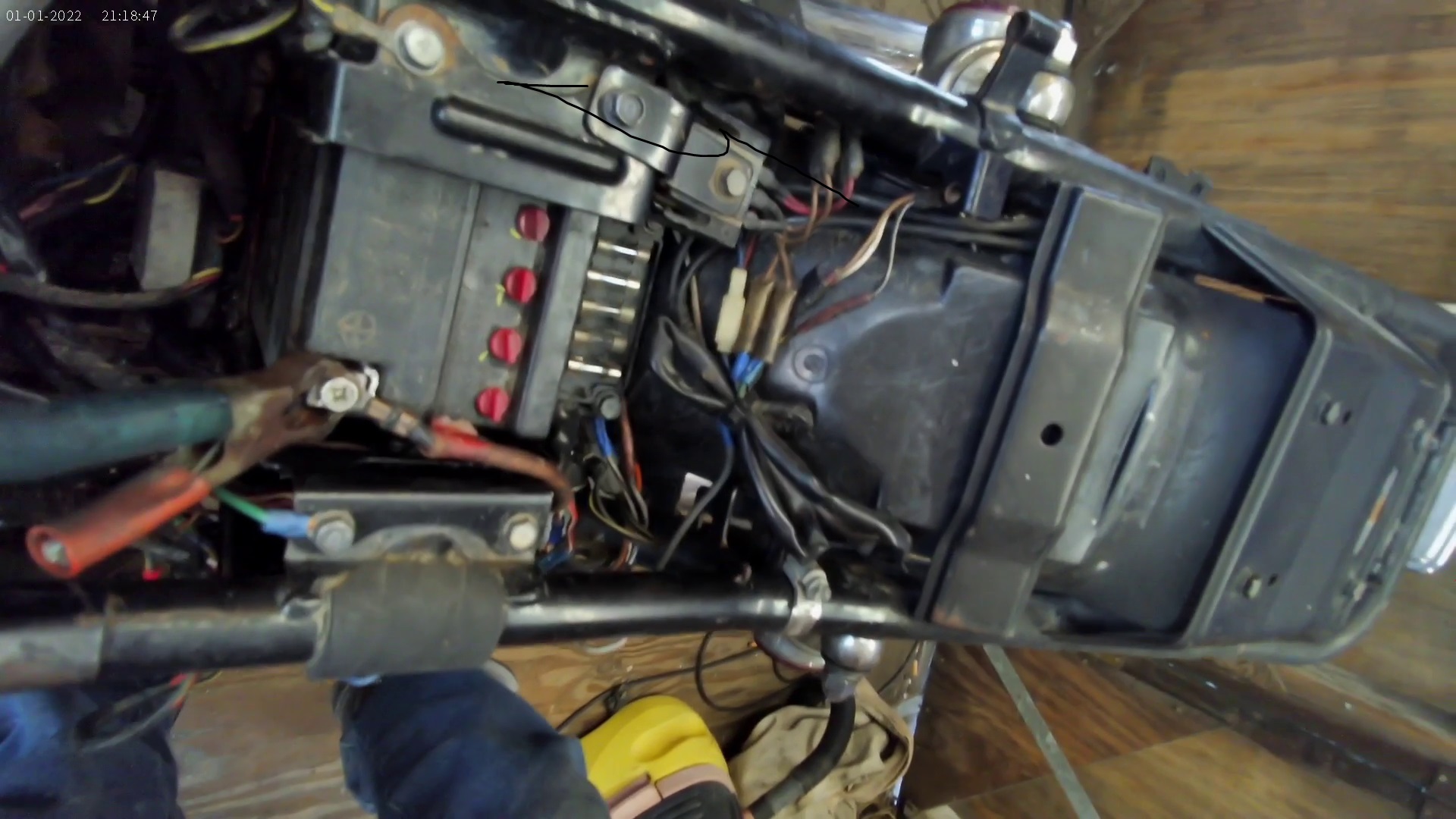

22 Jun 2024 12:52
Best to stagger your splices if poss, otherwise you will have a loom that looks like a snake that swallowed a goat (big bulge)

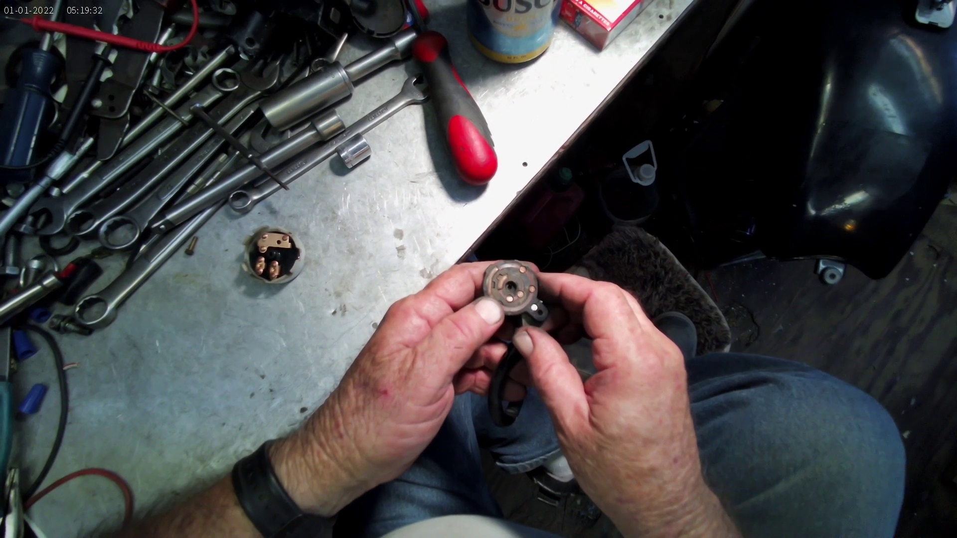

Have not watched all videos but if the problem is that the plugs dont spark it can be a fault with the sidestand switch or the fuse for signals is blown.
That is a safety thing i think .Once my fj1200 cranked but no spark then it was a fault in the sidestand switch.Another time it canked with no spark it was a short in the rear brake light wiring shorting to frame so the signal fuse was blown.

23 Jun 2024 13:49Not exactly because if sidestand down the starter does not operate .But if sidestand switch is bad i can crank with no spark for some reason. and if a blown fuse to the signals on the fj it cranks but does not spark.
It may also be if your bike has a clutch switch that is bad it cranks with no spark.many strange safety things !
maybe try to jumwire the switches just disconnect one by one and put a little piece of wire in the connector
Wookie should maybe have better advice

23 Jun 2024 14:16

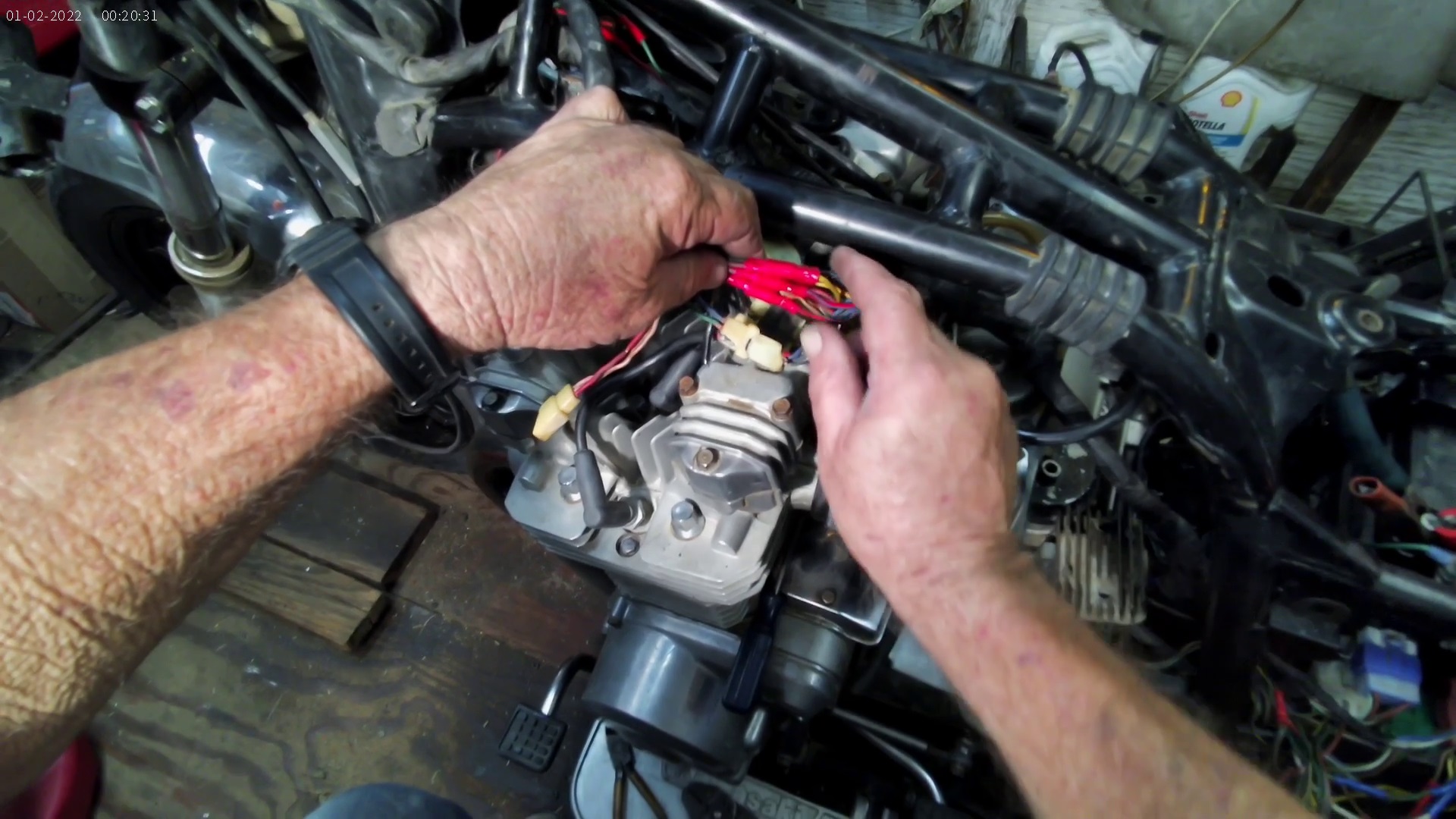

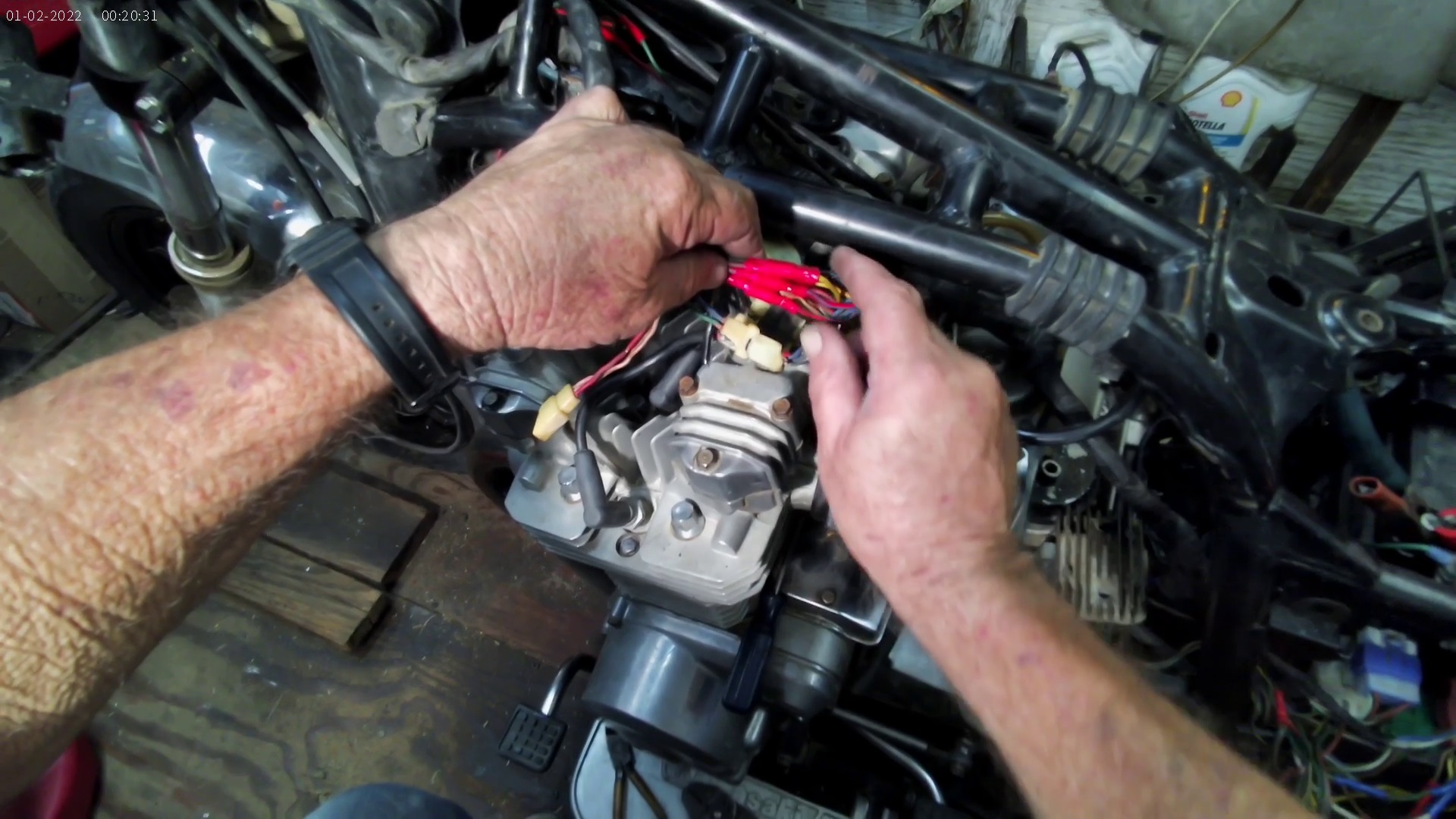

Been going one by one through the bad connectors.
rumble.com/v53az1h-changing-the-middle-connectors.html
