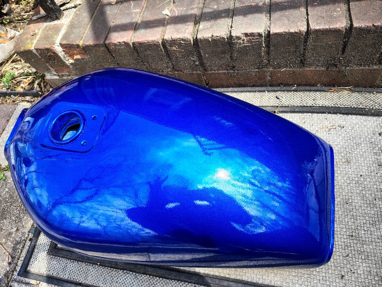

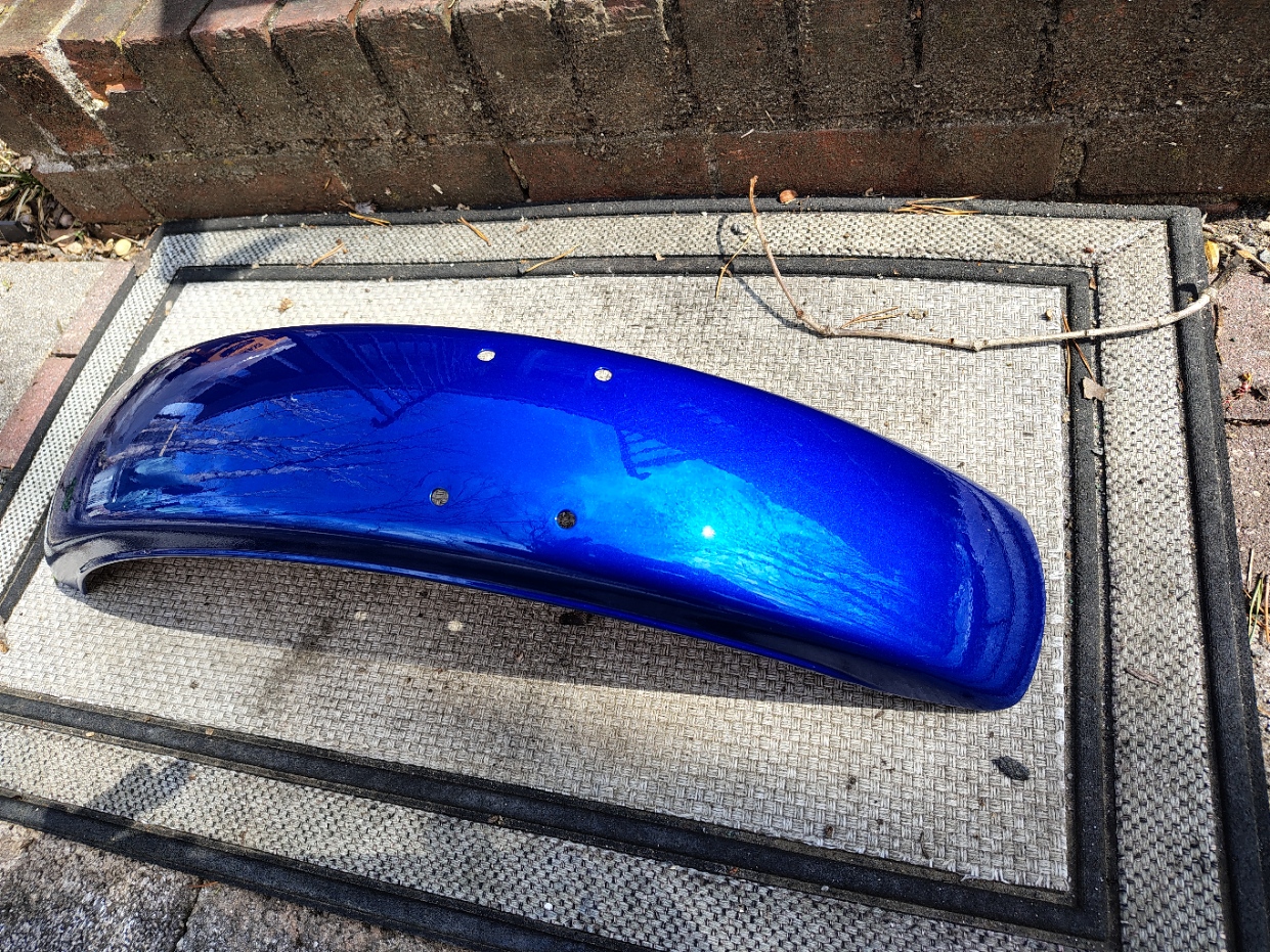

19 Mar 2026 11:09These are unpolished and unstriped. This is my first attempt at this fancy painting technique. The tank has some orange peel that I'll deal with later.
Next step is to lightly sand the area where I want to put the pin stripes, apply them, and then clear coat over top all of it again with several coats. Since I'm using 2K clear, I have to use the whole can up at once on these projects since this stuff is expensive.
