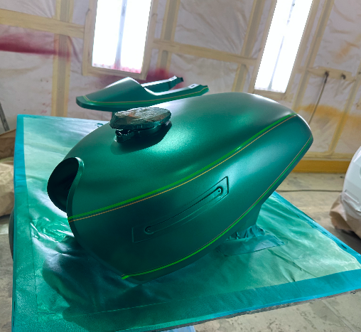

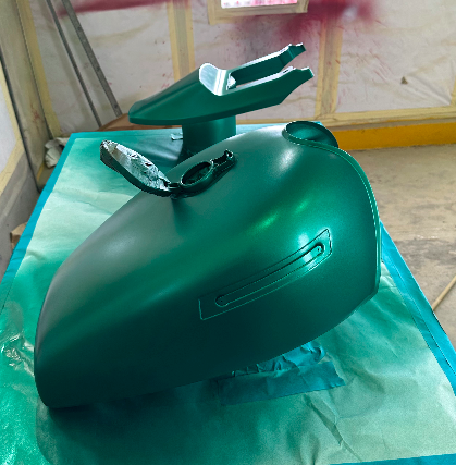

Re: Questions for a Painter: KZ Tank and Rear Fairing
05 Apr 2023 16:13 - 05 Apr 2023 16:19
I would remove the fuel cap or let it stay open full covered in tape. Paint and primer dust can clogged the vent.
Dont paint the fuel tank opening and fuel cap gasket surface or the E5/10 fuel will destroy the fresh paint like a paint stripper.
You need a small bare steel barrier where the fuel can vaporised before it get in contact with the fresh paint!

05 Apr 2023 17:31 - 05 Apr 2023 20:05I would remove the fuel cap or let it stay open full covered in tape. Paint and primer dust can clogged the vent.
Thanks. Im out of the country (caribbean) from tomorrow morning until Monday afternoon so I wont see the painter until the tank is finished. I guess I will have to clean the vent if its clogged, when I get the tank back.
Last edit: 05 Apr 2023 20:05 by DanMadBoy.

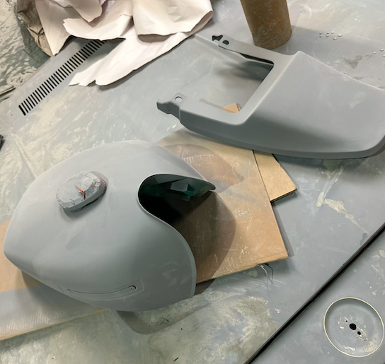

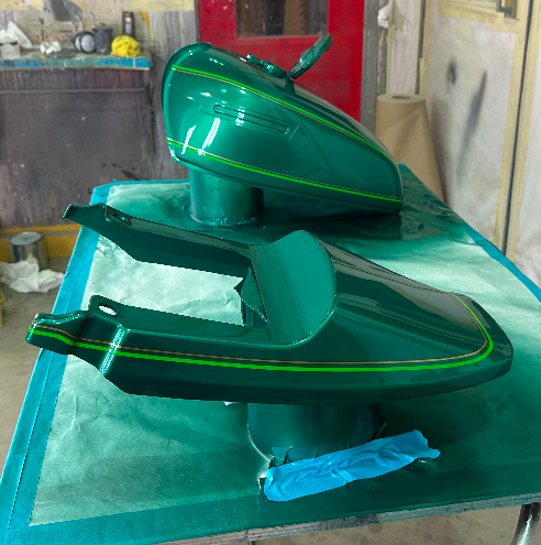

07 Apr 2023 16:01all done1. It is best if the metal is in good shape, not dented.
I will fill two small dings beyond that time for new parts.
Let them do whatever they want.
2. Typical is two primer coats, two base coats, two mid coats, two clear coats.
Painters may have a formula that works best for them.
2b. Most three stage systems are urethane, there may be others.
3. Usually two.
3b: Kawasaki used three stage systems, base, mid, clear, you need three stages to get anywhere close to factory paint.
4. I prefer all paint under clear, some painters may add stripes on top of clear coat.
5. Hiring someone to paint a car or motorcycle is like gambling in vegas
Unless you have dealt with this person before anything is possible.
6. $600 is peanuts for a nice three stage paint job.

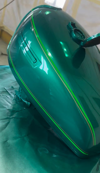

08 Apr 2023 16:11 - 08 Apr 2023 16:12I would remove the fuel cap or let it stay open full covered in tape. Paint and primer dust can clogged the vent.
Spoke to the painter today. Though the final touches were mostly done yesterday, hes going to take the paint off the lip/lid as he always planned to do. I was going to get it today, but he adivsed to let the paint and clearcoat settle a bit, let him clear the lip, and that I should pick it up Monday.
I cant wait. He did an AMAZING job!
