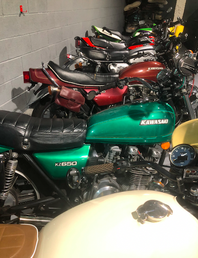

Ive got a lot of bikes. I take care of them all.
