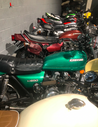

I have stock paint KZ650 B2 and KZ650 C2 tanks (never repainted) and the striping is definitely under the clear coat, can't get a finger nail to catch on it.
Your "research" seems to be flawed.
1978 KZ650B2 modified project

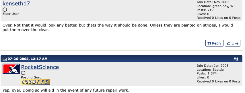

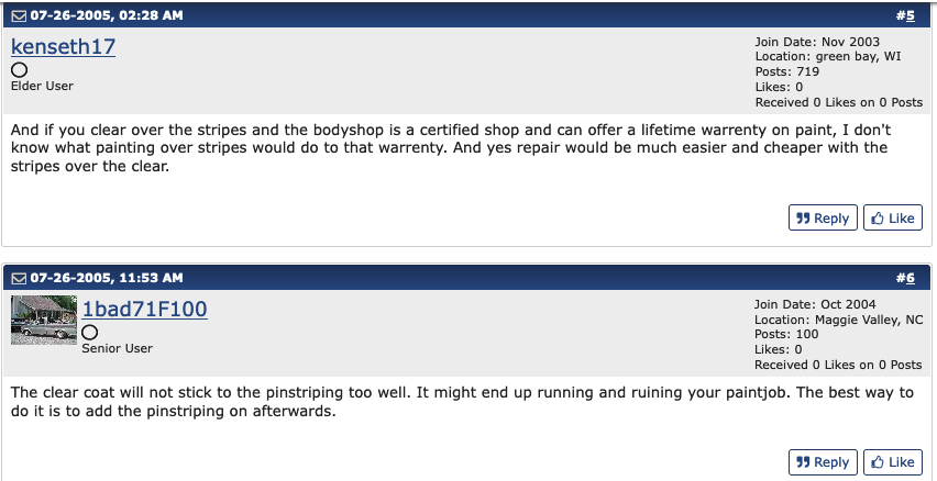

Several notable vintage car and motorcycle painters have said they prefer to put VINYL pinstriping OVER the clear. This from 2005 but there are TONS of the same comments made from then until now.
Thats what Im doing. BOOM!
