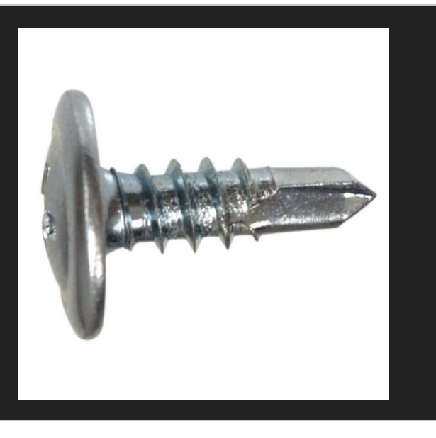

I’d like to add one other trick to the above great methods. Go to your local hardware and get a couple one pound boxes of truss head metal stud framing screws. See stock photo pulled from the internet. Add them to a half full tank, make sure it’s sealed off and shake, shake, shake till your arms want to fall of then shake some more. Pour out And strain out the screws. It helps break up any solidified solids, and breaks the rust loose.
Site wouldn’t let me add the attachment.
Bill fixed the attachment issue. Thanks bill.

03 Jan 2023 13:59I’d like to add one other trick to the above great methods. Go to your local hardware and get a couple one pound boxes of truss head metal stud framing screws. See stock photo pulled from the internet. Add them to a half full tank, make sure it’s sealed off and shake, shake, shake till your arms want to fall of then shake some more. Pour out And strain out the screws. It helps break up any solidified solids, and breaks the rust loose.
hahahaha "shake until your arms fall off" will do. one of my friends told me to go to home depot and get some skinny chain, throw that in and shake it.
