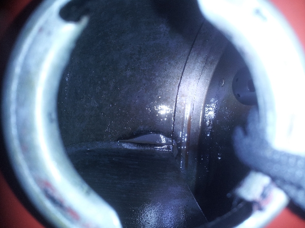

Im new to this forum and hope this is the place to post this. My uncle gave me a 1978 KZ750 Twin with 8,000 miles on it. The paint and body are rust free and it looks great. BUT when I looked in the tank I noticed rust. I tried to post a photo but keep getting a message that says "you do not have permission to view this page."
The bike has sat in a garage for a long time. The rust seems surface because when I stuck my finger in an brushed it, it fell right off into the fuel. It was like liquid. What is the best way to fix this and how long before it gets bad? I dont have a lot of money and dont want the hassle of trying to find a new tank before its too late.

Welcome aboard. The solution depends on how bad things are at the bottom of the tank. That is where water and dirt and chunks of rust will settle.
First, drain the tank and carefully dispose of the old, rotten fuel. Do not try to reuse it.
Then remove the petcock (it will need rebuilding or replacement) and make a metal plate to block off the hole. You can use a piece of an old inner tube or something similar as a temporary seal.
If the rust is not too bad, fill the tank with white vinegar. Put the cap back on and shake the tank vigorously.
Let the tank sit with the vinegar in it overnight.
The next morning, shake it some more.
Repeat this for two or three days.
Carefully drain the old vinegar, paying close attention to what comes out. If it is just mildly discolored, repeat the process again with clean vinegar.
If the vinegar is really dark, or there is noticeable sludge or chunks, a more aggressive approach may be needed.
While this is going on would be a good time to rebuild the petcock, and prepare for rebuilding the carbs. They will need it.
Once all the parts of the fuel system are clean, reinstall them with some new fuel lines and put some fresh fuel in the tank, then adjust the carbs.

So the rust in it is really the beginnings for rust, not pitted junky flaky stuff. He said he made the mistake of letting it flash rust, whatever all that is. Im still happy to have the bike, I just dont want it to rust. Will Drygas stop the rust? Something like HEET?

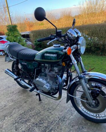

Darn! I put a half bottle of Heet in it. Oh well. I'll do the vinegar and WD40 thing then. Would any lingering WD40 mess up the fuel lines or carbs when it flows through the system?
Here is the bike
Here is the bike

Nice looking bike ! If it's been sitting for awhile a good cleaning of the tank with vinegar should be done it might surprise you what comes out and save you from future problems.
